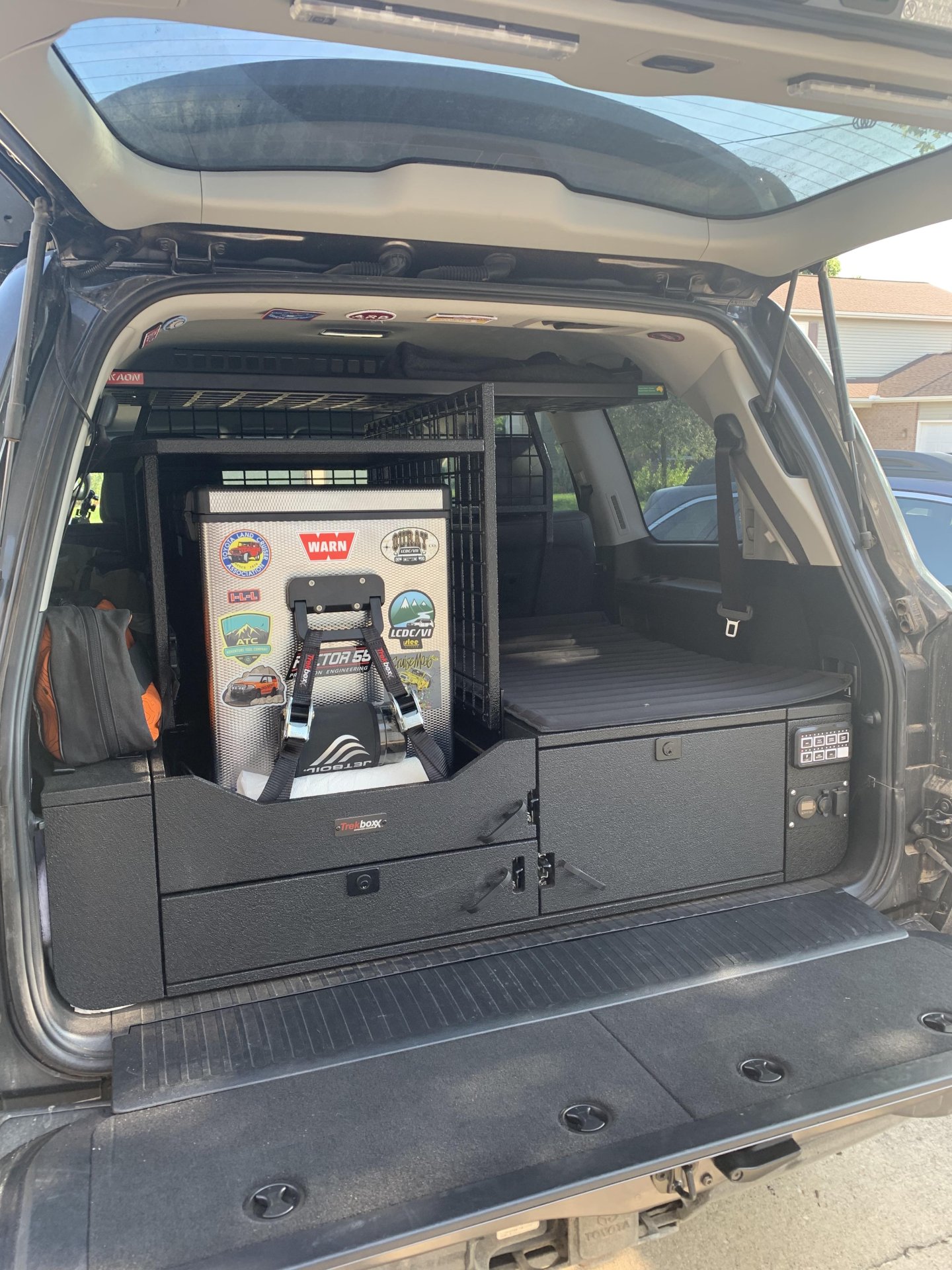

I have the spod switch panel on my rear box setup. There is no modifications needed for the spod. I use it for my rear hatch lights and various usb and 12v jack in the back. I have my rear dust lights also hooked up to the spod and use the Linx to control them. My dust lights have a hi low setting. I have two switches on the linx, one for low and one for hi. I have them setup so that when I hit my brakes, it will switch from Low to Hi. I also have one of the triggers from the LINX going to a relay which will turn my Ham radio on and off when I turn the truck on and off.
