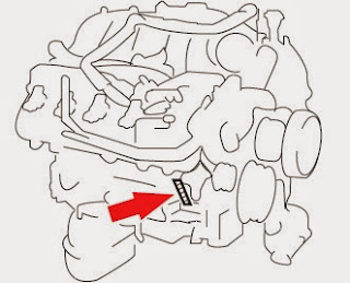

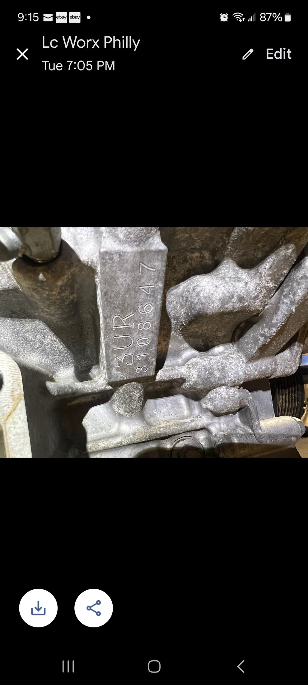

Question for you. Did you look for a vin marking on your donor engine? I'm trying to verify my donor engine to what was stated and I can't find a vin on the engine to match with the lx570 it came from. Thanks
The serial number can be found here:
Should start 3UR, followed by "-" and then the plant code (1-9), then a 6 digit serial number.
There was nothing. We looked for a VIN on the engine. The yard that had the engine did not have the LX570 it came out of. Mine had a picture of the donor's odometer. I still wanted the VIN to look up maintenance history etc but we came up empty. I had to just trust the yard and my shop's inspection of the engine upon receipt. I'm going on two weeks and so far all is good.

I solved the riddle. The engraved numbers on the front of the block are a serial number. Using my program here at work (I'm a parts guy at a toyota dealer). Once I put the vin in my program it shows a number next to the 3ur code. In this way I was able to match that number to the vin. Here's what I came up with.
For this to work you have to have the vin first. I was fortunate to have the vin and the engraved numbers. If you ever find the vin let me know I can run it for you
