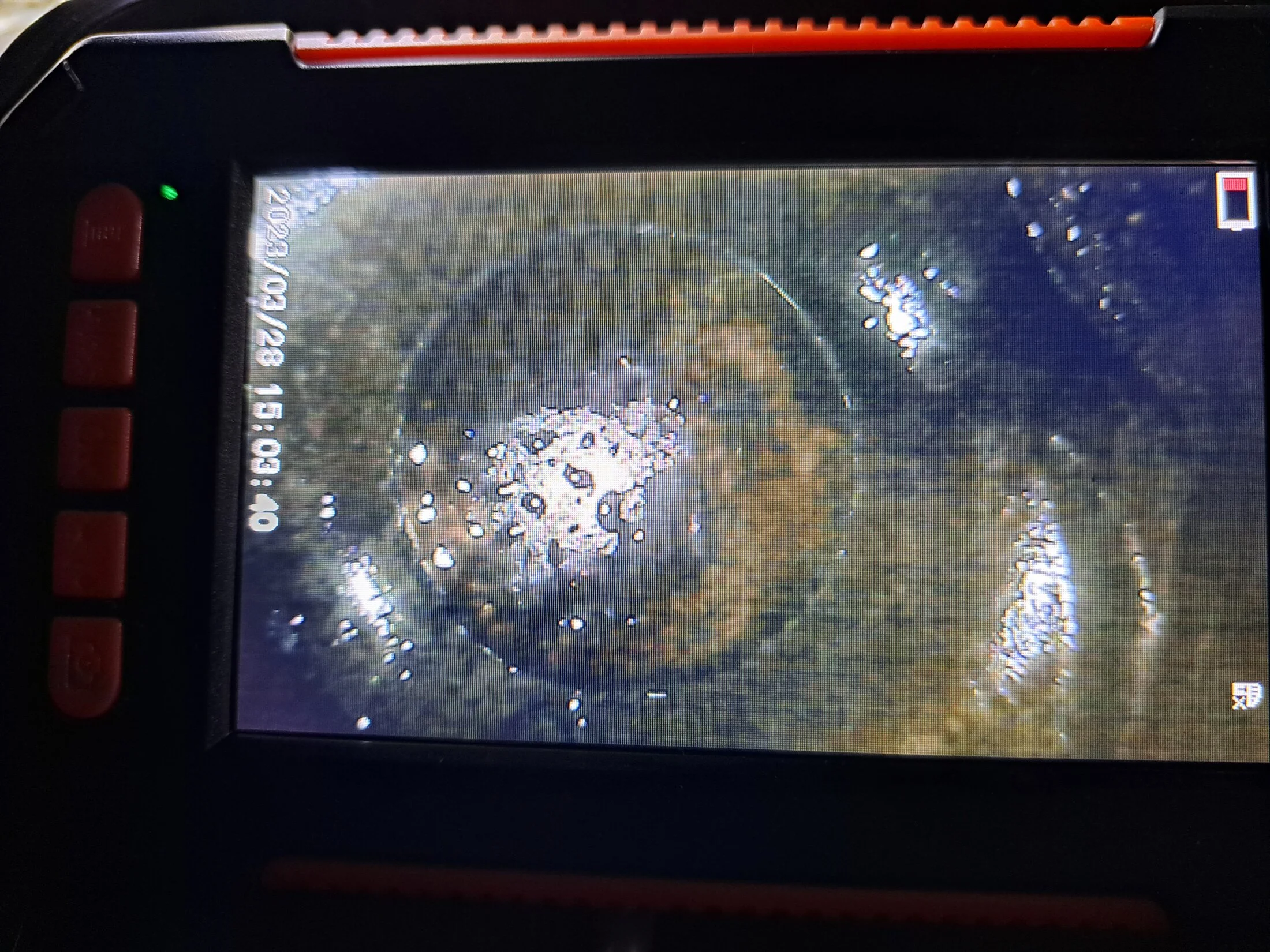

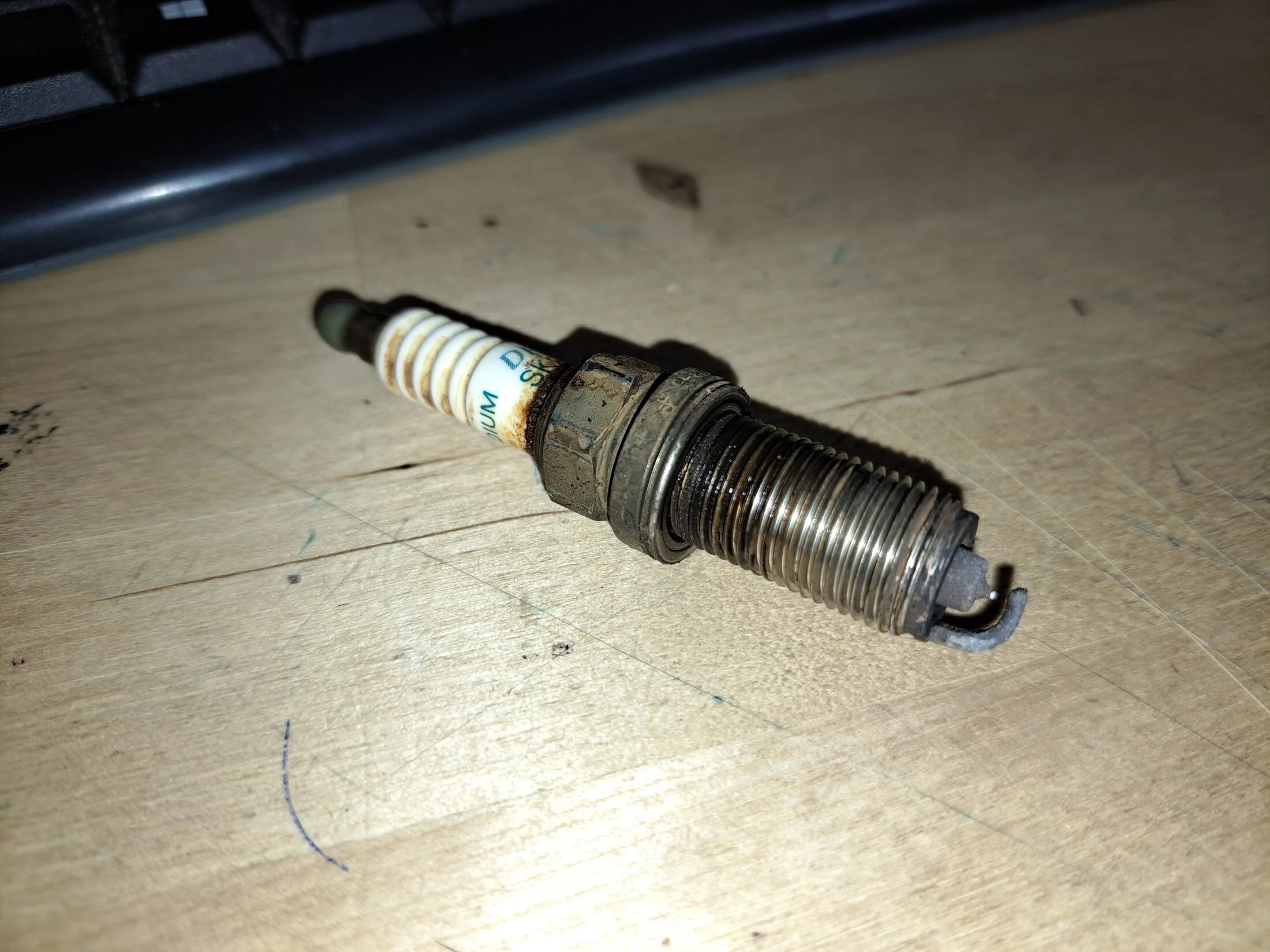

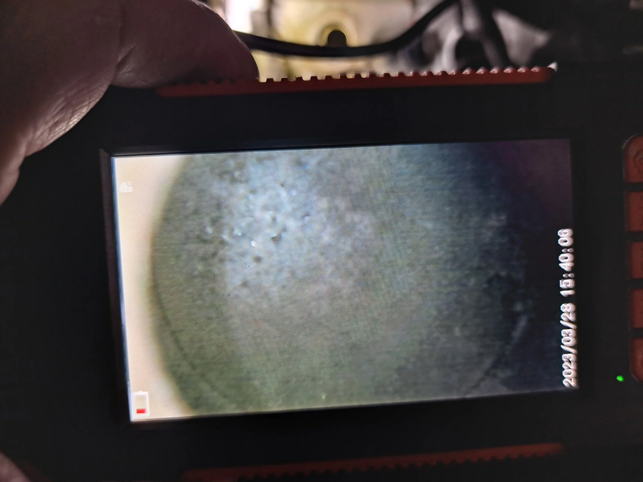

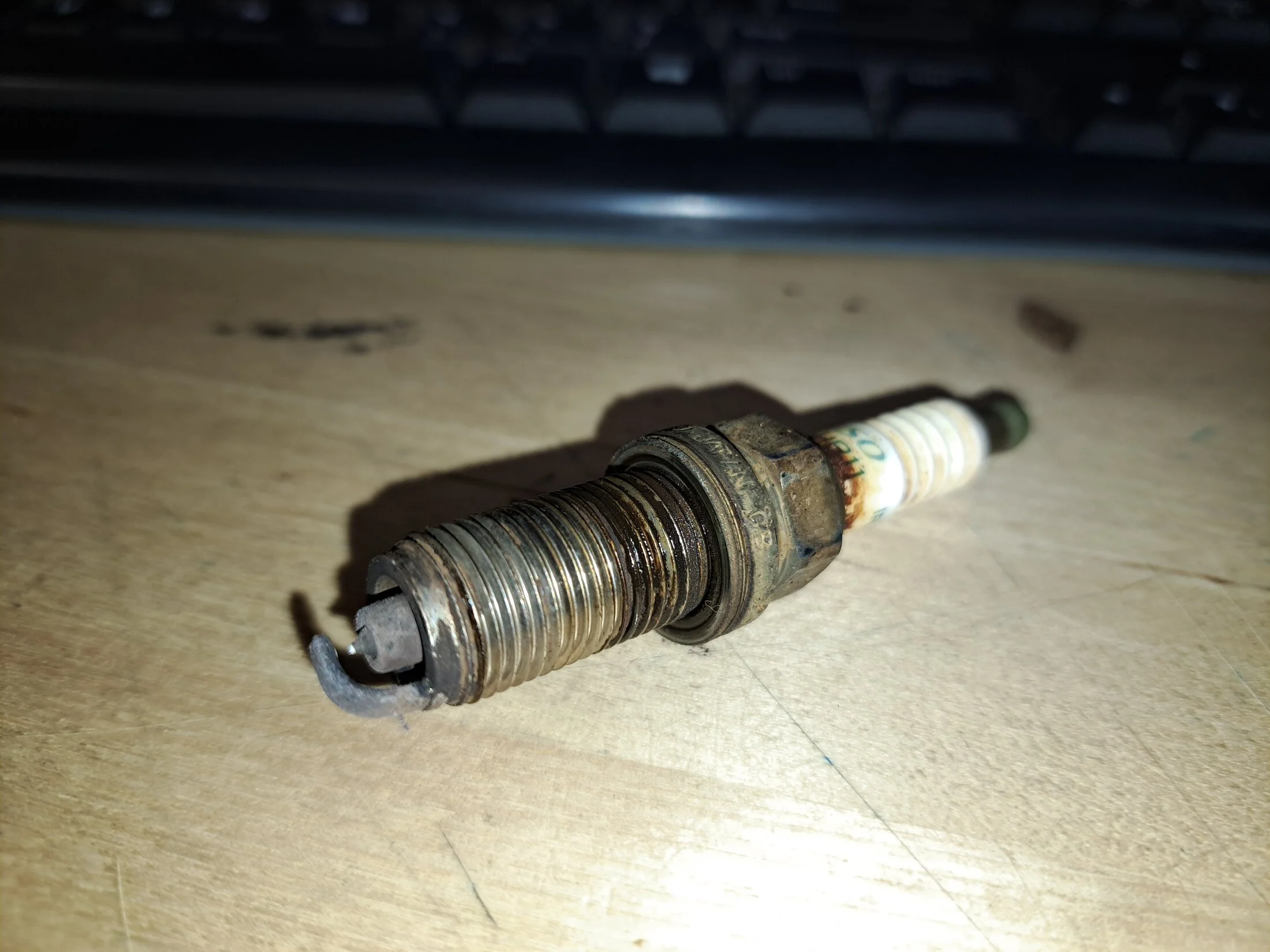

Ok so I pulled cylinder 4 spark plug out (had about 100 miles on it). Found wetness on porcelain and a black patch of something. Put my endoscope down the spark plug hole and was greeted with a very wet piston top and cylinder walls. I'm leaning towards the wetness being oil instead of coolant. For comparison I pulled the cylinder 2 spark plug out and it looked as expected for 115k mile spark plug with none of the blackness I found on the cylinder 4 plug (when I pulled the 115k mile plug from cylinder 4 it was very black with no light coloring on the porcelain. I scoped cylinder 2 and it's almost completely dry maybe a couple spots of liquid (assuming oil). The only codes I ever got were p0304 for cylinder 4. Only happens after it sits a few hours. No idea what to do. I found a 45k mile engine on ebay for 6k. Might go this route? I don't want to pay bunch in teardown to find the issue only to lead to engine replacement. Thoughts. Suggestions? First 2 pics are cylinder 4 plug with 100 miles on it. Followed by cylinder 4, cylinder 2 spark plug with 115k then picture of cylinder 2
