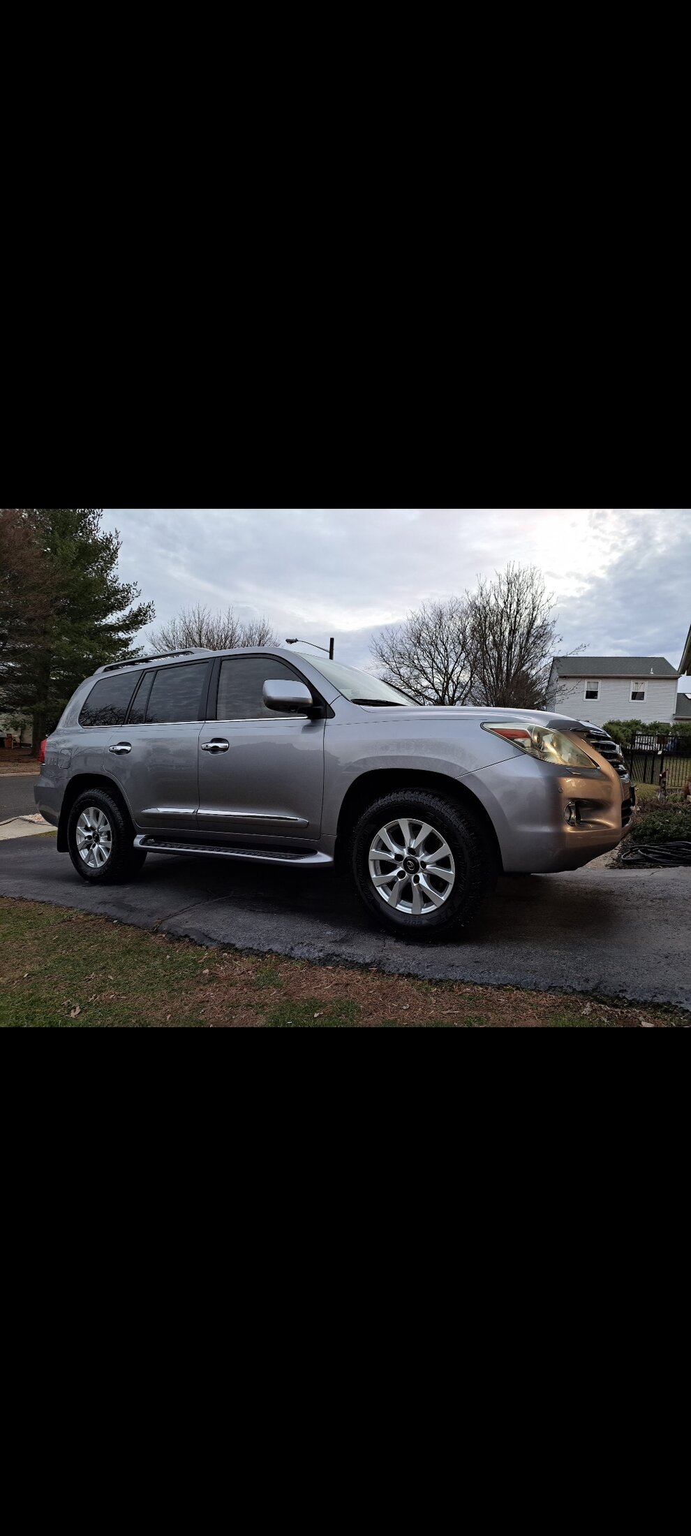

2010 lx570 code po 304 UPDATE #2

I am in a similar situation with my 200. Valve spring failure, valve dropped = carnage. Donor engine going in now. Actually the donor is in and shop is now buttoning things up. It wasn't an easy decision to make. However my 200 is super clean and she was worth saving. My engine had 167k miles on it. Donor has 70k miles on it. I feel your pain man. Do the math though. In my case, it made sense to do an engine swap.
