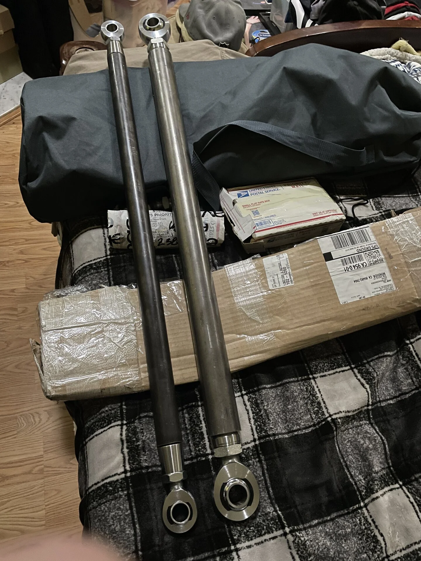

Whats up with Enduro joints ? I got them for frame side of 4 link , dam things are 2 & 5/16 NOT 2 & 5/8 as the brackets are.
You Did get 1 1/4 correct. the only 2 5/16 are 7/8.
Not for the uppers, 1.5 tube , 1/4 wall , 7/8 shank , 9/16 bolt. Not a huge issue just suprised as the 7/8 also come in 2.625 mounting width I just didnt catch the 2 & 5/16.
I am thinking the uppers need a 3 hole weld washer but it make the nut pocket really tight. May not be nec.
The lowers are all 1.25 with 3/4 bolts, the axle end of uppers are 7/8 hiems with 3/4 bolts. All the lowers & axle end uppers will get weld washers.
Did you get long enough bolts to have shank catch both brackets & if so did you trim/cut off the threaded end for the upper nut pocket ?
Danger, thats what I was planning as they sent 4 9/16 weld washers and all my others are 3/4 bolt & cant use em on the adjustable upper so they work perfect for that. I am looking for or will make a 3 hole weld washer for uppers to help keep that 9/16 bolt from bending or do you think that not nec on the upper ?
All my link ends are 1 1/4. with 5/8 bolts. my upper links are 2 inch and lowers are 2 1/4 All Aluminum .
So you did not add anything to the adjustable upper, just drilled out to 5/8 ?

Correct just drilled for 5/8 . Now you understand why i pulled the Tub off on Blue build . You have 2.5 months to get it done. Get after it !!!

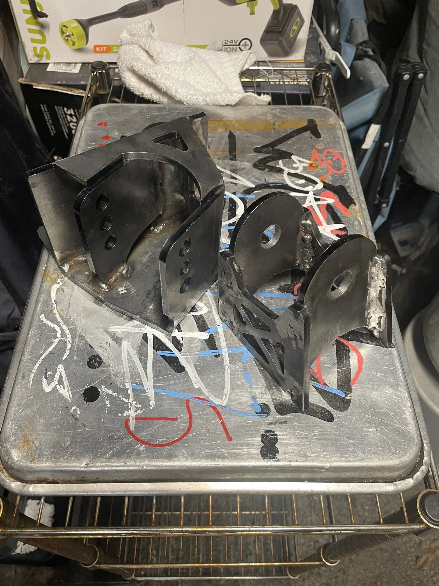

When there is anything not embarassing I will post up, so far it's a pile of parts, got one bracket done & need to finish weld it, spent some time working out details, I think projects thru to a miserable detail level, dont hav ethe $ to make them look like they do in my mind but I'll dang sure try.
I'll start the build pics once its up on stands and cleaned up ready to weld, that way people can see start to finish.
