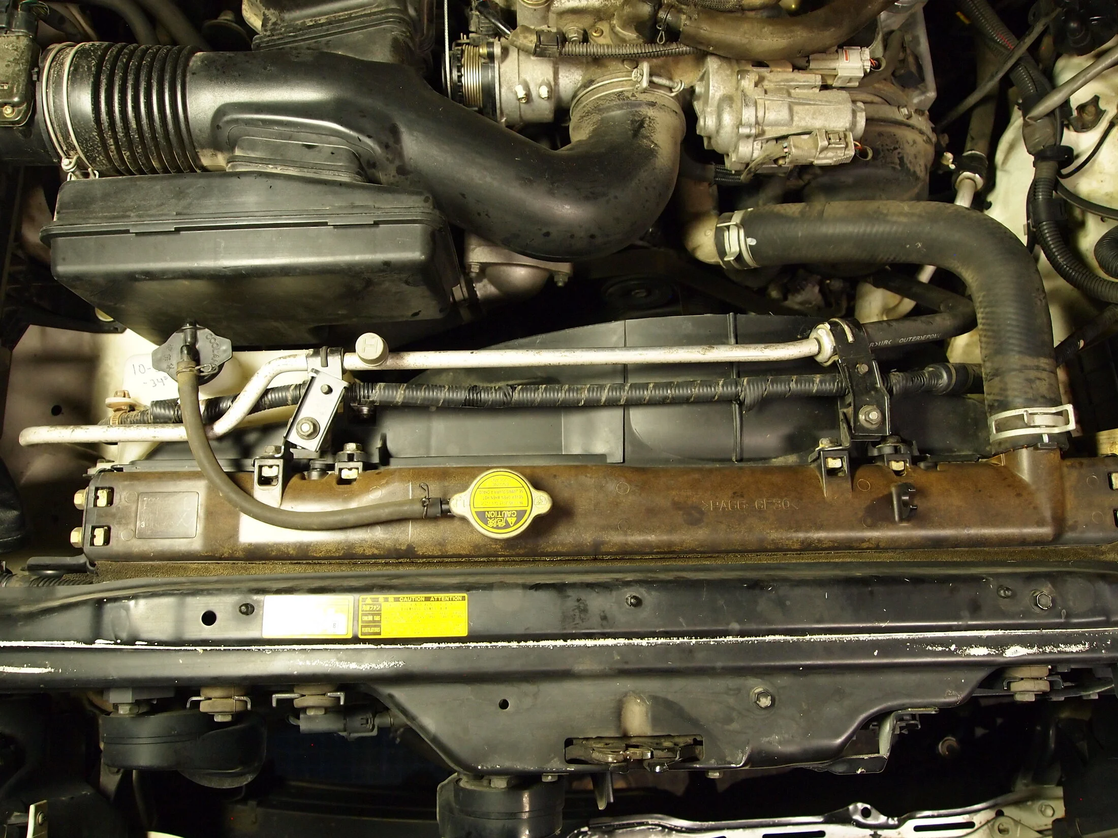

Radiator plastic tops crack, bad old Heater tees and water pipe:
As plastic ages and dries, which any air in coolant system speed up the aging. The black plastics turns brown. If radiator cap stuck closed, system can't release pressure created by heating coolant. Excessive pressure above ~15PSI, finds a way out. To often that is, by blow out weaken plastic.
Old brown top, near end of life.
Bad plastic heater tees.
Just a lite pull on hot side, breaks them. lifting engine, pulls on them.

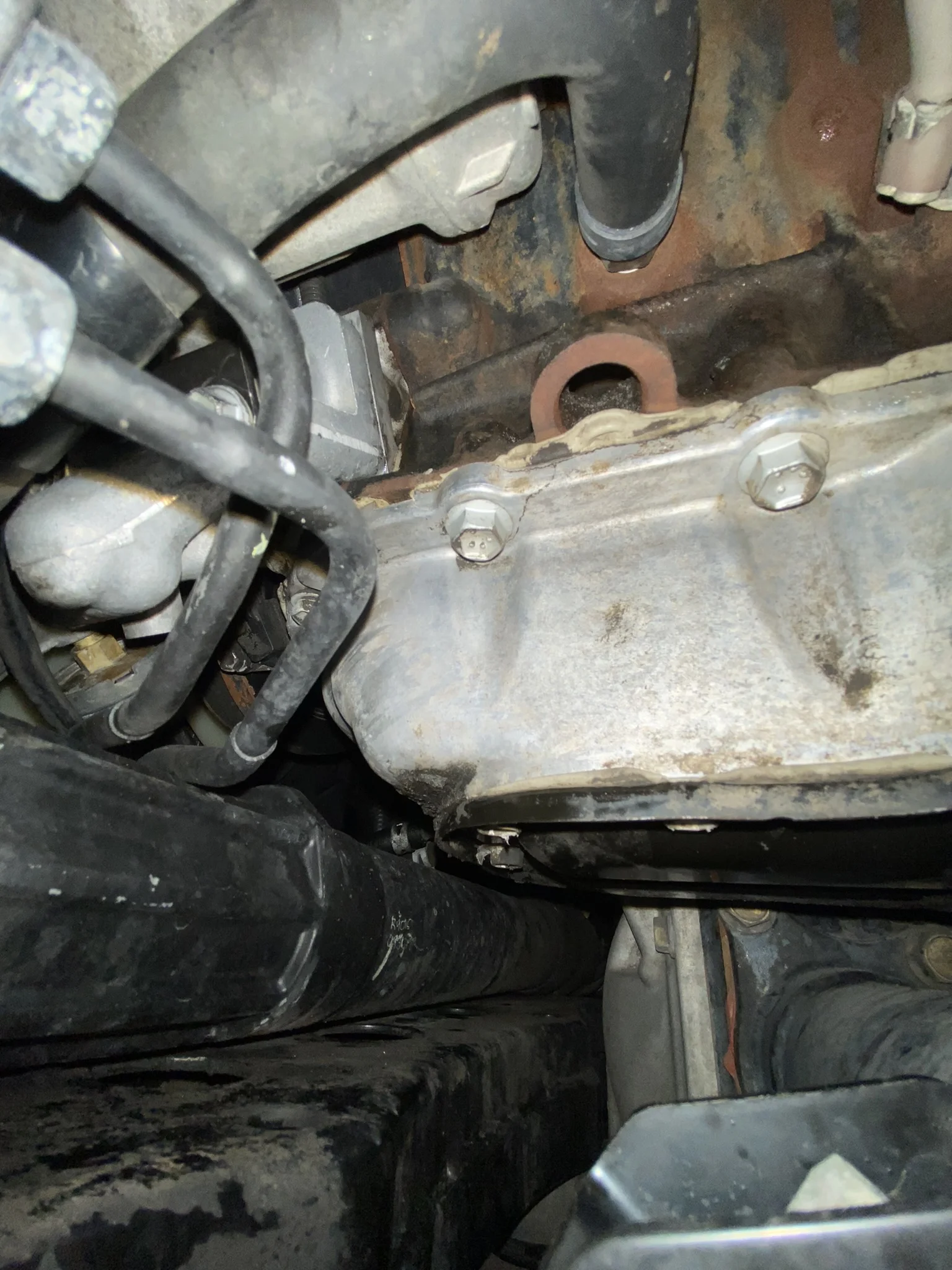

Water hose from block to oil cooler

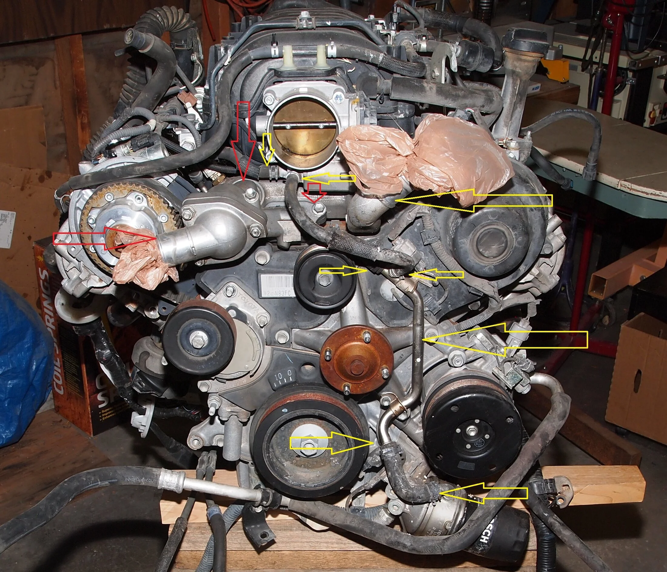

Water pipe & hose from oil cooler:
Yellow arrows point to water pipe & hose
