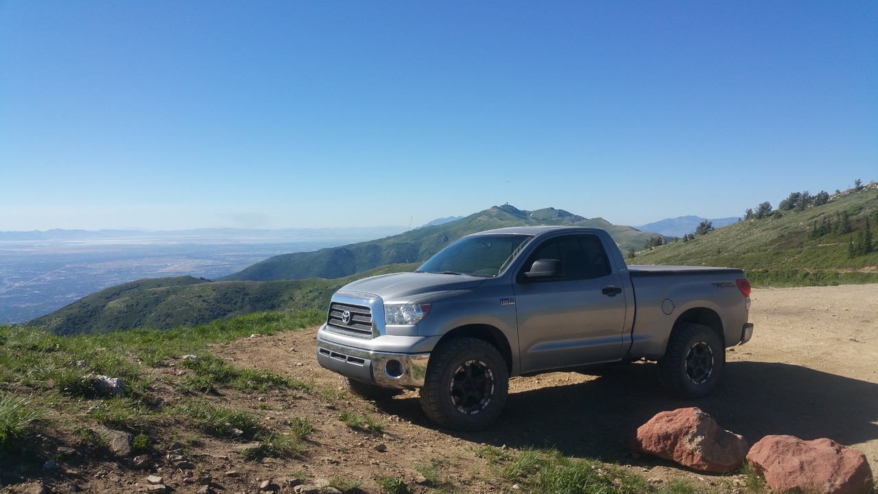

I have 35s on my '07 RCSB. It's only leveled, with some cheapo MB Wheels in lower than stock offset. It rubbed on the plastic in the front of the front wheels (front bumper trim). It also rubs a tiny but on the body mounts on the front. A body chop mod is pretty popular.
That's a nice looking truck TonyP. When it is rubbing a tiny bit on the body mount is that in full flex?
The body mount rubbing is in the rear of the front wheels. I have the truck at full flex (front and rear) frequently on the trails and didn't notice an increase rubbing at that spot. The stock castor angle seems to work out in this situation.
Of course I could just trim and fill the body mount, or just cut it for clearance. But laziness wins and it doesn't bother me or that much and it doesn't damage the tires at all.
