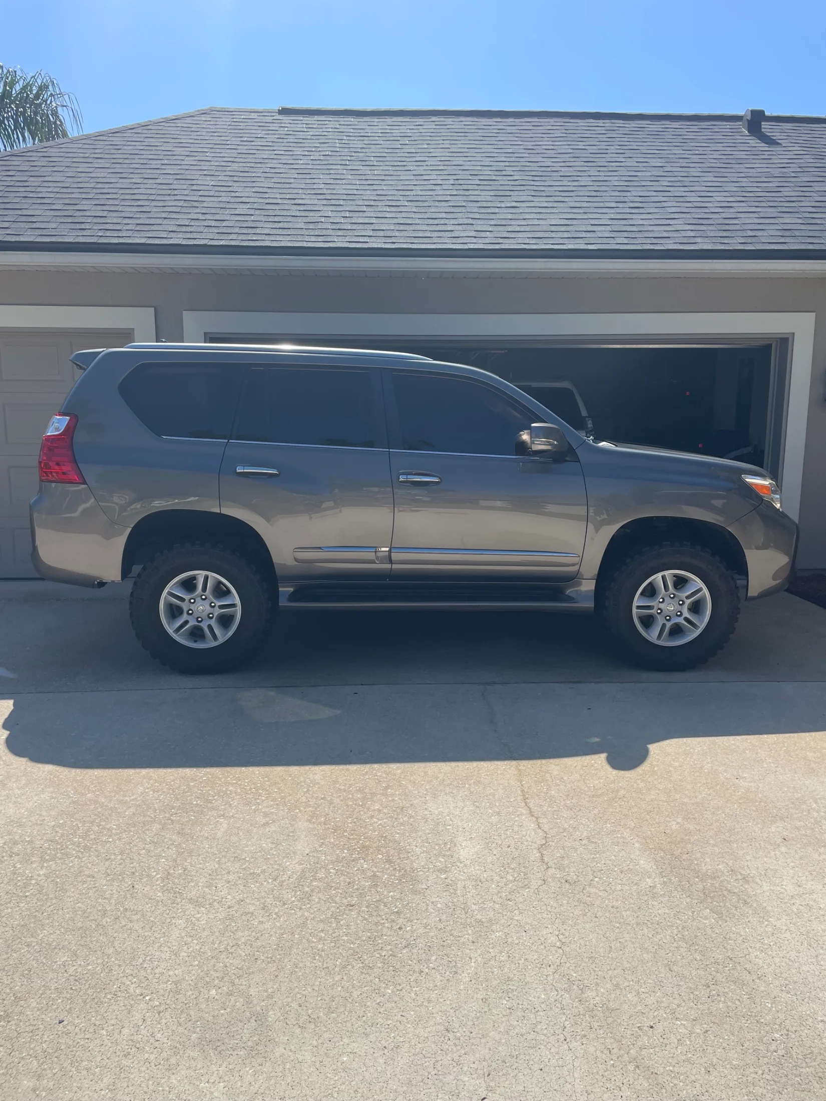

It was a little bit of a simpler ordering process when I got mine 3 or so years ago, they didn’t have all the options. I went with the medium weight which at the time was around 100 lbs. due to a sleeping platform/drawer system I built. Mine definitely still has a little rake. Pic for reference.
