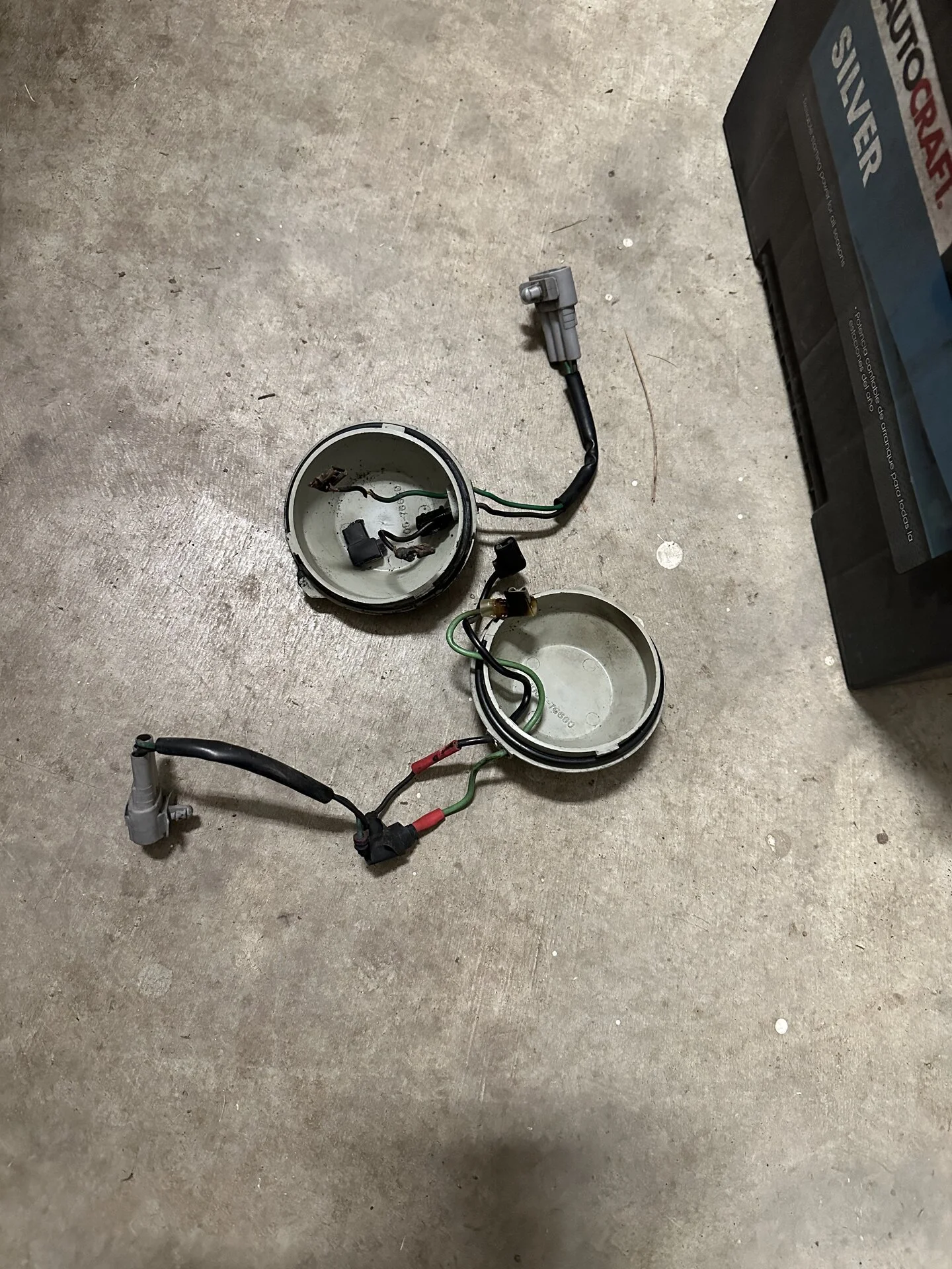

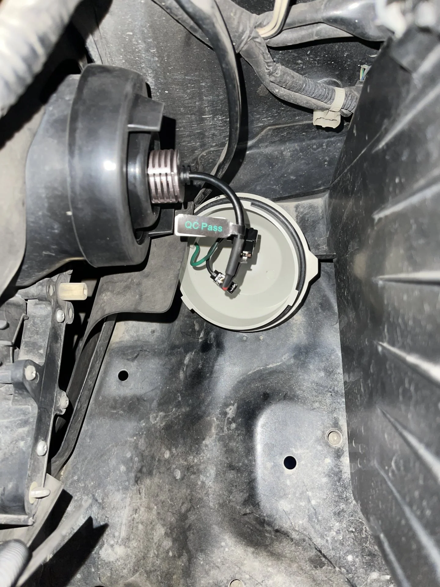

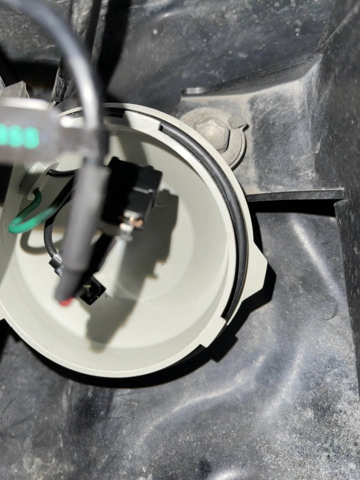

Connection of the new bulbs are plugged into the socket that are sticking out of the oem dust covers. I will take a photo and share it once I go home.
So did you just leave the OEM dust covers laying where they were in the video? No biggie, just wondering. What bulbs did you get?
I left the oem dust cover laying there because I didn’t want to cut the wires that go through tiny holes in the oem dust cover, otherwise I had solder those back. I got lasfit H1 bulbs for 25 dollars a set of two from eBay.
