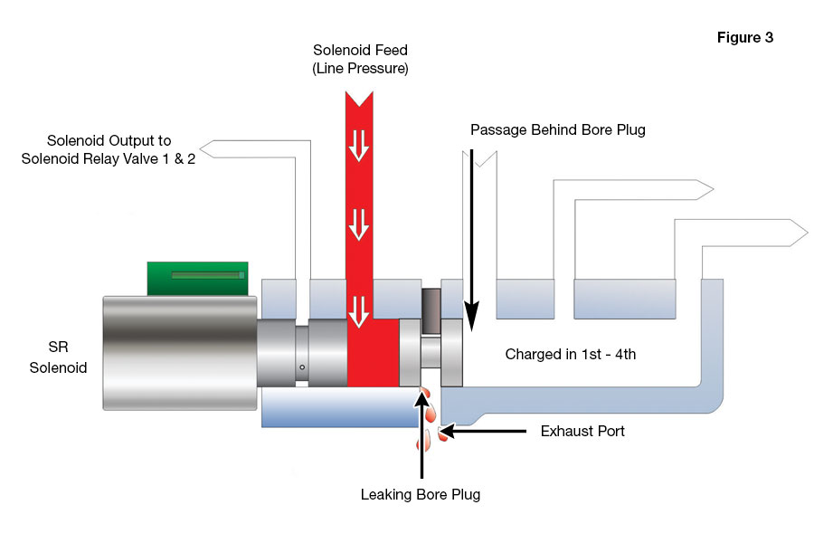

The significance of the unusual feed system is where our problem lies, because there is another On-Off solenoid connected to same oil circuit feeding the solenoids: the SR solenoid. This particular solenoid does not have a performance code connected to it to aid in diagnosis. The fact of the matter is that the trouble codes listed above really are of no help other than pointing us to the solenoids. The actual problem is deeper…it is the solenoid feed.

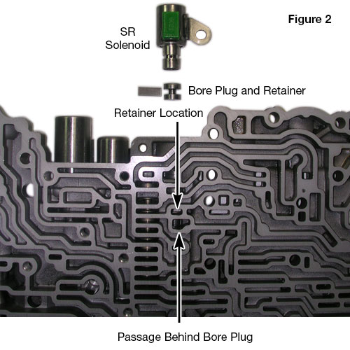

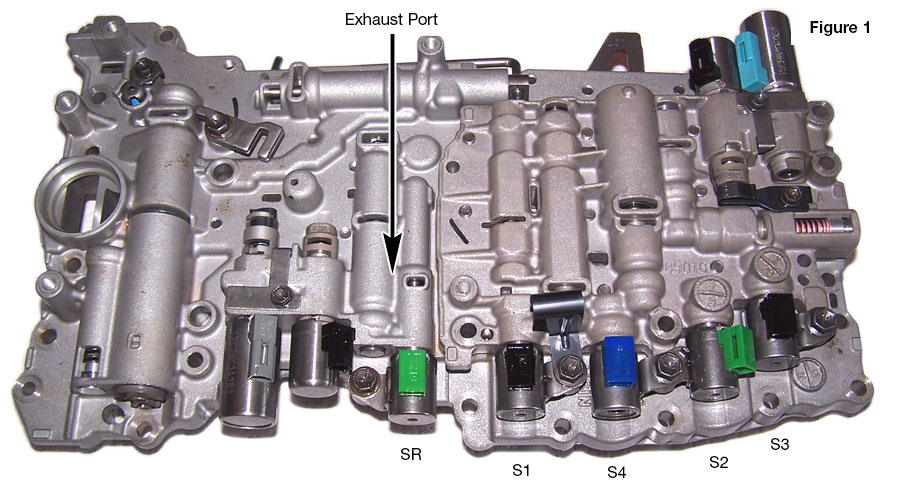

Figure 1 shows the locations of S1, S2, S3, S4 and the SR solenoid where you can see an exhaust port deeper in the bore from the SR solenoid. This port is directly below the retainer pocket for the bore plug located behind the SR solenoid (Figure 2 shows the OE bore plug and retainer removed from the valve body).
This bore plug separates solenoid feed (line pressure) and a circuit that is charged in first through fourth gears (Figure 3).

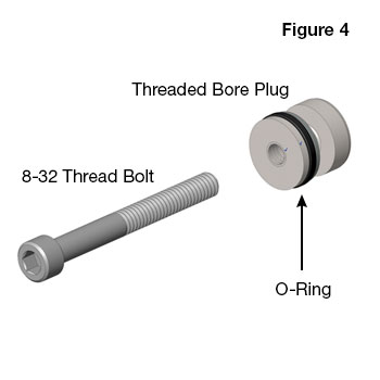

This problem area was discovered by Jeff Parlee, director of product support at Valve Body Xpress, and it was easy to see when run on the valve body test machine. As soon as the line pressure circuit was charged, oil started dumping out of the exhaust port. It was one of those “that can’t be right!” moments, and of course it is not right. Not every shop out there has a valve body test machine, so this problem can be missed very easily. A good repair for this area is an O-ringed bore plug that is threaded so it can be installed down into the bore with ease (Figure 4). The O-ring prevents solenoid feed (which we know now is line pressure) from leaking into the sump. This leak not only causes low solenoid feed, but also low line pressure that we all know is not good.
Removing the OE bore plug is where the challenge lies. Figure 5 shows the location of the retainer for this bore plug. A large paper clip and needle nose pliers can help push this bore plug out of its location starting at the exhaust port and/or the passage behind it (Figures 2 and 3). By the way, this is the one that always falls out of the casting when cleaning it, as there is no valve or spring that lives here to keep pressure on it.

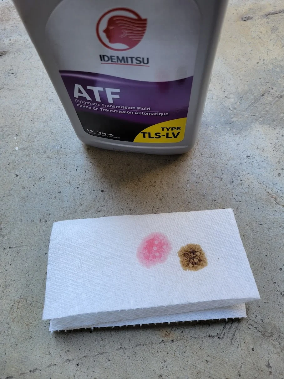

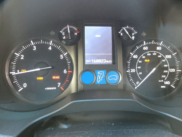

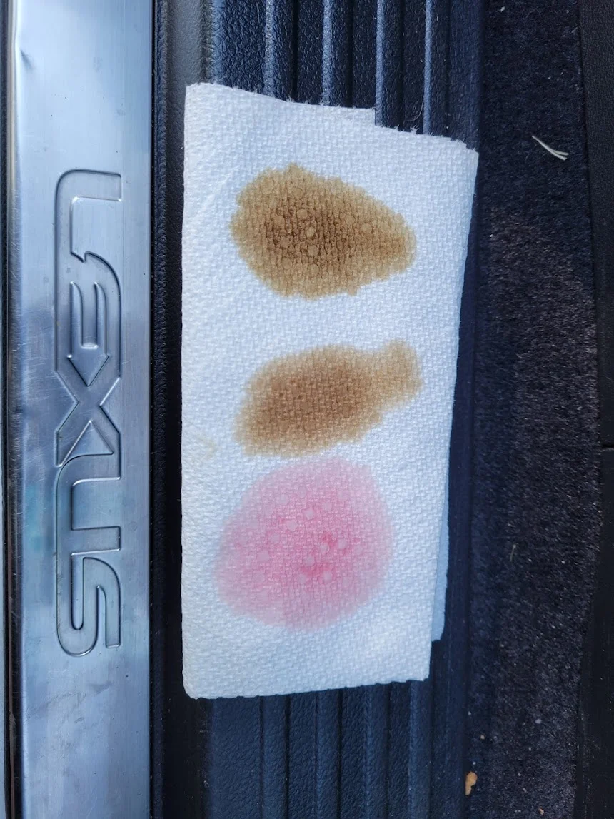

Sorry for the old thread resurrection... but I got a P2714 on our 2011 GX460 with 160k and thought I would share some info here
I didn't have ANY issues initially with operability just the P2714 CEL (and all the accompanying lights: VSC, 4Lo, etc.) I decided to change the fluid and found it was BLACK. I ended up changing it 3 or 4 times with short jaunts around the neighborhood in-between. The light went out on my last test drive and it was running as good as it ever had.
About two weeks later the light came back on and it started shifting horribly. This time I had multiple codes (P0766, P0776, P0983 along with P2714). I've been researching for a little while but couldn't find a lot of info so I took it to a reputable transmission shop. After testing, I was told that he suspected the valve body was bad but when he pulled the pan they found metal in the bottom. He started researching parts availability and isn't having any luck finding Lexus parts or an entire transmission in stock. If he ordered the transmission, I'd be 91 on the waiting list. He said he would start looking at non-OEM options but I'm not sure that's what I want to do.
Hope to have some more info soon but this is turning out to be a real bummer
