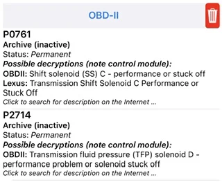

Ugh. My mechanic (of 20 years) just scanned my son's 2011 GX 460 and it's throwing P0761 and P2114. He said it needs to go to a transmission shop (ugh again). Just reviving this thread to see if anyone has seen these two codes. My searches (here and on the google) don't show much. Thanks in advance, fellas.

Actually P0761 and P2714. Everything I've read indicates it needs a new transmission. Disappointing. I really think the "lifetime transmission" is questionable at best. I imagine if we flushed every 60K we wouldn't be seeing these issues.

Here is P2714 info

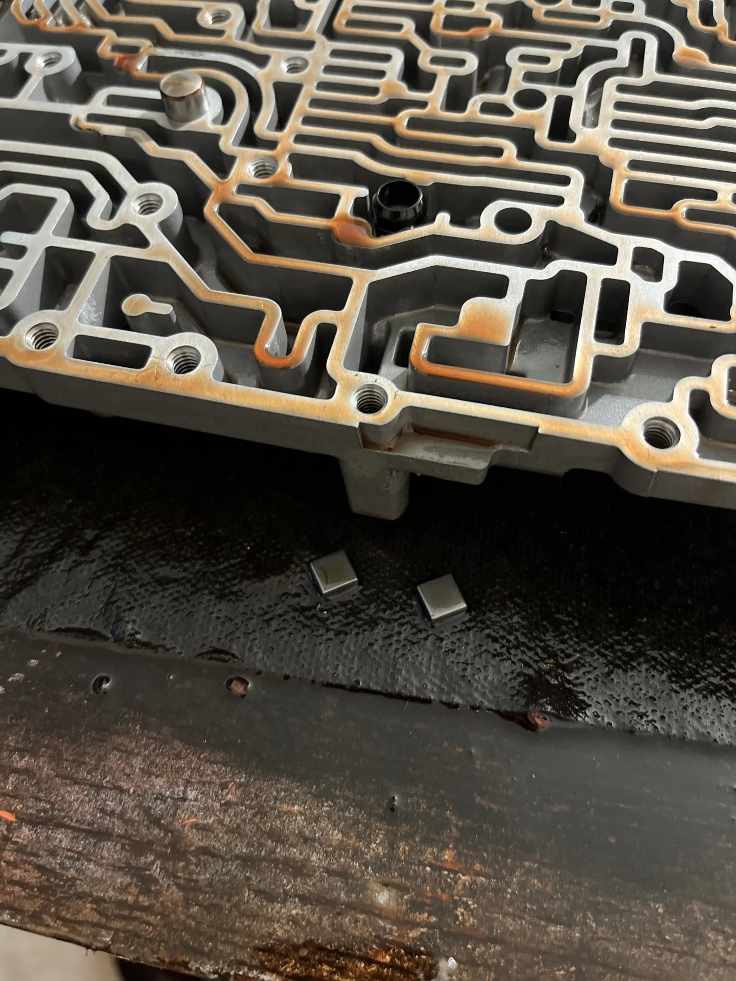

So, I had the same issue. Tried to do the end plug fix tonight. Everything was going well until I went to put the valve body back together and noticed these two random squares sitting in the table. No idea where they go and obviously don’t want to put it back in with them out. Anybody have any actual experience with valve bodies?

I wish I was smart enough to answer. Looks like spacers o some sort.... Did you figure it out?

Yeah, I finally found a diagram online and found where they go. Also, the original problem was not fixed, and I ended up getting a full trans replacement. It sucked, but I'm also not sure one data point is enough to disqualify the end-plug fix as a solution.
