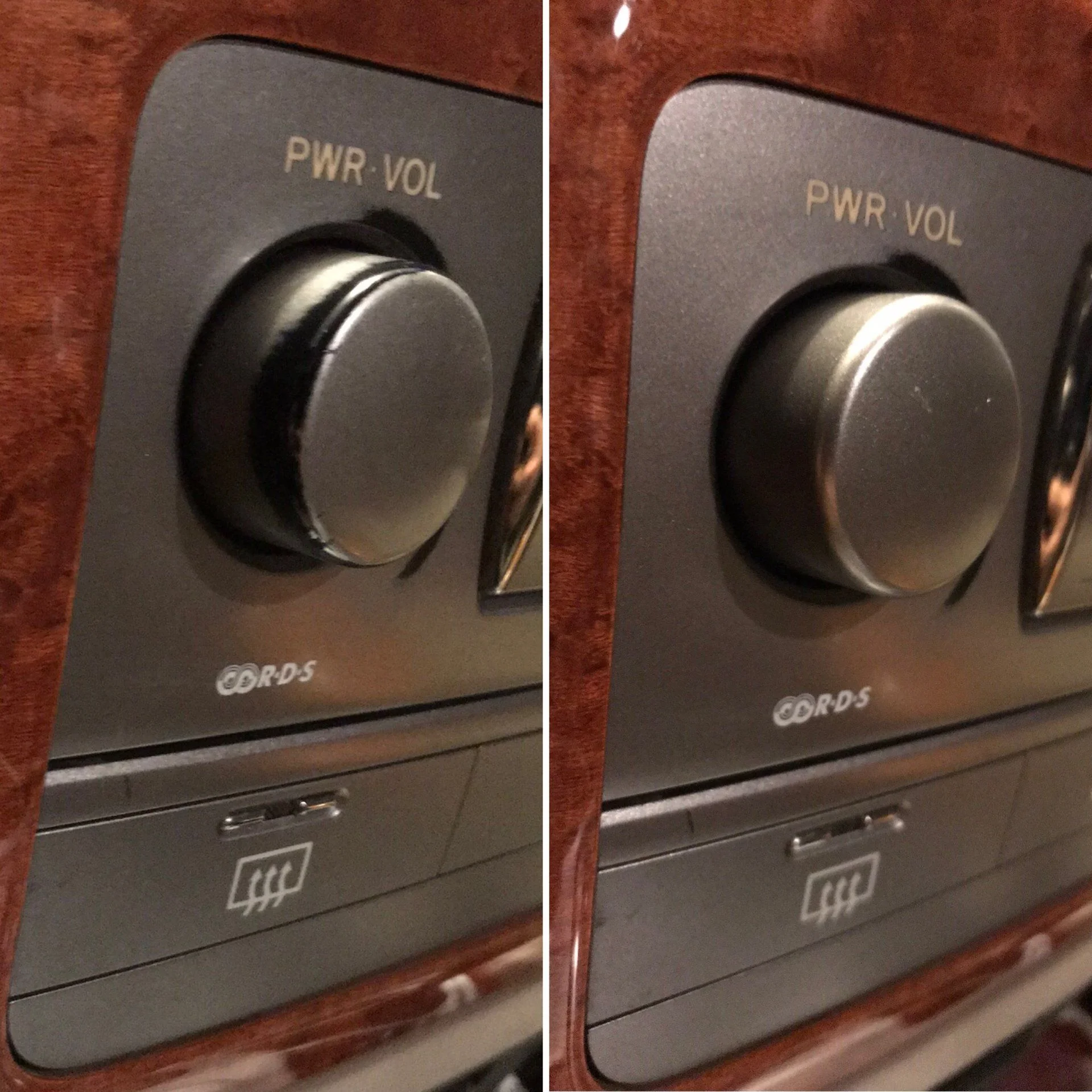

Thanks for the carpet/ vent tip. Fixed!

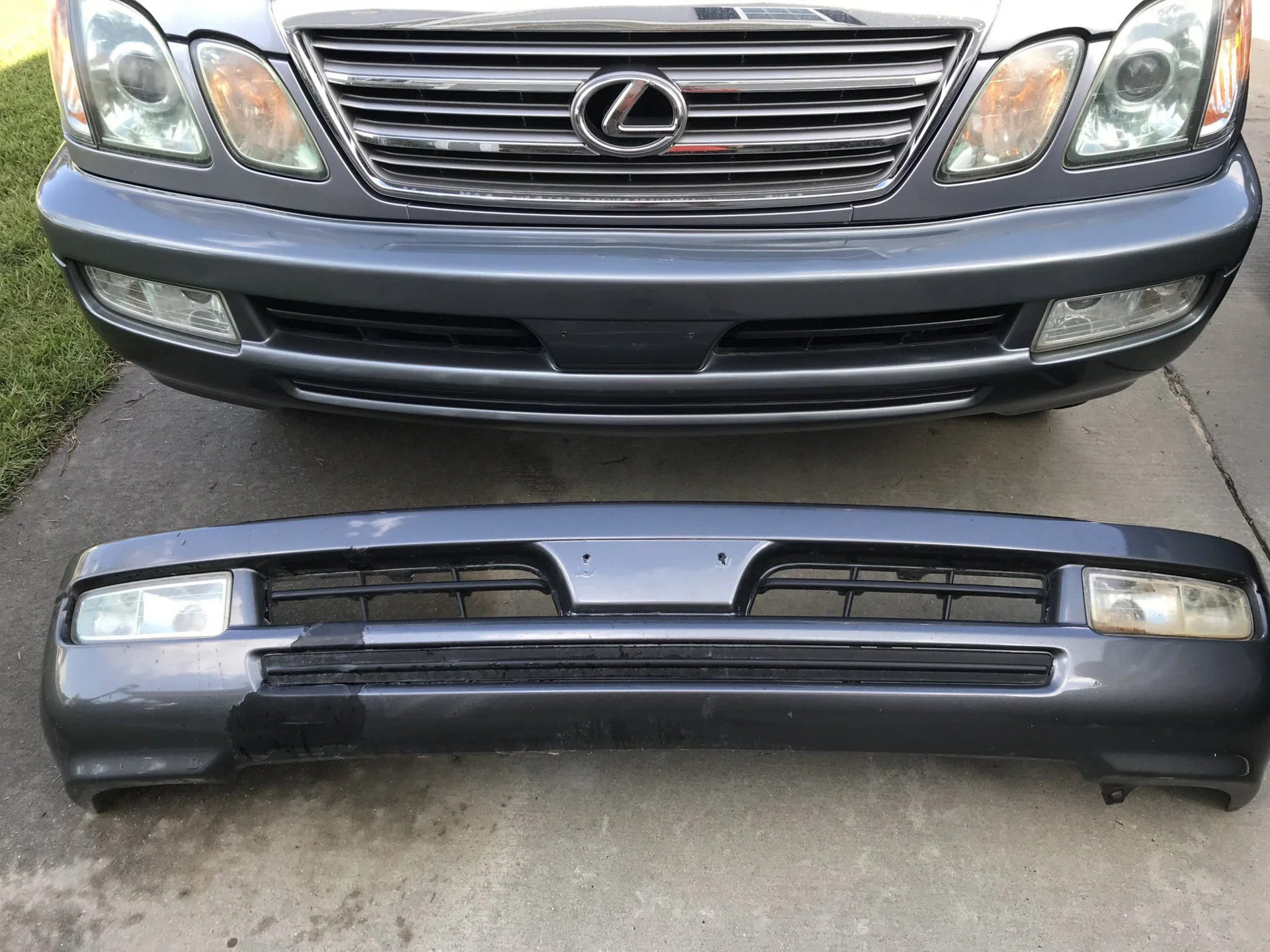

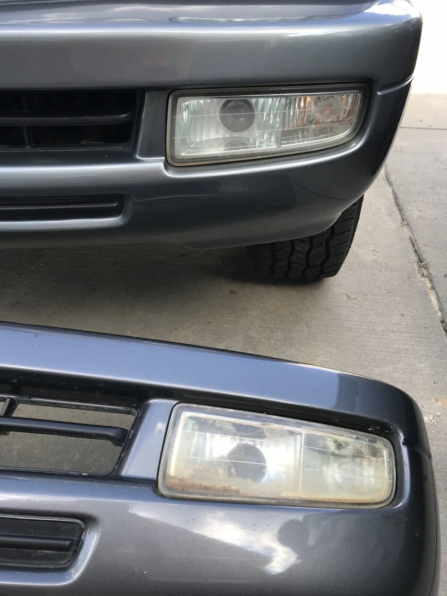

Since it's been a while, and I've ordered parts from two awesome guys here on Mud, here's my latest update on Lexie...
Thanks @Raj Singh for hooking me up with the bumper! Awesome guy to work with.

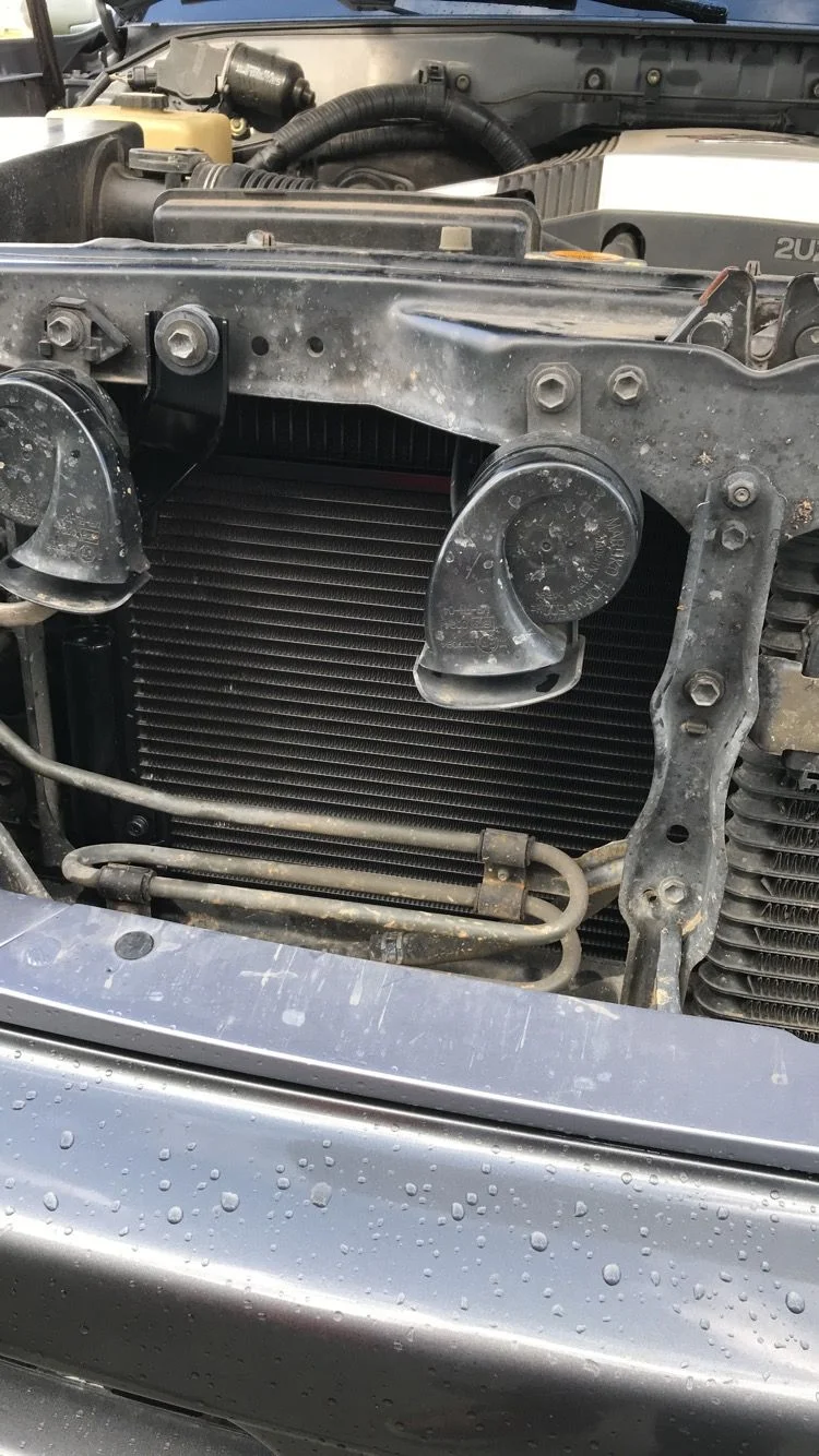

I KNOW, y'all are having a spasm at hooking up a garden hose to the cooling system, but it was in there for maybe 30 seconds, and was immediately flushed with a gallon of coolant. She's withstood much worse abuse :rolleyes:
By the way, I used this video from ChrisFix to flush it. Awesome step by step video for novice wrenchers like me.

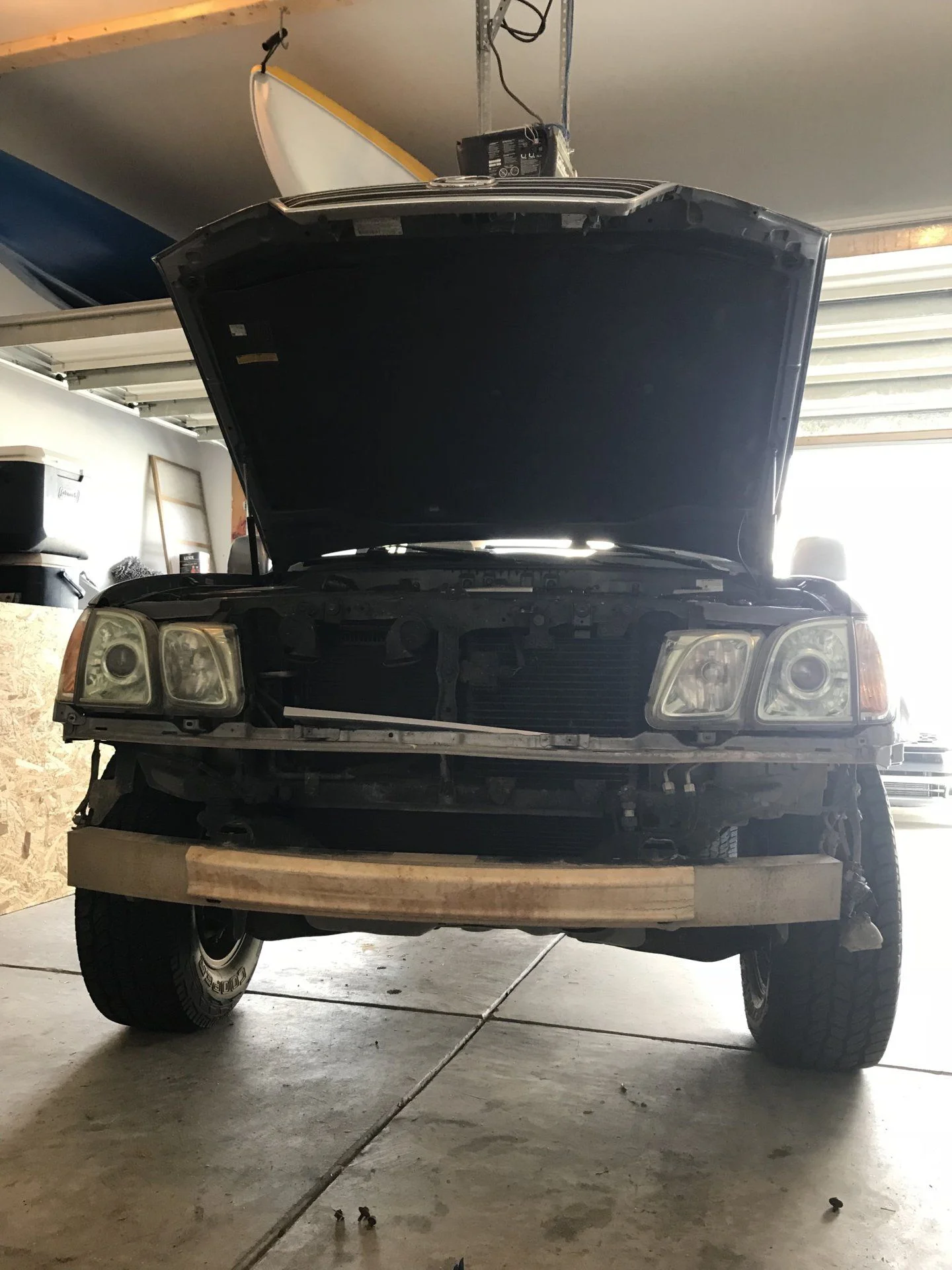

Thanks @CloudCity for the grille! Another awesome Mudder to work with if y'all get the chance!

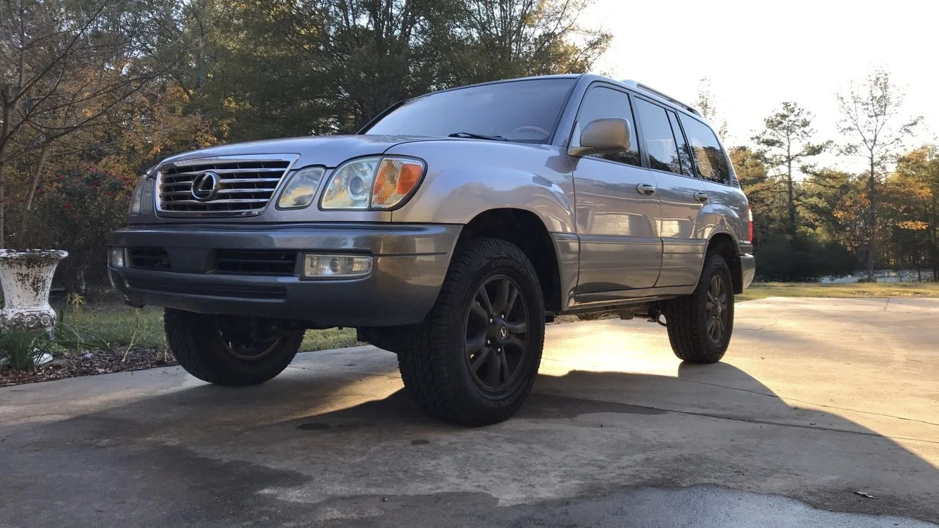

I thought the 2002 & 2007 grills couldn’t work without modifying the surrounds.... so it just bolted up with ZERO modifications and it sits flush with fit/finish oem?
