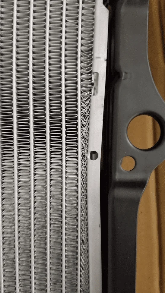

I just pulled the TYC out of the box. Box is undamaged but both sides look like this. Should I send it back?
A lot of them come like that, including one I got cheap from Amazon because it had been returned. It doesn't affect anything. I'm pretty sure it happens along their assembly line because I've seen or heard about it so often. I wouldn't return it, but you do you.

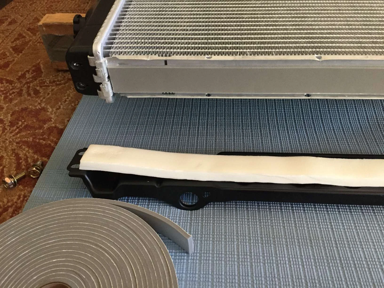

FWIW I take the side brackets off and put foam in that space, as well as sealing the whole thing to the core support.
Already shipped back to Rockauto. Thanks for the suggestions. I have some nice 3/4" D shaped gasket that I plan on using around the radiator.

My TYC 1918 came with the fins slightly crushed on one side, much like that in @lumbee1 photo, but a bit less than that. I judged it to be more of an esthetic issue than performance or reliability, so I shrugged it off and installed anyway - been running that way for a couple of years now - no problems. It's been an extra hot summer season this year, even for Phoenix, with many 113-117F days 🥵 driving around town with A/C on - typically see 193-195F coolant temp.

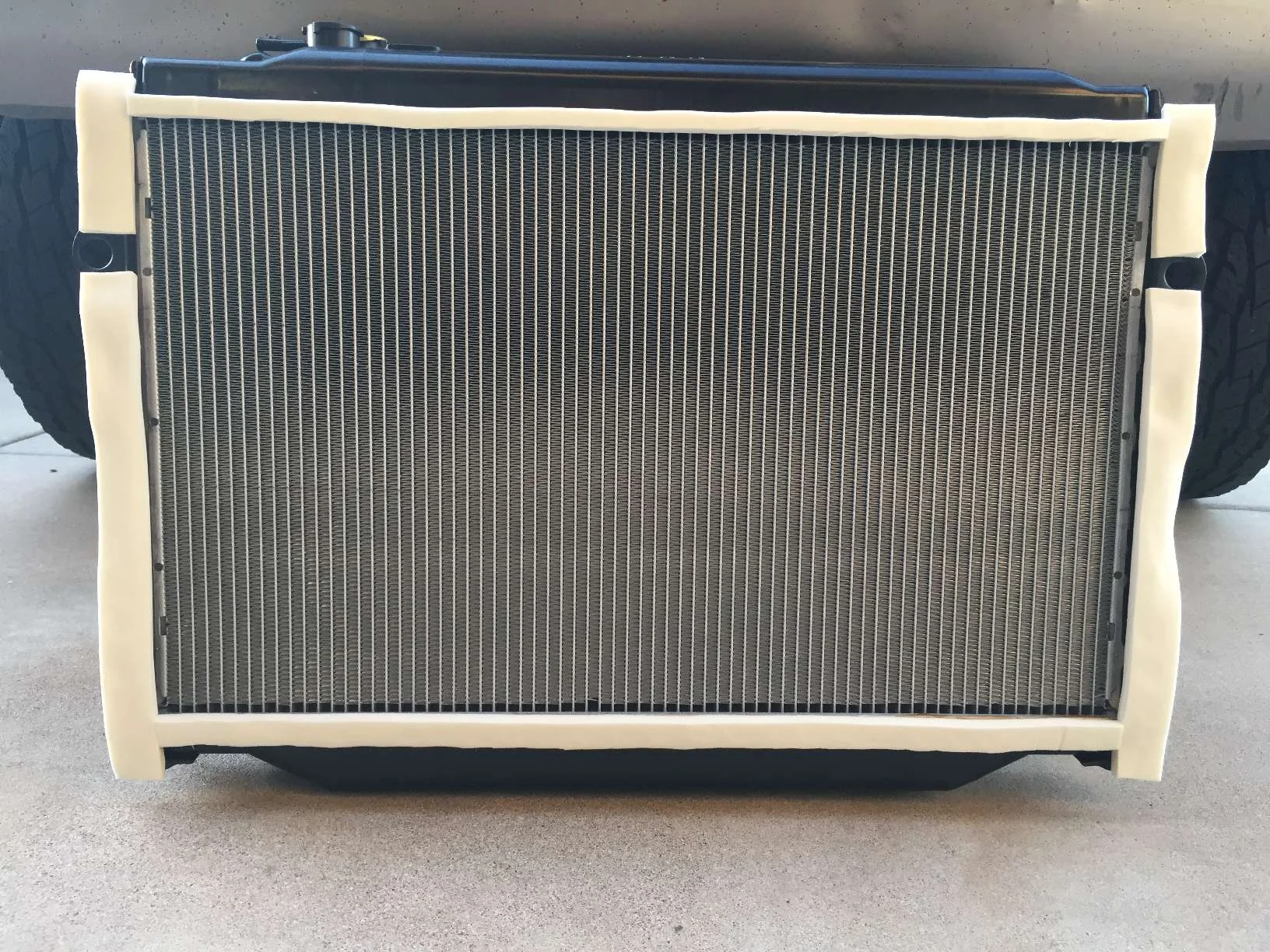

I used contact cement to install soft white EVA weatherstripping to the front edge all around, and it has worked very well and also held up well. Just now got done removing and re-installing the radiator - the foam was still in good shape - needed no attention. Like @-Spike- I closed the gap under the side brackets with foam.
