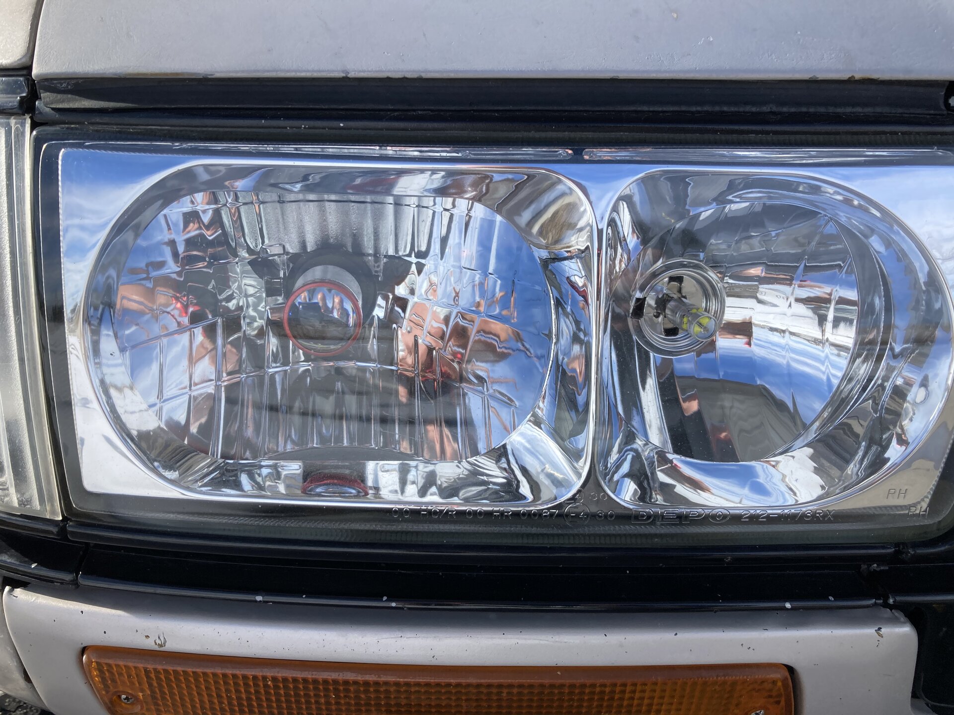

Here’s some LED projector bulbs in DEPO housings. They’ve got low beam ‘cutouts’ so as not to blind oncoming traffic. They’re not just a drop in fix though. Still a work in progress for me. One housing wasn’t sealed properly from the factory and my fix . . .well, it wasn’t. So I still get moisture in the DS one 😐
