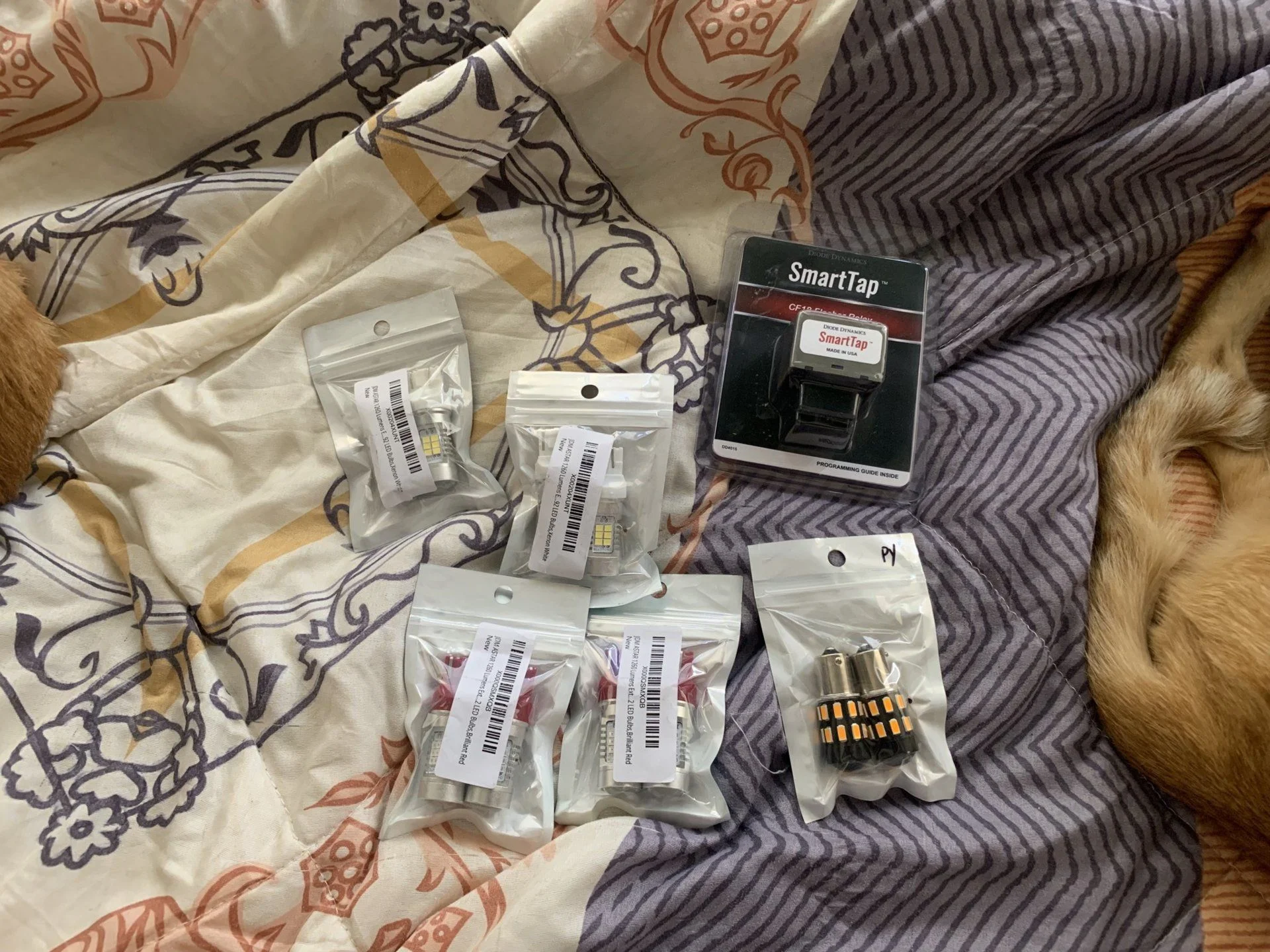

which one did you order? my new ARB LED turn signals are giving me a hyper flash.
I ordered this one from Amazon
Edit: Just realized it was the same one @MongooseGA posted above and it works great for me as well. For some reason on Amazon’s website it says “This Item Does Not Fit Your 2000 Land Cruiser” but it definitely does. Can’t speak on the dash light since I’ve never experienced that one before. I honestly didn’t even know there was a light on the dash specifically for an exterior light that’s burned out until I saw another member post about it a few months back hah
Dumb question, how to swap them out?
It was a real pain for me. It's tucked way up under the drivers dash (damn near to the gauge cluster). I had to use a 10mm on a 12" extension to unbolt the bracket that holds it in, and then only using one hand I reached up into the dash and unplugged it and plugged in the new one. By that time I had so many scratches on my hand from reaching up in there I didn't even care to bolt it back so it's just hanging in there. All the wires are tight though so it doesn't rattle for me.
Yeah I ended up just unplugging the stock one and plugging in the new one and I left it there. No rattles and everything works properly. I might end up looking more into the smart tap so I can get rid of the longer first flash and have some extra features.
