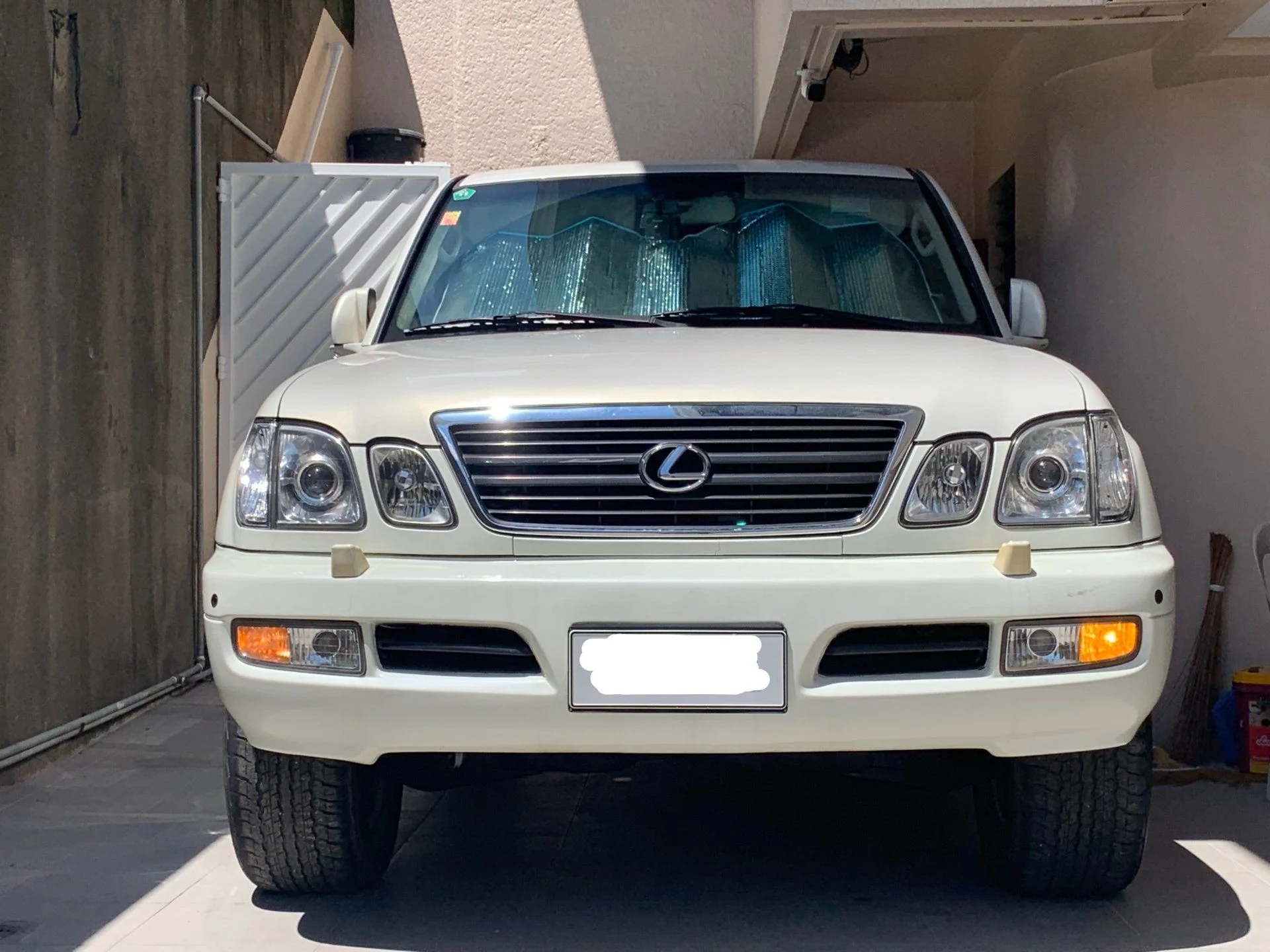

LED on the driver side, stock incandescent on the passenger side

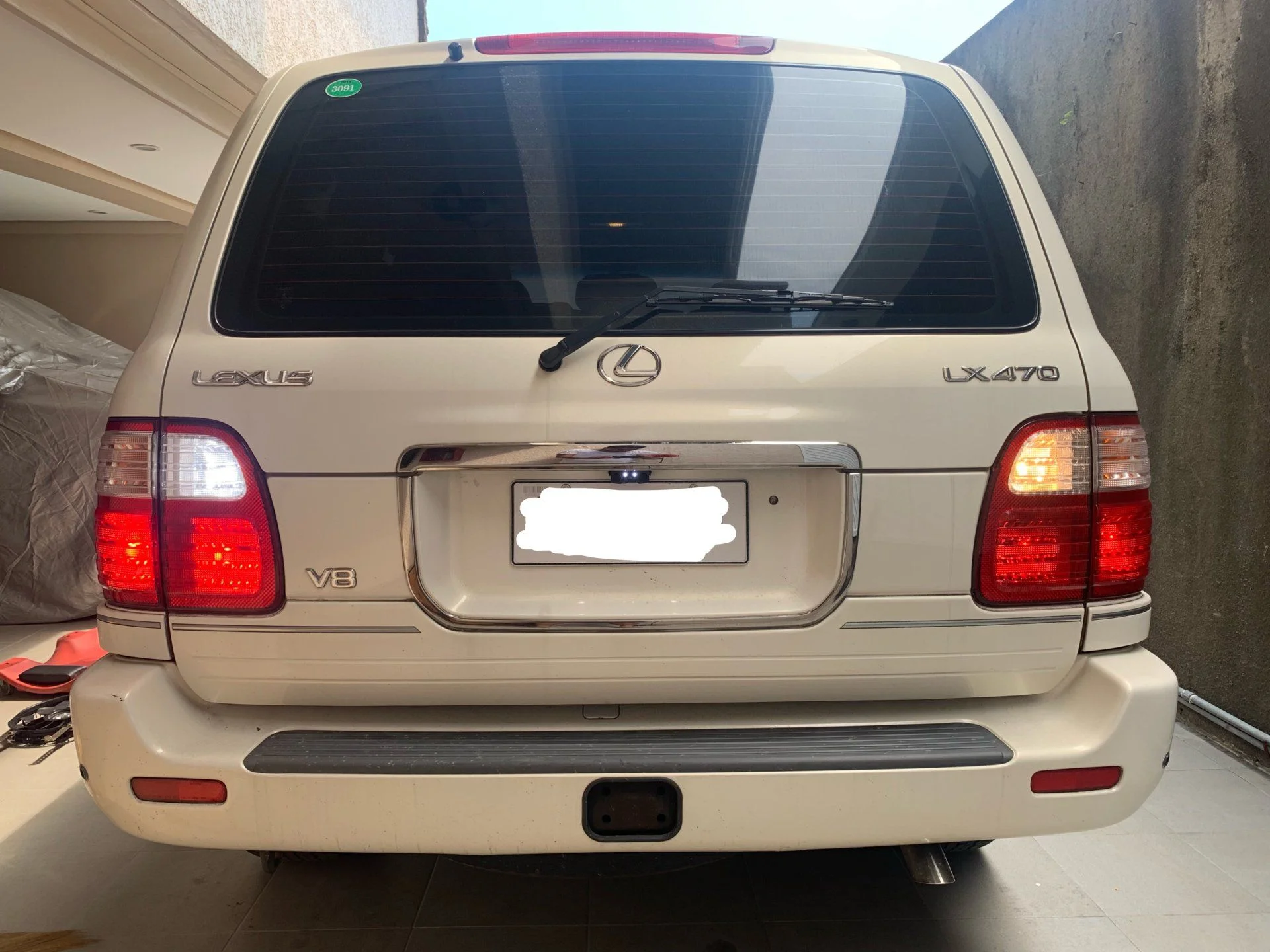

Tail and reverse LEDs on the left, incandescent bulbs on the right

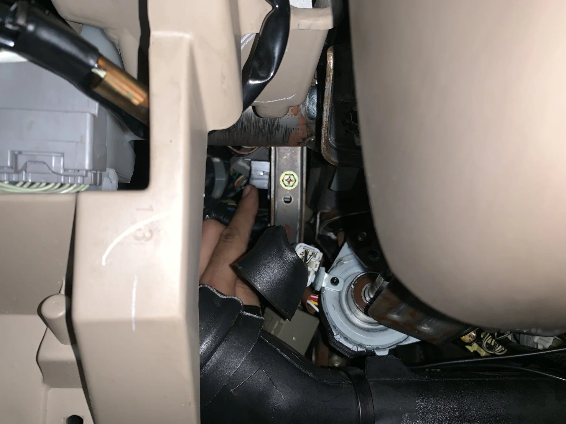

Factory flasher relay location. I chose to leave it in place and just zip tie the SmartTap in there
That’s neat. I find myself tapping the signal and expecting it to stay on in the LC since I’m used to it in my work vehicle. I didn’t know they made something like this.
You mean you left the mount in place or left the factory relay plugged in?
I left the factory relay mounted to the bracket. Unplugged the connector and plugged it into the SmartTap. Nice to have the stock relay in there in case the new flasher relay dies. Just unplug and connect to the other.

Thanks for the idea. Did this on mine last week since I always loved it on my German cars. PITA to get to the relay, but the Smart Tap device works great. I used VHB to tape the new relay to one of the large control boxes under the dash (I think the tilt/telescope module if I remember right). Left the old relay bolted up where it was.
