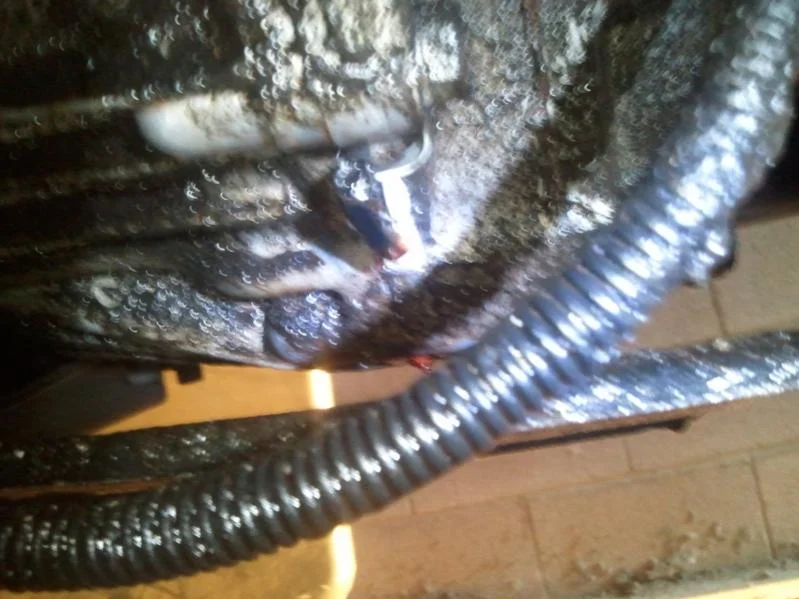

Got a quote for $1100 to re-seal the Transfer Case. Seems high? I'm dumb when it comes to autos. I've learned a bunch from this site, but don't have the confidence to try something like this with my daily driver LC. I thought it was a failed gasket for the transmission pan.

I cleaned it up over the weekend and it is indeed leaking transmission fluid. I see red oil leaking, but it's hard to identify the exact source. But it definitely doesn't look like it's coming from the pan. It seems like it's coming from what I shot in the pictures above.

What oil type is in the transfer case, and is there a weep hole between the transmission and transfer case in your model? Can you post up some new (focused) photos of that area after it's cleaned off?
The output seal of the trans is between the trans and xfer case. If red trans oil is seeping from the xfer case then I'd suspect the output seal. Either take it to slee or to your local Toyota dealer... unless you want to try repairing it yourself. Keep in mind that the xfer case is quite heavy and that a transmission jack could help you avoid an accident when taking it out and putting it back.
One more thing, I'd check the xfer case oil to be sure that it's not ATF leaking from there. The spec oil is GL5 gear oil, although it's possible for a previous repair shop to put in ATF, or another red gear oil like Redline or similar. No sense in repairing the trans if it's actually from the xfer case, like the shop says it is.
If you don't want to drain the fluid you could open the fill plug and dip a q-tip in there to check fluid type.
