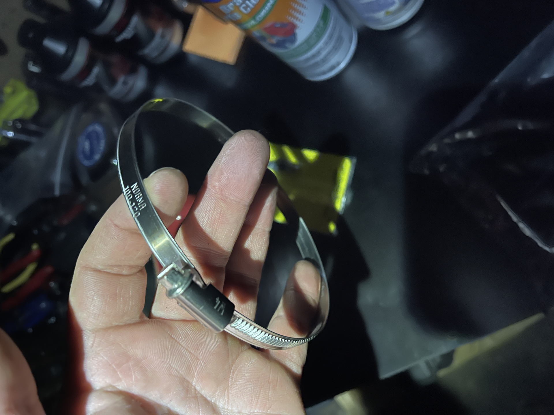

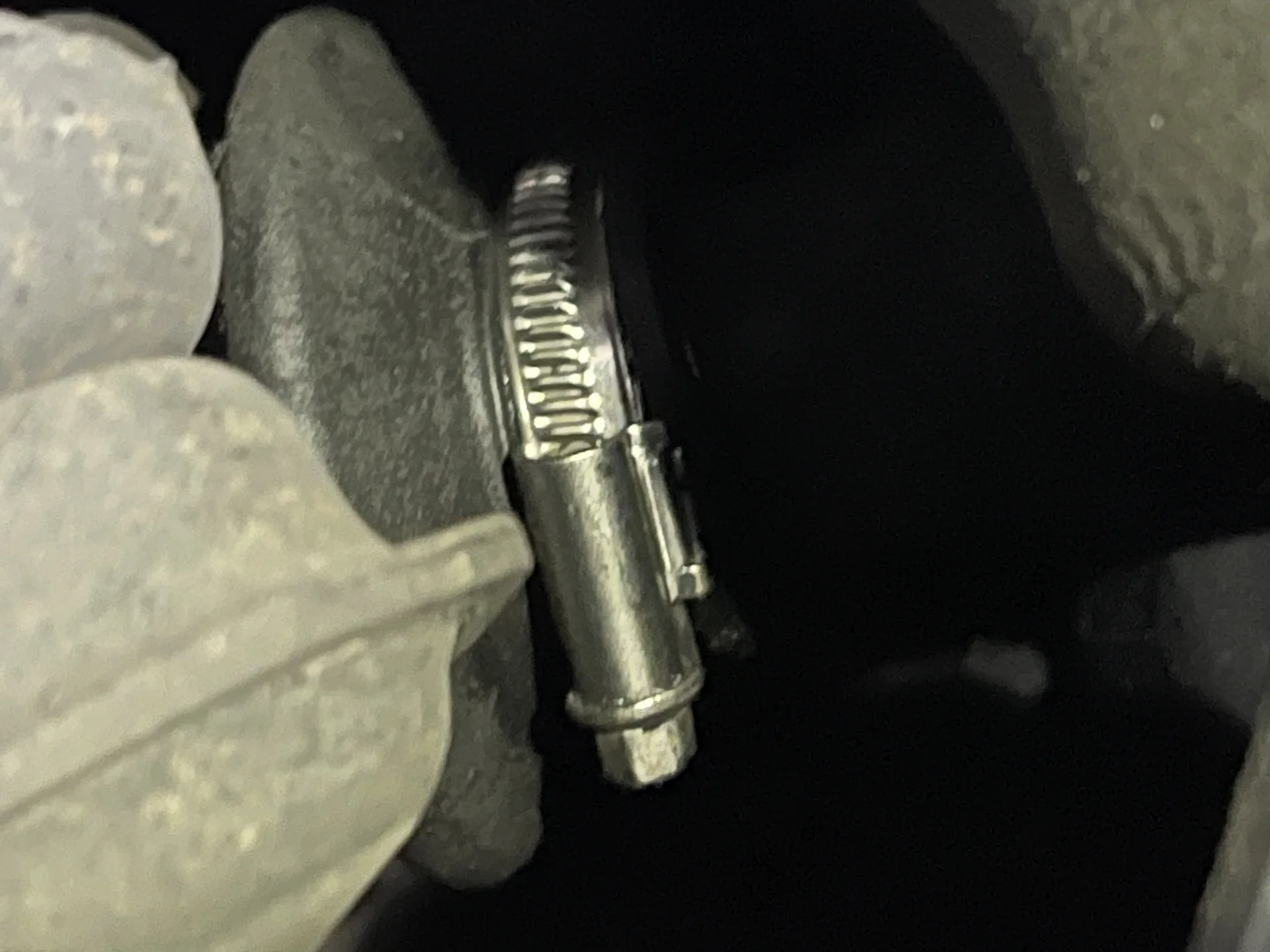

If you are only in the early stages of your boots leaking like mine were, I recommend using these clamps, which you can get 2 in a kit (1 big 1 small) for around 8 dollars each from cruisergarage.com
I felt there was no need to remove my old clamp and risk damaging the boot. These high quality worm gear clamps fit perfectly overtop of the old clamps. I tightened them down overtop pretty darn good, and the boot is no longer leaking or moving whatsoever. Plus you get a cool decal with the purchase of each clamp kit. The edges of the clamps are specially smooth and rounded, so they are made to not dig into your boot.
