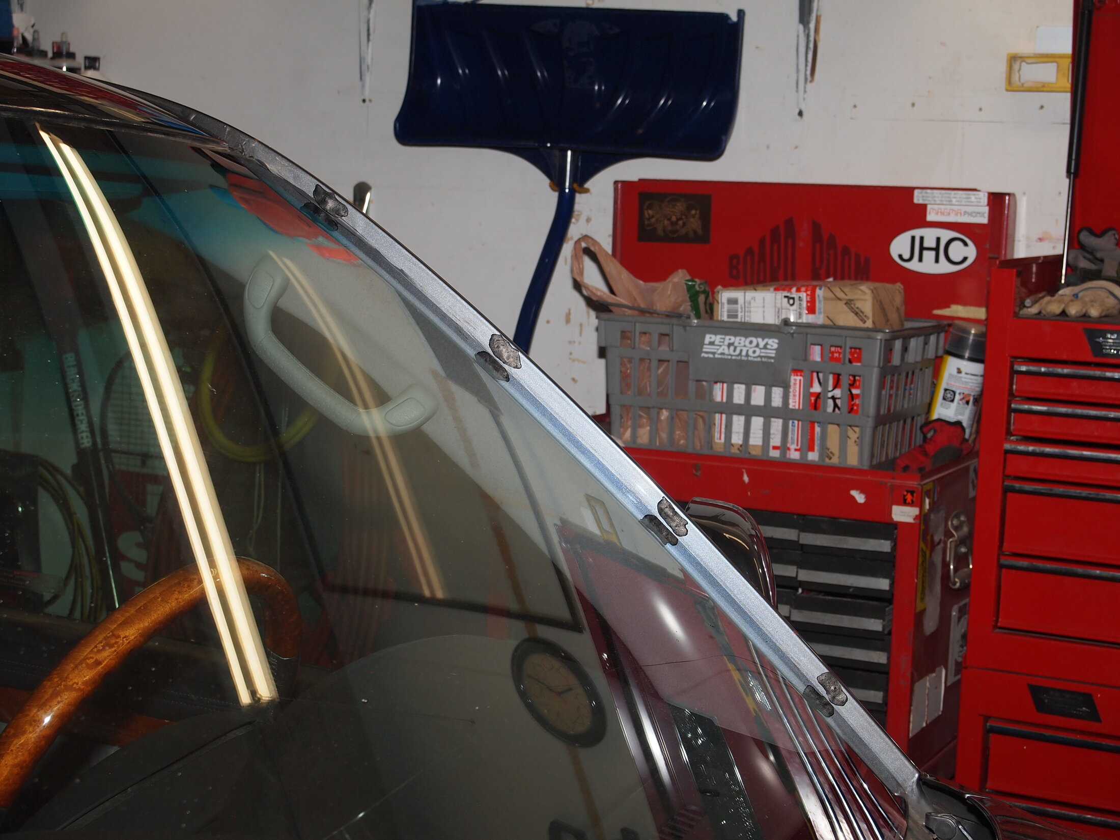

One or more of the factory's 4 rivets holes on each side, open. (not used) Sometimes extra holes drilled. Remove side molding and correctly install. I plug holes with bytul until I reinstall molding properly.
I remove any suspect side molding and plug the 4 holes:
Leaks at top center of WS. Where the OEM WS has rubber a mounting block, that effectively blocks a hole it sits in. Installer needs to place tap under hole and top with black poly during install of aftermarket WS.

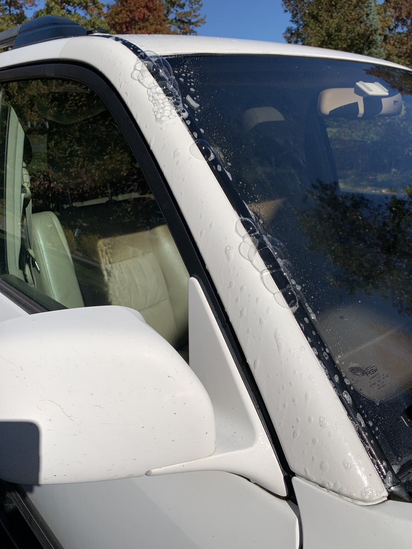

Hunting for leaks, by pressurizing cabin and foaming (foamy car soap or cas of windshield cleaner), watch for bubbles.
Cabin fan on high with, outside air on.
Tape over rear air out vents fins, is helpful. As leaf blower used to create positive pressure in cabin, with blockage in opening of window hose is run in..
Foam area suspect, and watch for bubbles.

I got the bubbles coming from the outer edge - between pillar and the molding. Should I try to put a sealant along the edge - vs. removing (and possibly breaking ) a windshield? Even if this is a temporary solution - who know when I have a broken windshield and need to replace it anyway.

Removing side molding, may be best option. But perhaps it's just the one rivet missing. If so you could install a new rivet.
But what I find, when install was poorly done. Is other issues also. Number one, installed has nick the paint under the molding. Which metal screws, for sure break the paint. Molding will hold in moisture, resulting in the rust.
So what I do as a temporary solution. Is remove side molding and plug the 4 rivet holes on each "A" pillar, windshield bytul. Seen in post #3.
I drill old rivets out, just drilling off head of rivet. But in most cases including yours. It's very likely, the installer used either screws and or glue (black poly), to secure molding. I use carbon fiber body tools (chisels) to slip under molding in roof canal, to break free of double sided tape. To often side molding is glued down, which it should never be. Also along "A" pillar if glued, which it should never be either. If one is careful, and metal backbone of molding is not bent. Molding can be reused.
It's best that the top molding running along roof line from side to side, not be removed. As doing so, usually causes leaks. it's a 50/50 shot.
