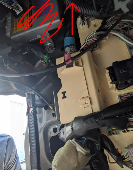

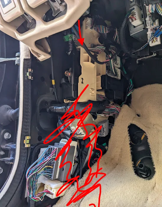

About a year ago, I picked up a 2004 LX470 for a family adventure rig. It's relatively low mileage (166k) and was a southern truck until 2021. I've gleaned a ton from this forum, but have come up short with addressing a pretty bad leak. Hoping somebody has seen something similar!
Basically, I have a leak on the driver's side, somewhere up high and behind the dash. The lower electronics (pic 1) are getting wet, along with the floor carpet, ultimately soaking through the floor. After a recent heavy rain, I felt further up the dash and found the gray box (pic 2) was wet, indicating the leak is somewhere even higher.

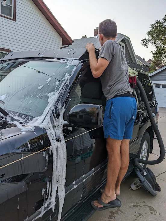

I pressurized the truck with a reversed shop vac and the truck's blower on Hi, then checked all over for bubbles in soapy water. Pretty amazing how well this worked! A few interesting findings:
  • One of the 6 roof rack mounts was generating bubbles, but another turn on the bolts made it go away.
  • All other roof rack mounts (and the other installed non-rack feet) were completely leak free. Gives me more confidence about the Sherpa rack design!
  • Absolutely ZERO leaks around the perimeter of the windshield.
  • Minor bubbling around the sunroof, which wasn't too surprising.
Considering the perimeter seal leaks, I took a water bottle and double-checked my sunroof drains. The driver's side drains (although slowly). The passenger side was not draining correctly, but that's not the side I'm getting water on, so not sure what to do with that.
After running several quarts down the sunroof drain, there was still no sign of water in the original areas.
