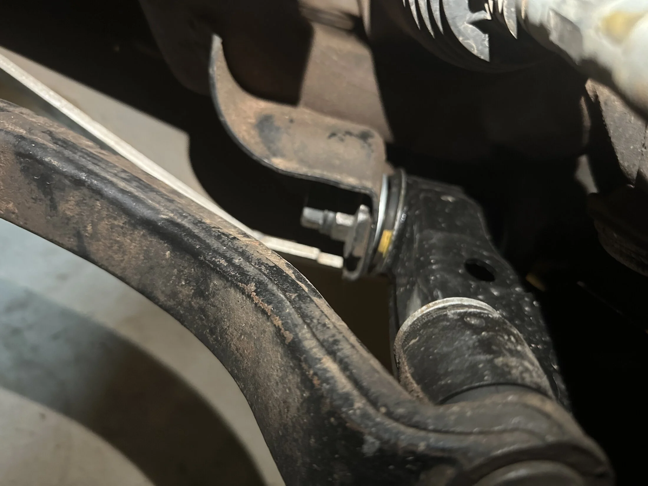

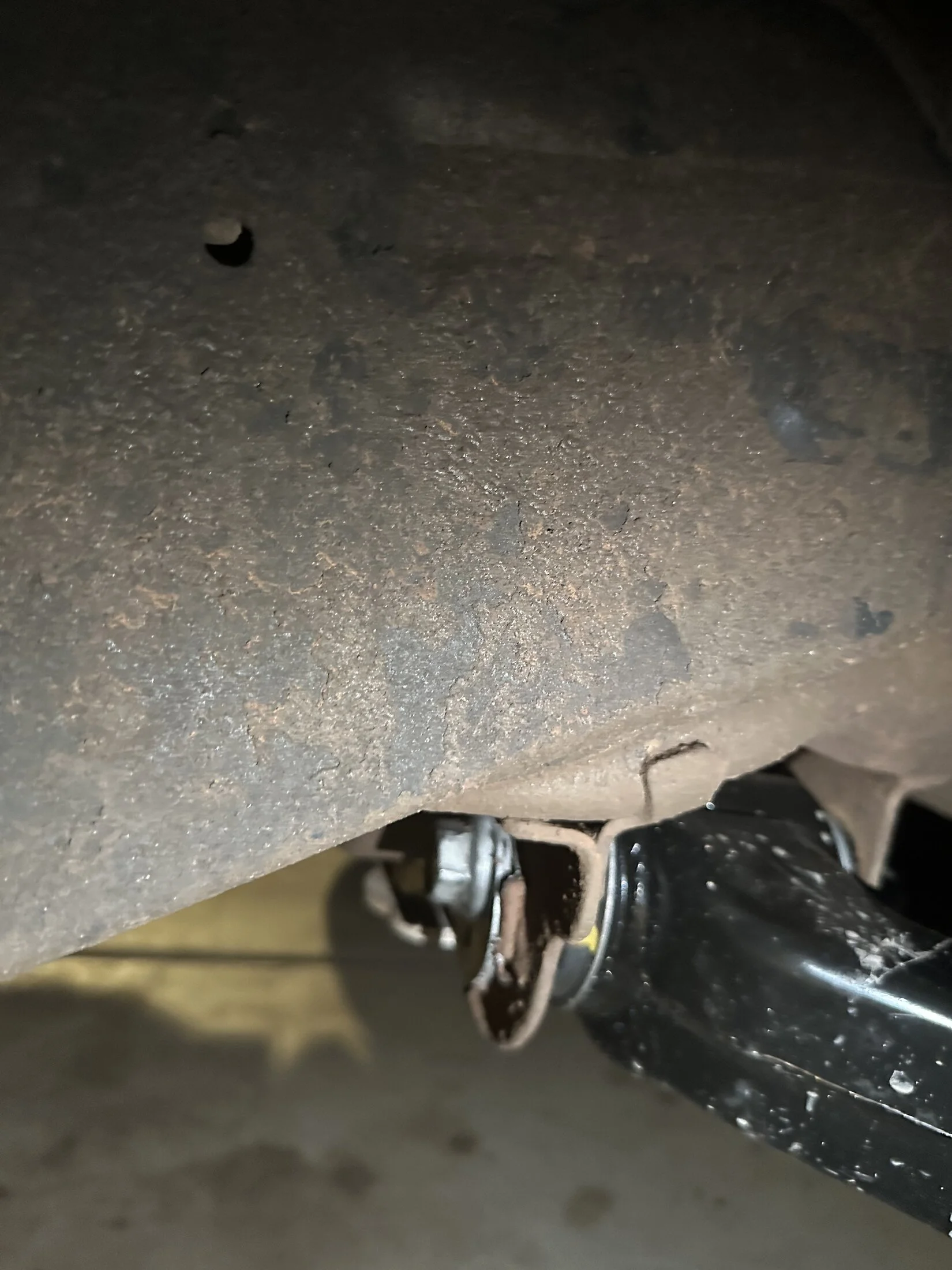

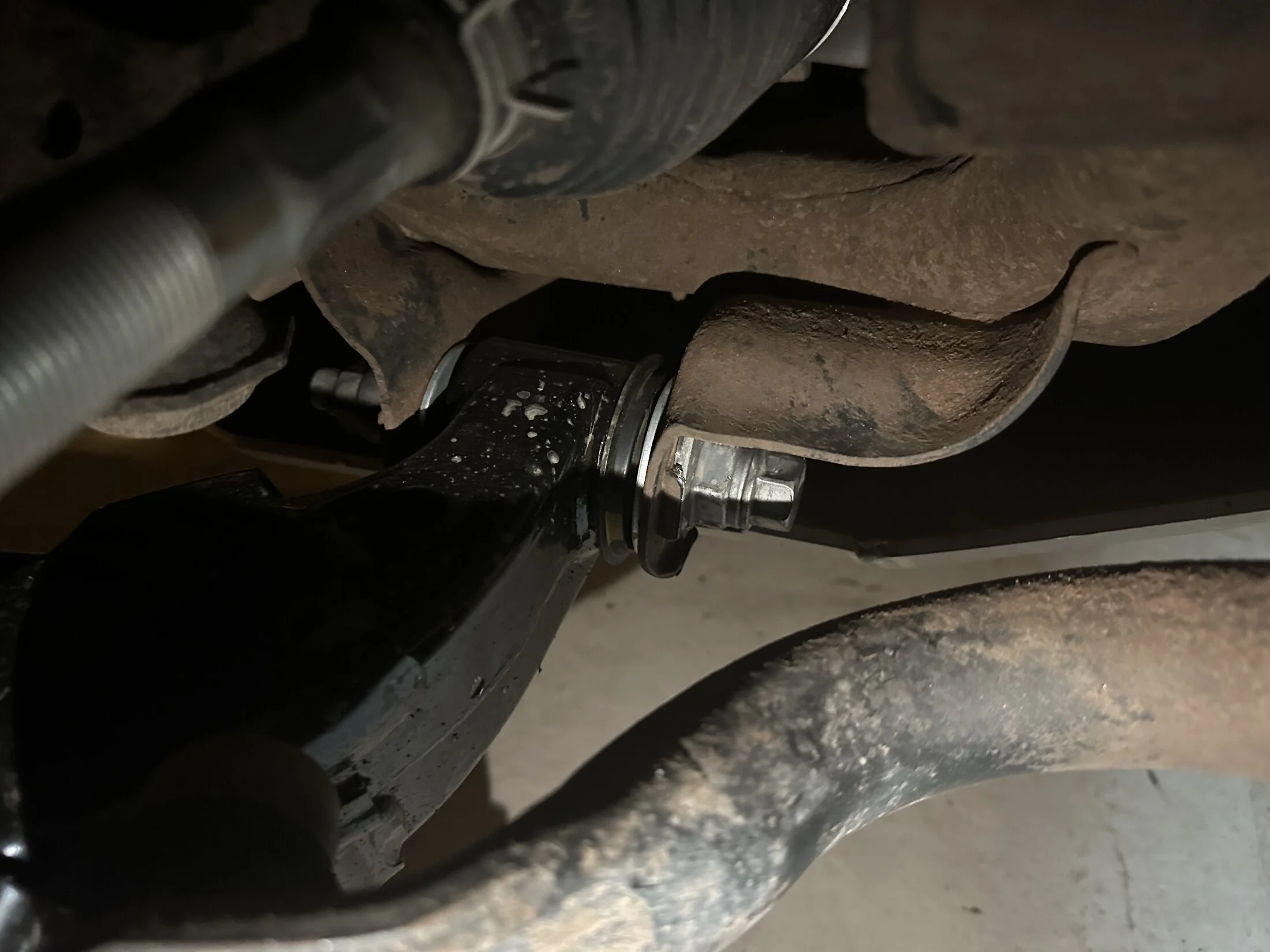

I don’t know how to tell aside from removing the LCA, but the big metal washers or whatever they are which are part of the bushing are on there. I can snap a pic of that later today.
Driver rear cam
Driver front cam
Passenger rear cam
passenger front cam

There’s definitely decent movement. My KDSS arm is super shiny right now, despite the caster supposedly being 0.2deg less than it was when I brought the truck in the shop to have the LCA done. And *something* is clearly popping each time I stop and start, or put the truck off camber entering my garage or a driveway. When my wife tells me she’s hearing noises, I know it’s loud. Guess I’ll see what he turns up tomorrow.

Ok so alignment is done. Caster was off by a ton (~2 degrees) but given my mechanic buddy and I had tried to tighten the cam bolts further and we could see the cams start to move I'm not surprised they were off. He loosened everything, tried to reset the bushings, and readjusted. Caster is around 3.3, camber 0.0.
