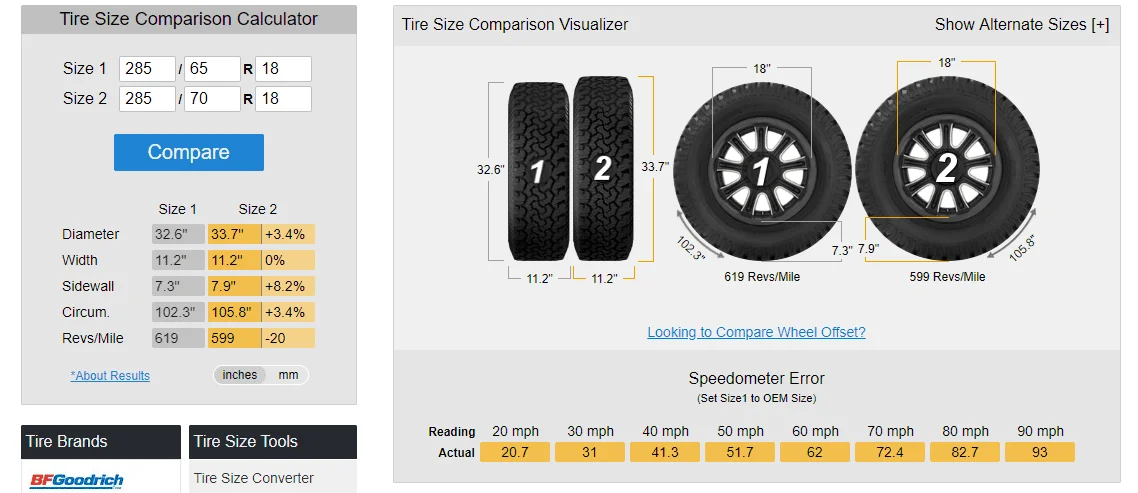

Thanks! I could not really find any info specific to the RG on the database. I do want a tire that looks a little bigger and more aggressive; so is there a big difference between the look of the 70 and the 65?
It will look different. It's about an inch larger in diameter.

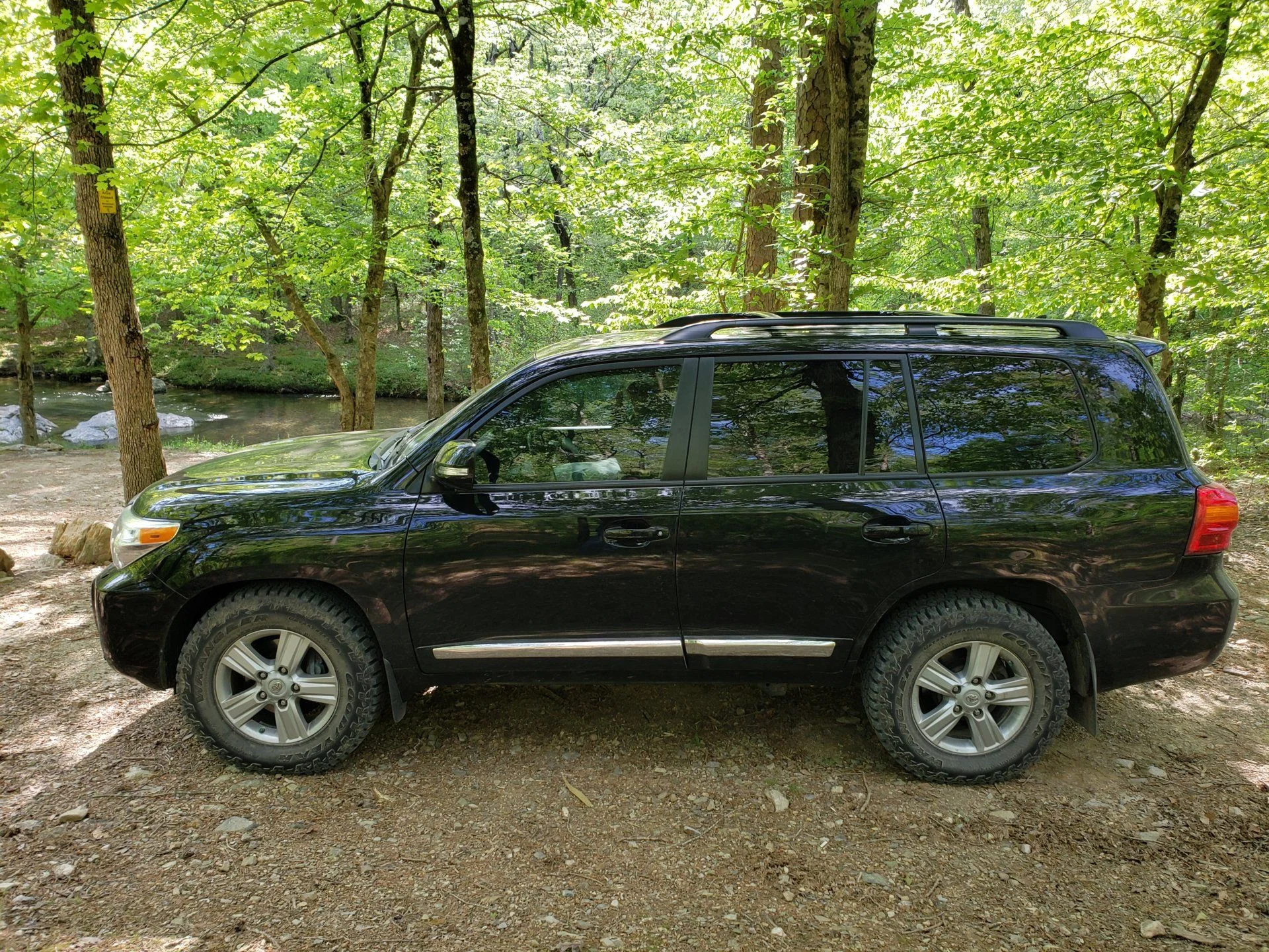

Here's my 2013 with stock suspension and 285/65/18s
