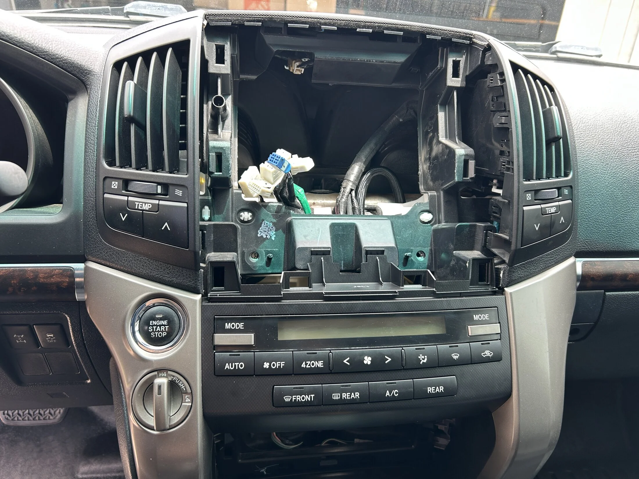

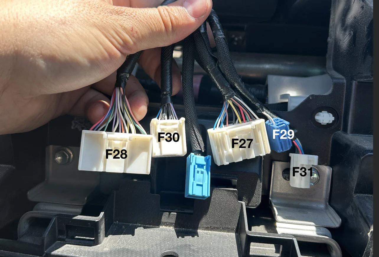

The first thing I did was tear out what was left of the dashboard and labeled plugs so I know what I'm dealing with:

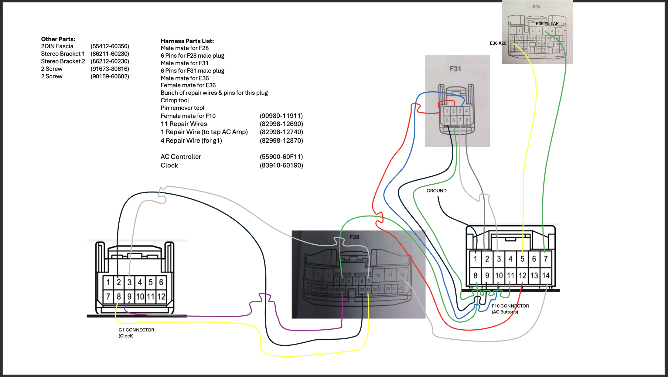

I am more of a visual person, so this definitely helped, but I also translated TXSunDevil's into a crude visual wiring diagram. I need some help to identify some of the missing components to make a complete harness. If anybody has any input, that would be greatly appreciated. See below.

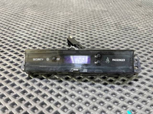

I wasn't able to find the clock (83910-60190) although in @alta thread he mentions part number 83910-60200 which looks more correct based on what I have already in my Land Cruiser. And I was able to find a few sources for this online.

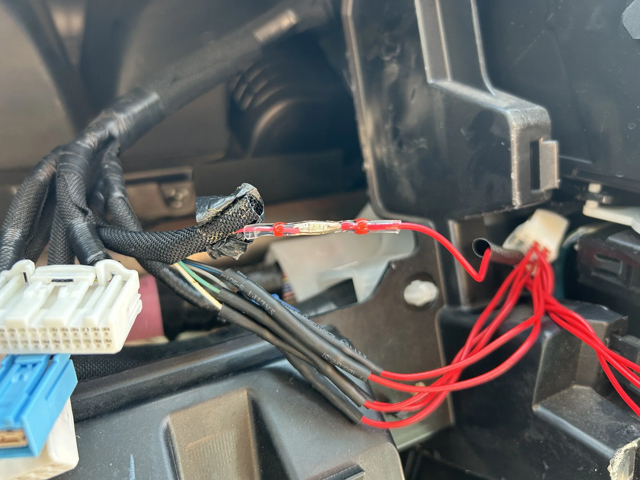

Below, is mostly everything hooked up. I ran and spliced everything according to the diagram I showed and thanks to @TXSunDevil for his pinout. There was only one thing - the green and white wires on the F28 connectors appeared to be in the opposite position on my harness. I didn't sweat it too much and just hooked them up in the same way that the pinout diagram described, because after all they were just for illumination. But regardless, everything worked fine anyway! Everything else was according to the diagram.
I used those shrink/melt connector splice things. Probably could have soldered but these seemed okay. At the end I loomed everything with braided loom.

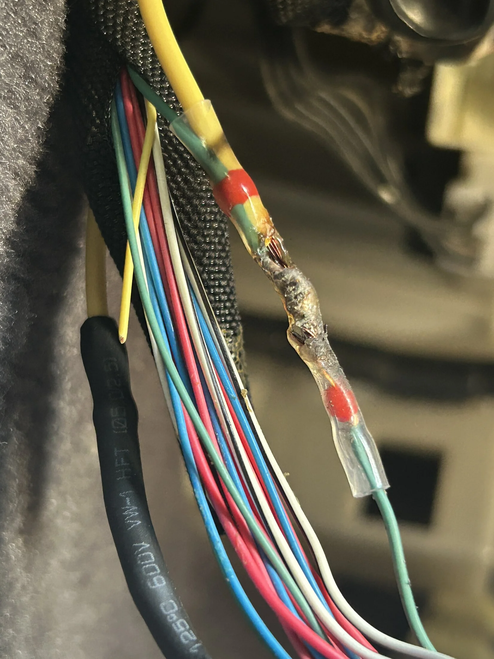

We had one little oopsie with the only tap on #5 on the E36 AC Amplifier (see below). It was definitely a challenge to make the tap fit and sit correctly. I let the lighter sit on it a little long and caused a little bit of a fire.

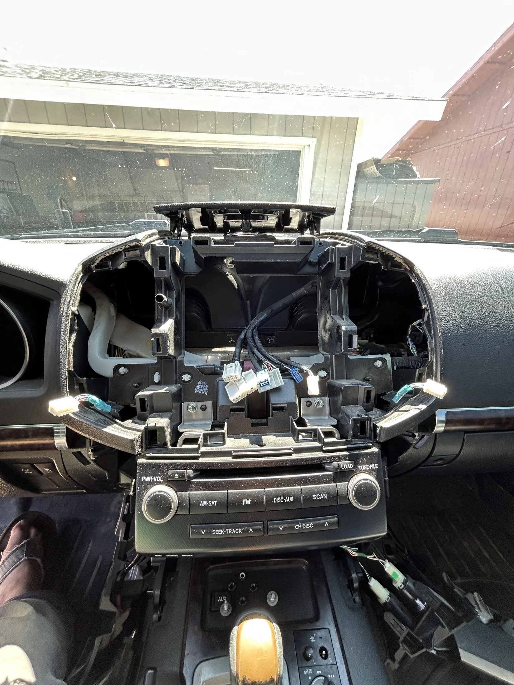

Here it is, in place of the previous radio and CD changer. I pulled the radio plugs through to the top where they will ultimately sit. I still do not have a clock as I cannot source the part number. Still looking around as that is a pretty serious concern with no airbags.

yes indeed! I have looked at partsouq. they show the part 83910-60190 out of stock along with other parts retailers including Toyota dealers. The part that I see available from Toyota is 83910-60290, which I would assume is the subsequent replacement part, but I don’t know how to confirm that.
Hmm, here is a photo I found of that one, https://rrr.lt/en/used-part/ipj9665...land-cruiser-j200-screen-display-small-screen
I tried Metra and they said they didn't have anything to integrate an aftermarket radio.
Also, talked to a Toyota dealership about the clock - they didn't have any 83910-60190 but did have 83910-60200 but showed it long discontinued with no current part number. I will have to keep looking around. I'm not highly confident in the part number they gave but might have to find one online and try it just to see if it will work out.
