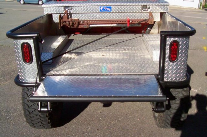

First is.. why not take the doors and then put them "behind" tubing, just like you did the rest of the trailer. So two doors opening the same way, but "surrounded" by tube. What that means is you will use "less" of the material from the doors I suspect, but you still get the unique stamped insets that look cool, etc.
OR...

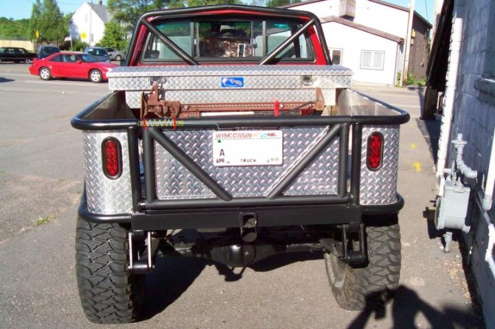

Plan B - Tail gate. When I was considering a flatbed for my pickup this is one of the cleanest beds I had seen and the tailgate would look PERFECT with your trailer!?
Tailgate.
I am also thinking tailgate.

Nice idea on both accounts. I'll have to examine the first idea today and see what I can come up with. Framing the doors with tubing, hmmm...
Tailgate for sure. While I like the amby doors they do kinda stick out compared to the rest of the trailer in tube.

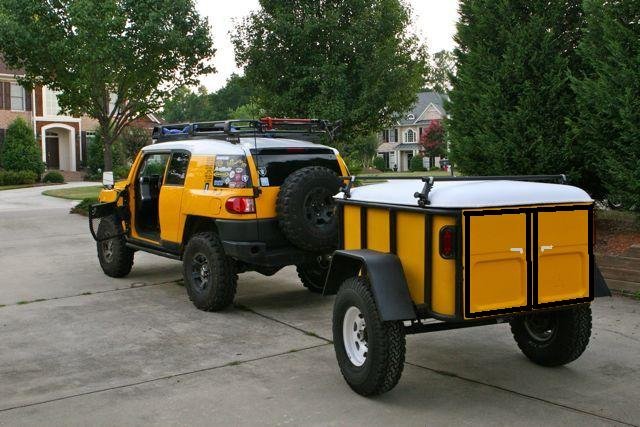

I've changed the bed of the trailer, it will look and function way better than what I had. I'll be posting updated pics this weekend...
can't wait to seem em' Jerry, hope it turned out as you expected.
I think it met my expectations and then some. You be the judge, here are the pics. I didn't like the tub floor I originally put in and decided to take it out and upgrade. I had to find the bed rails to fit my trailer specs, then scored some red oak for the planks, on sale at the local lumber yard. I finished the wood with some clear sealer since I liked the wood color so much and it matched the theme.
So, here some recent pics of the upgrade...
The girls playing with the water out of the tank, it sprays over 20 ft...
With the lid up...

Did you redo the tailgate area?
Yes, not done yet, had to finish the bed first but took your and Jon's suggestions into account...
