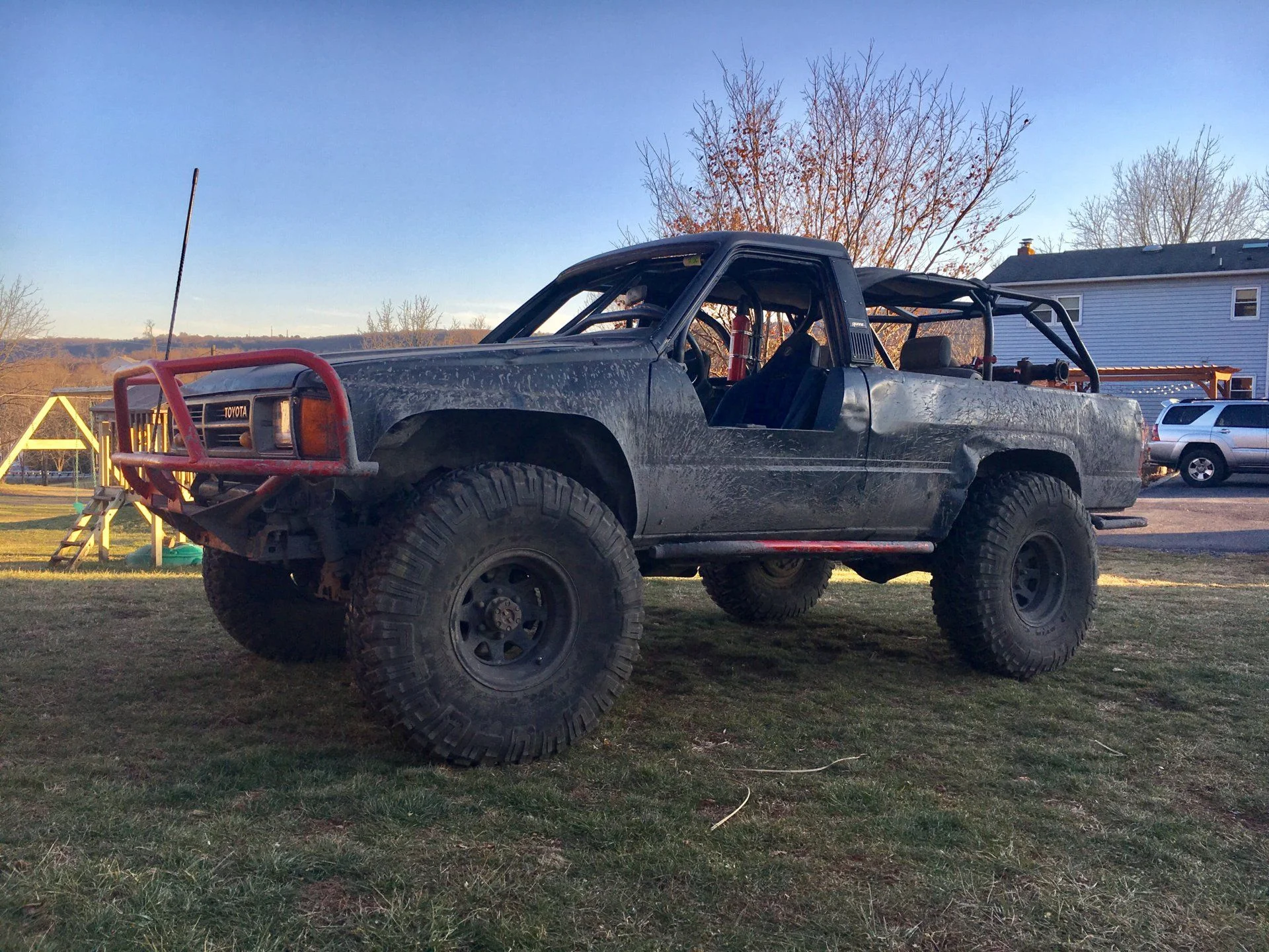

I initially trimmed and ran 35’s, but run 37’s. No lift, lots of trimming, stock IFS. Running 15x8 steel rims with 3.5” backspacing.
Pre-roll over with 37” Pitbull Rockers
Post roll over and 37” MT/Rs
jtaco1 - Are those American eagle Wheels your running?
Not sure, they could be any of the standard steel 15x8 rims that are available. I got them in trade for a set of FJ40 rims. I did have to grind the outer edge of the brake calipers slightly for them to clear.
