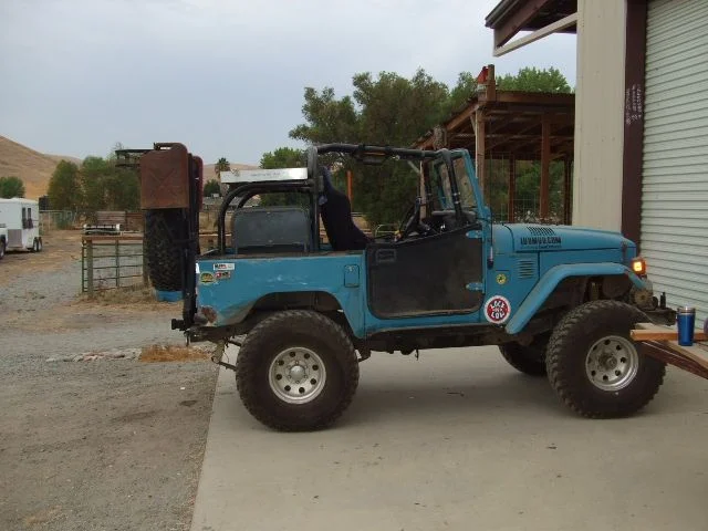

4" SOR lift
2" Man A Fre body lift
35x12.5x15 BFG MT's
I rub like crazy in the rear portion on the rear wheel well. I should really cut them.
4" SOR lift
35x12.5x15 BFG MT's
why? it looks like a custom roll is forming back there. people pay big bucks for that.
