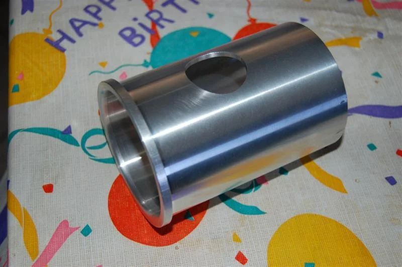

I've got the aluminum sleeve and it's been installed and the tested through the OBDII port, a wide band O2 sensor and the test procedure out lined in the FSM. Using those three to evaluate the change everything is within factory specs.

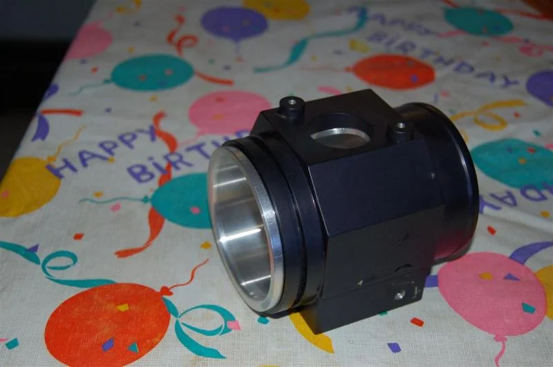

To install the sleeve you will need to place the cleaned housing into an oven heated to 350* for 30-40 minutes. This heat soaks the housing and expands it. You then slip the sleeve into the housing and position the hole for the sensor properly. The hole doesn't need to be exact but does need to be close.
You will only get one chance at this as once the sleeve expands to the same temp of the housing it will be locked into place. As an added precaution you can place the sleeve in the refrigerator while the housing is in the oven to give you more time to align the sleeve.

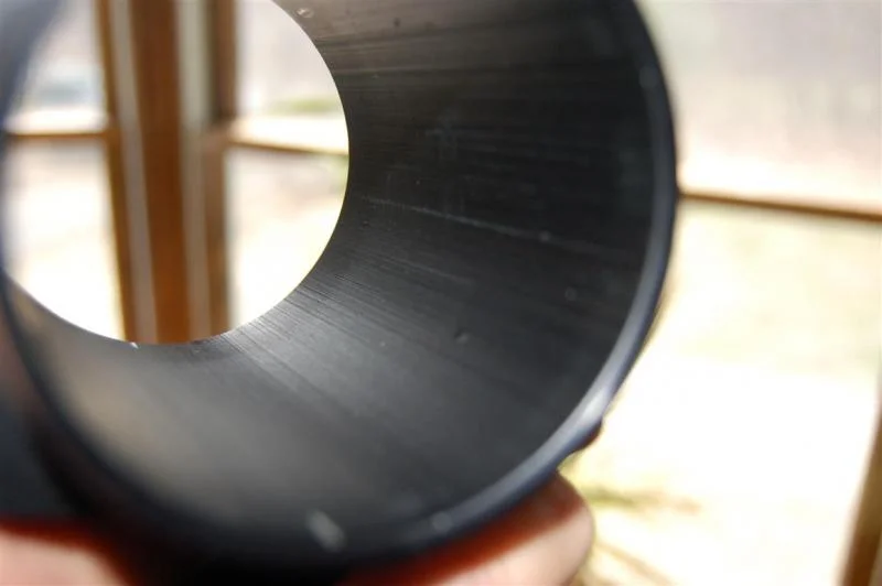

During production of the original housings there was a slight change made to help with cost. The sleeve is designed for the more common housings and can't be installed in the others without some slight machining.
To tell the difference you need to inspect the bore of the housing.
If the bore has slight lines running along the bore it is the more common housing and the sleeve will fit.
If it is a smooth bore or has some radial lines around it, the sleeve won't fit and please contact me so we can work something out.
For those uncomfortable about the install of the sleeve you can send me your housing and I can install it for you.

Attached is some pics of the sleeve and it installed in a housing and the install guide.pdf.

Hi Rick,
Can you take a close-up picture of the bore? I just want to make sure as to which version I have (one with slight lines, smooth or radial lines). Also can you remember when you changed the design of the original housing?

Rick, I'm curious as to why you wanted the sleeve to be such a tight fit to the body. Obviously you wanted it to stay in place, and you said you didn't want to use glue to do it, but is that the only reason?
yes and I didn't want any possibility of any air diverting around the sensor or the sleeve moving out of position. Having it installed this way ensures that the sleeve is aligned perfectly to the bore.
It's important that the air flows through the housing in a controlled predictable manner.
It's a .004" interference fit. When you heat the housing it expands about .009" which is enough for the sleeve to slide in and allow you to position it.

Yes the sensor stays the same. Right now I have some of the original housings that are brand new and will be installing the sleeves prior to sale.
Because they are left over inventory the cost will be with the addition of the sleeve.
