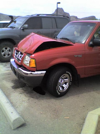

x2 on getting .We live in the desert, Deal withthe heat. Better vision for picking lines when wheeling. Never have to worry about going to fast,saftey isn't an issue after seeing the damage to the car I ran into and only chipped paint on my bumper. When the guy in the Super Duty ran into the back of my 40 the only reason I had any damage was because of the lack of a rear bumber, but the SD needed a new front end. Can an 80 or a 100 take that kind of hit in the rear ?

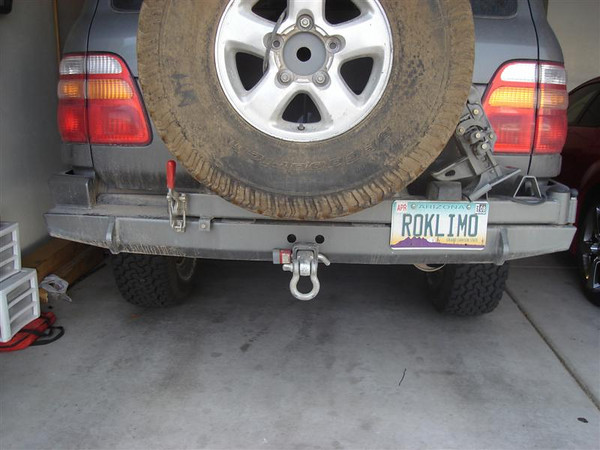

My 100 was rear-ended in July. The Ford Ranger front end was totalled. My rear bumper was not hurt whatsoever. The only thing that happened was my tire carrier bent inwards a touch. I'll not fix it. Don't even have a scratch.

Not trying to stir the pot here but personally I don't think a Ranger falls into the same category as a Super Duty.....I think Bills point is the size of the vehicle. (Ranger 4000 lbs vs Super Duty 7000+ lbs.)

thats a pretty funny pic of the clean spot on the tire and dirt on the hood..... but, i wonder what the 100 would do if i rammed it with my 18 wheeler? LOL.
i remember when i lifted my old pick-up i took a measurement of that valve in the stock height locale, then after the lift i modded the rod to match the original setting. it seemed to work well at the time for a 6" lift.
thats a pretty funny pic of the clean mark from the ranger hood on your spare tire,,, it matches the curve in the ranger hood pretty well too..... but, i wonder what the 100 would do if i rammed it with my 18 wheeler? LOL.

18 wheeler? My bumper would have been unscathed but the frame and 100 would have been mangled. :D
If I'd a been in the LX450 at 7+ inches lift he'd a went under the thing. Plus, the bumpers on my LX are 3/8" c-shaped steel. It won't move. The maker warned me never to hit anybody or their vehicle is toast (and possibly my frame cuz the bumpers won't give).
