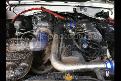

Mmmm that's one super very cool rig,
Any pics of the front mount intercooler?
Have you fried your accelerator cable yet?
What computer are you using?
Nice rig! What turbo is that?
Your interior pictures, please.
Clint! This is your favourite again. Boosted 4500 :D

It's the loop/bend in the cable and when the heat sets in is when the cable melts into it's sheathing and locks
yes i have it, i will post it later!
no bro, the accelerator cable is just fine!
Perfect power but next week i will install a new one.... haltech stan alone for a better tune.....
cheers!
My cable is in the orange heat shielding and with that slight bend to the fire wall it still jammed up, since then ive layed it directly over the turbo it has been 90% ok some times after parked for a while it jams but push the accelerator cable to the floor once and its back to normal,
you cable looks super long , do you have the Toyota part number for the LHD fzj 7 series accel cable.
Were did you tap in for your water lines?

My cable its different cause the steering wheel is in the left side...... i will find the part number for you!

I dont have a pic of a dyno chart but the LC78 is running 7psi and makes 296whp....
