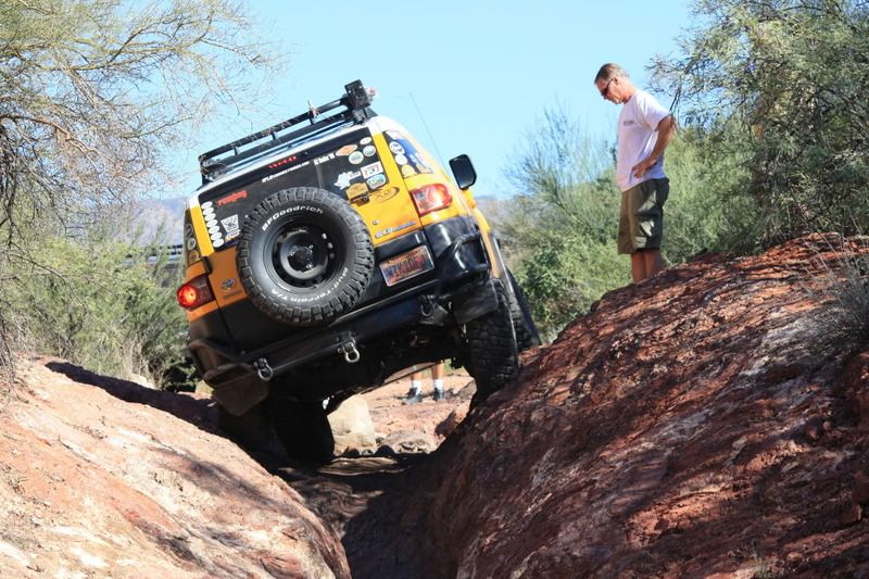

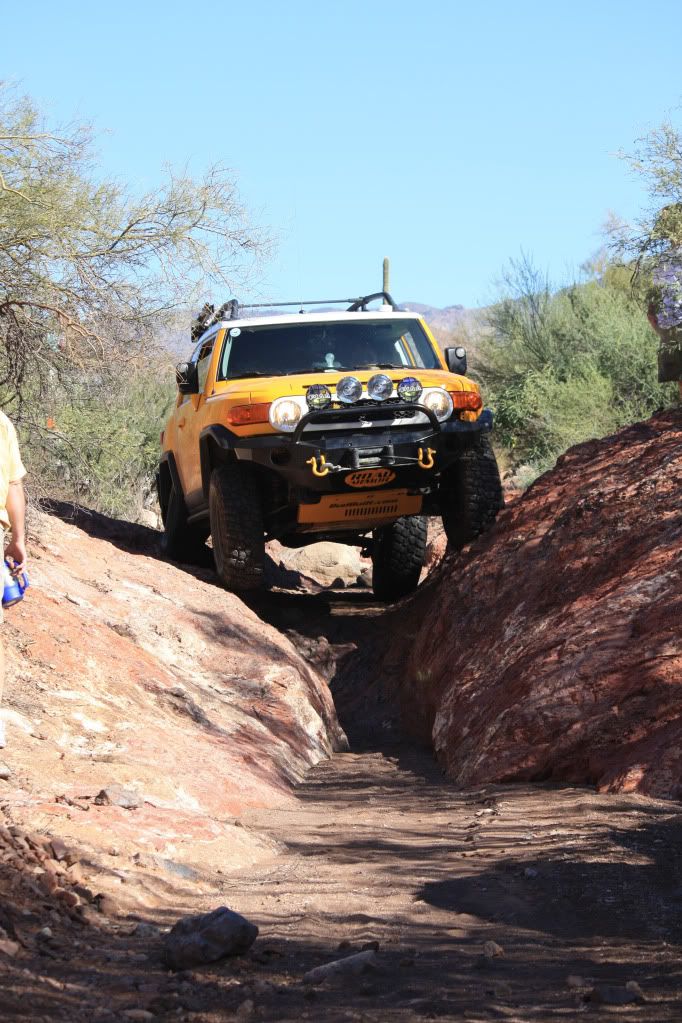

There are a few side options at Montana Mountain if you feel froggy.
Here is one of them
