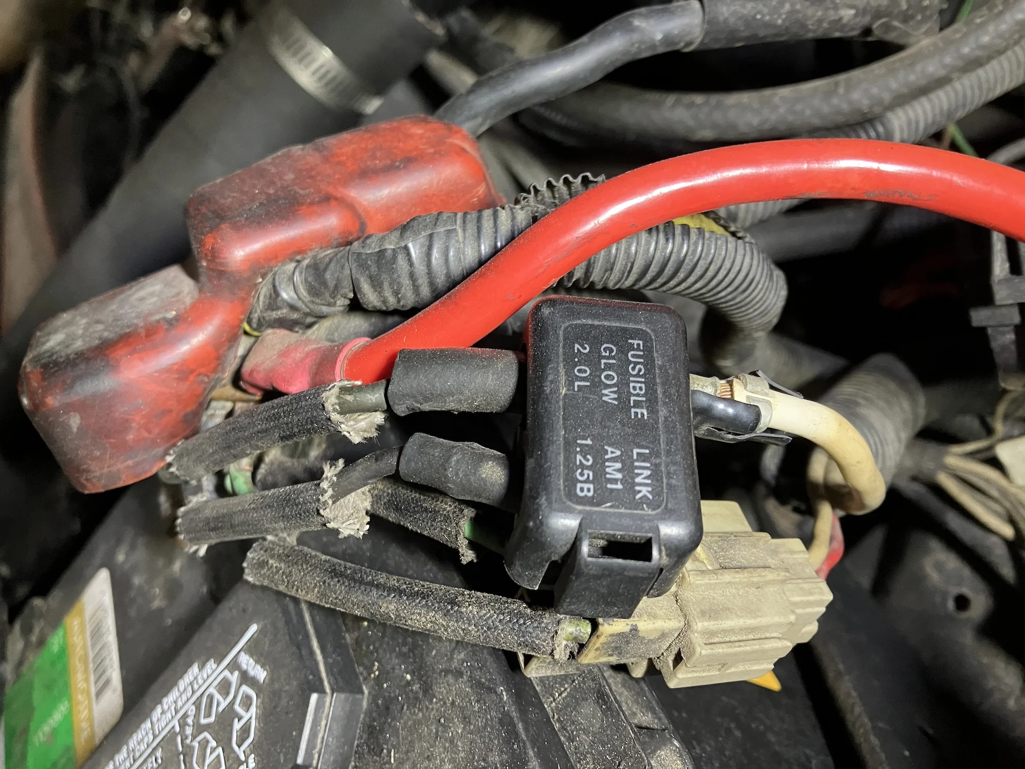

This is from an LJ78 rather than a KZJ78, but the fusible links should be similar. Often there isn't a good visual indication that the fusible links are blown, your best option is to test for voltage at the harness end with a multimeter.

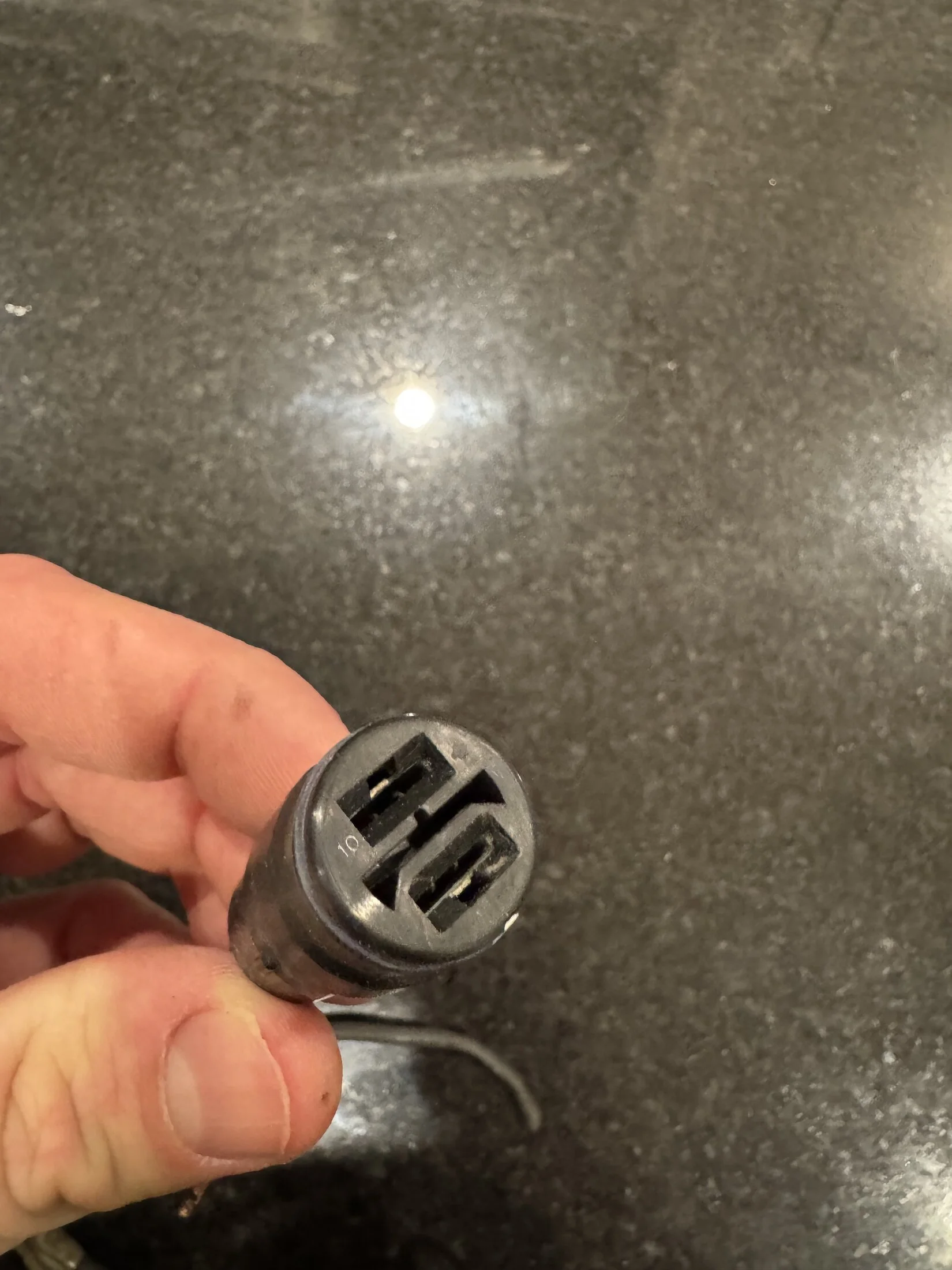

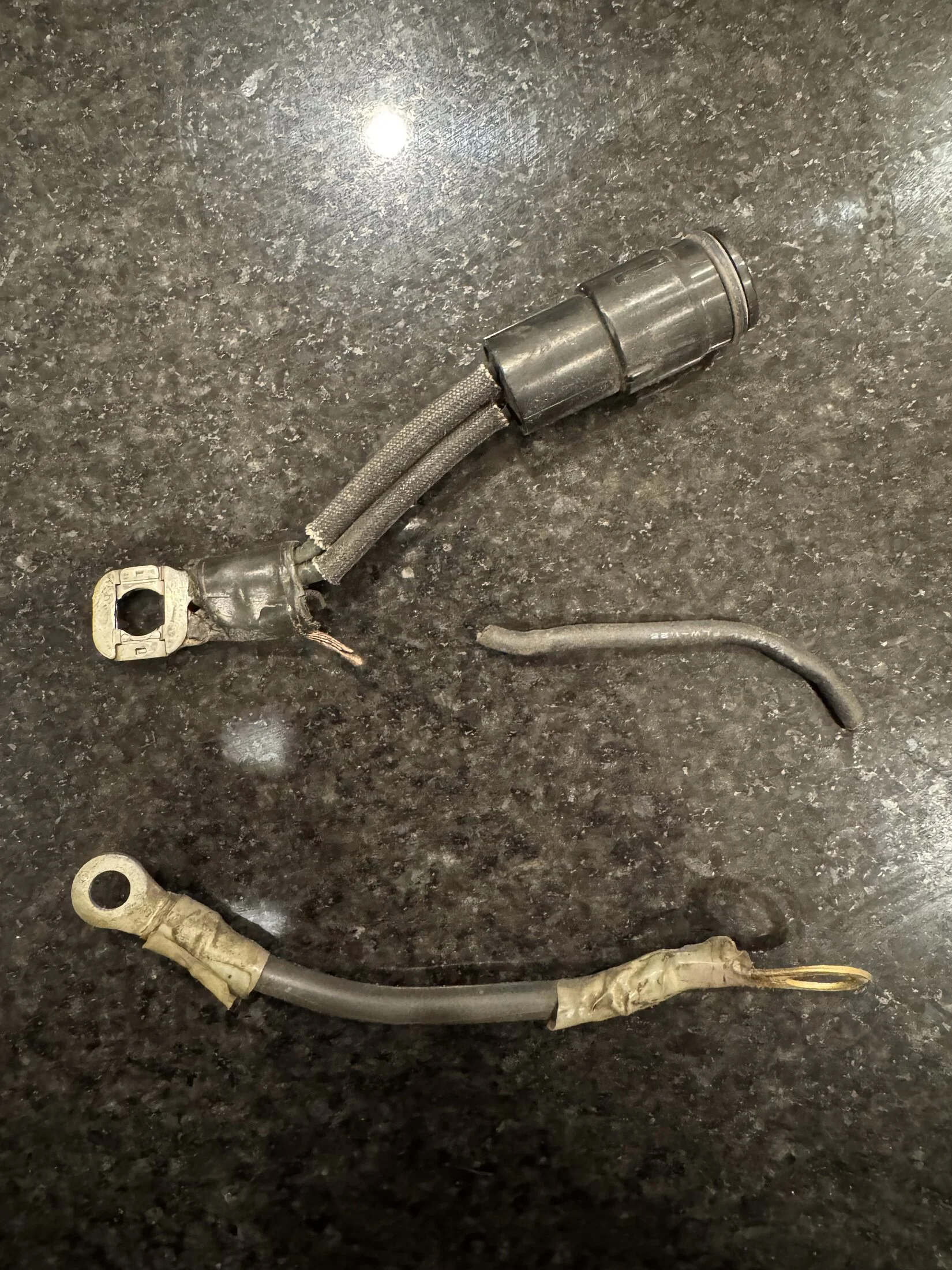

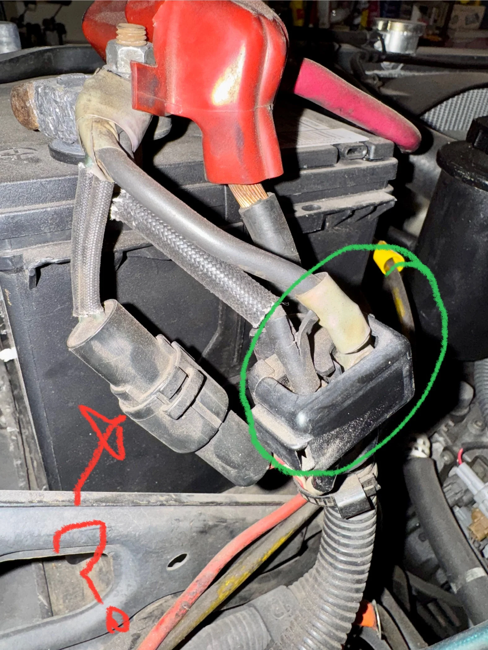

Ralf - thank you so much for the guidance…I think I found the links and I think mine are 2-cable links, I attached pic for confirmation…I circled what I believe are the fusible links and the red arrow with the question mark is a separate 2-cables with a gray cylindrical connector link that leads into the same harness as the fusible links. Do you know what those might be?
Hi
Yes, that's the fusible links; all three of them. No idea why one has that round connector; its factory standard.
To check whether any link is blown, check for current on the harness side connectors with a voltmeter.

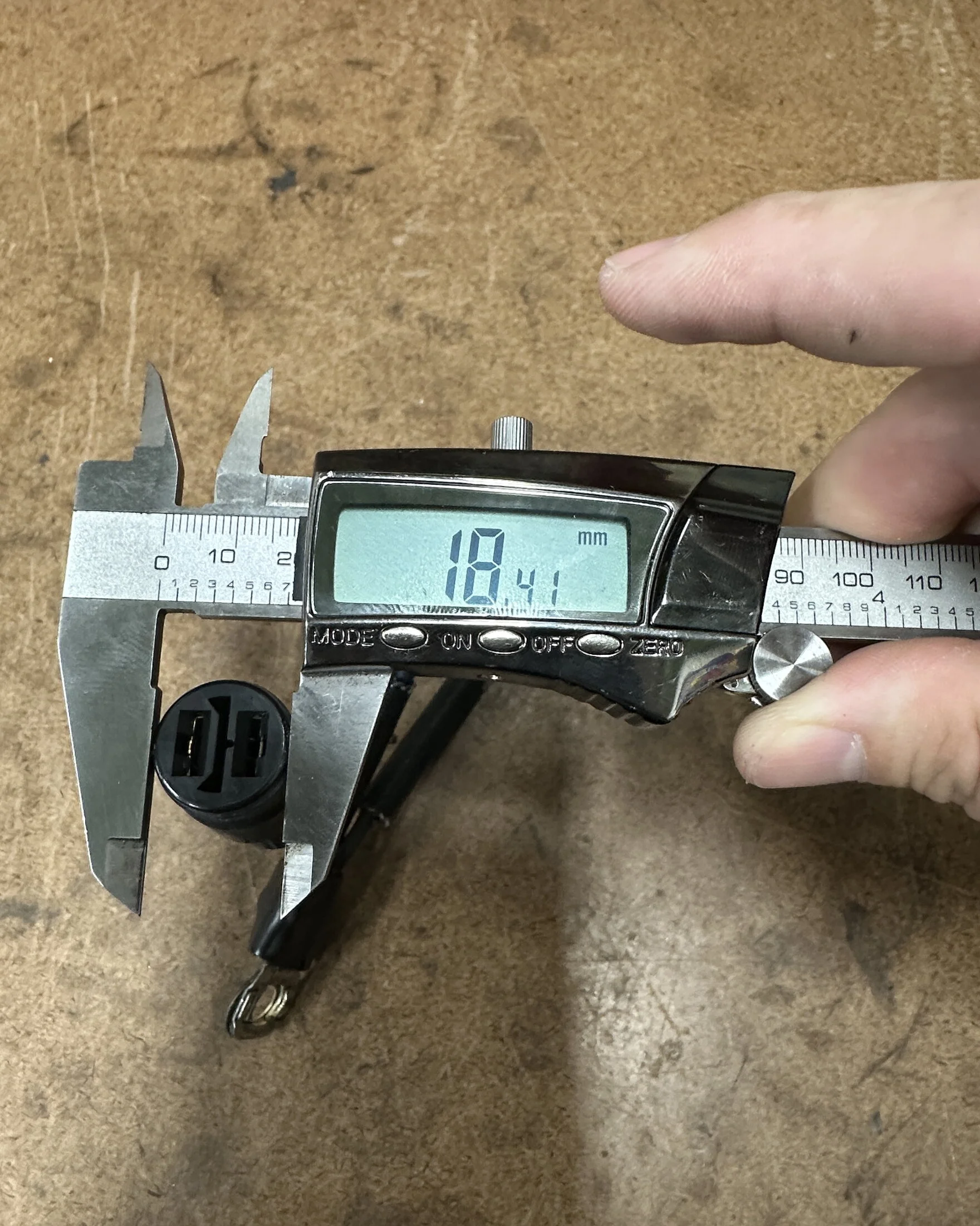

- i was huntering into this topic last night pretty deep and i did come op with 2 different part #'s for a KZJ78
- this is the later of the 2 part numbers based the Round Connector you have there
- Toyota does NOT give any sort of Links Spec.s for any of the 78 series , which is VERY ODD too ?
- so , .........
- all we need to do now is correctly COLOR CODE ID each of the 4 fusible links wires , and where each color code goes from the main ring terminal on your Battery
- this is Eazy Peezy ........

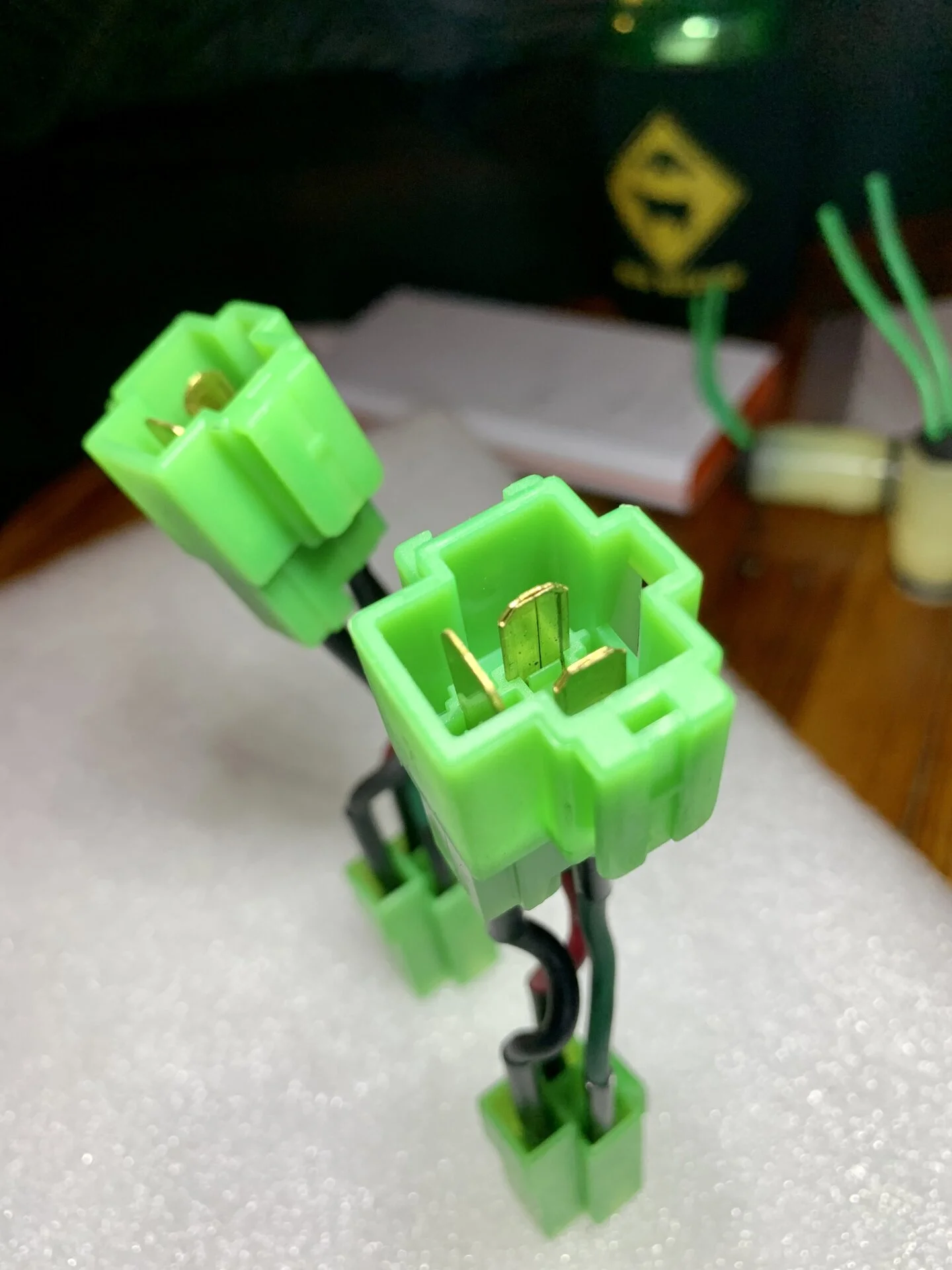

- oh , recent update : ALL fusible Links i personally reproduce and hand assemble now will come with the Harness Side Male Connector Housing , plenty of extra Terminals and any / all OEM Updated Stainless Steel Special Locking Flange Nuts too ..........
same exact my above applies to you and your LJ78 Fusible Links .....:)
i do have all the correct OEM japan spec. service parts , but no treasure map to tell me what color coded,.. fusible Link wire goes where in your Early Style
GLOW STICK GREEN ROBOT Connectors set up ....:D :wrench::wrench::wrench::wrench:
This doesn't sound like a fusible link problem. I don't have a kzj78 manual in front of me, but generally speaking, one link will be headlights, one link will be the glow system, and the third will go to everything else in the fusebox.
If your horn and hazards work, I'd expect you to also have other general functions - heater, wipers, starter solenoid, etc.
Stranger things have happened though.
I would pick up one or two spares from ToyotaMatt regardless, as you never know when they will become unavailable.
Is your battery good?

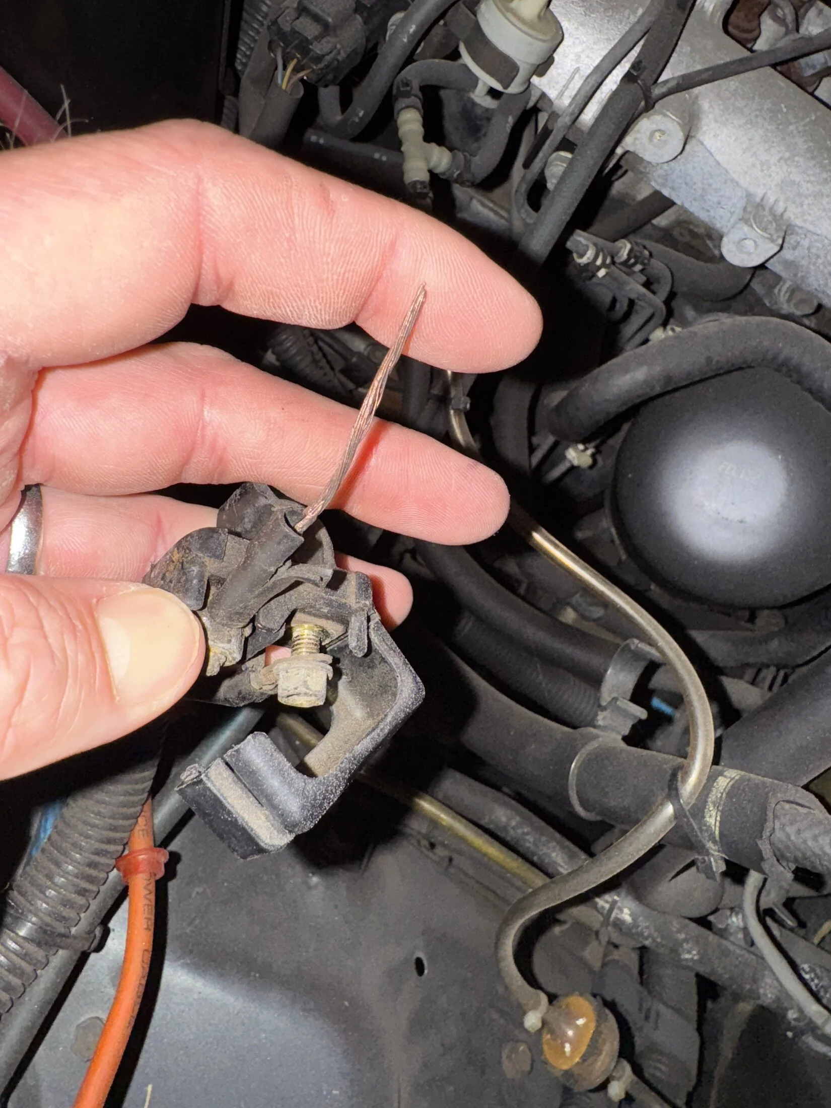

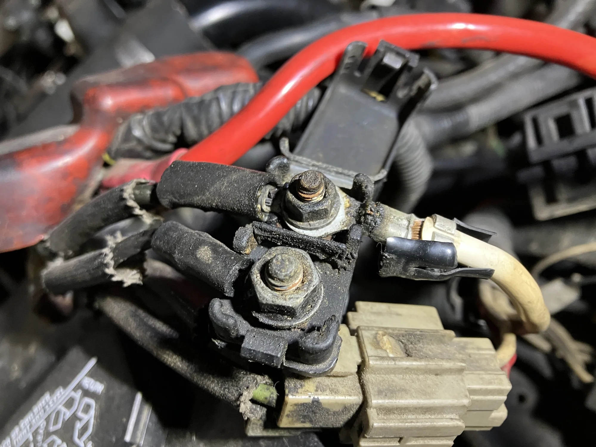

Ok so I shot for voltage and one of the 3 links wasn’t getting voltage, so I started to remove the links and found out that link was broken (did its job hopefully). Anyway, I google image searched the links and found an OEM replacement albeit for a different model cruiser…going to replace and see what happens. See pics below…

- i cannot make out any of the original color codes of your links wires , there badly puffed up and charred from sacrificing themselves for the greater
KCJ78 good ....:confused:
I have used ToyotaMatt's links - they are indistinguishable from OEM.
Just get him the colors off your current wires (both the ones going into that black round connector and the two going into the black square box) and he can recreate the original link.
Recommend buying two so you have a spare.

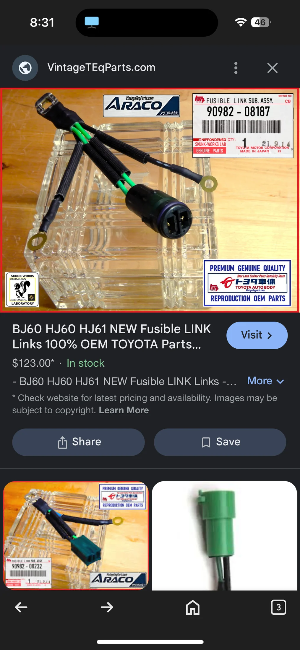

Hi Matt...i actually ordered the replacement links through VintageTeqParts...which apparently you work for or own? I purchased the parts a few weeks ago but haven't shipped yet, can i get your contact info to see what's going on with the order? I've emailed several times, no response that i've seen. Not upset, just trying to get a status on the part...
- so , .........

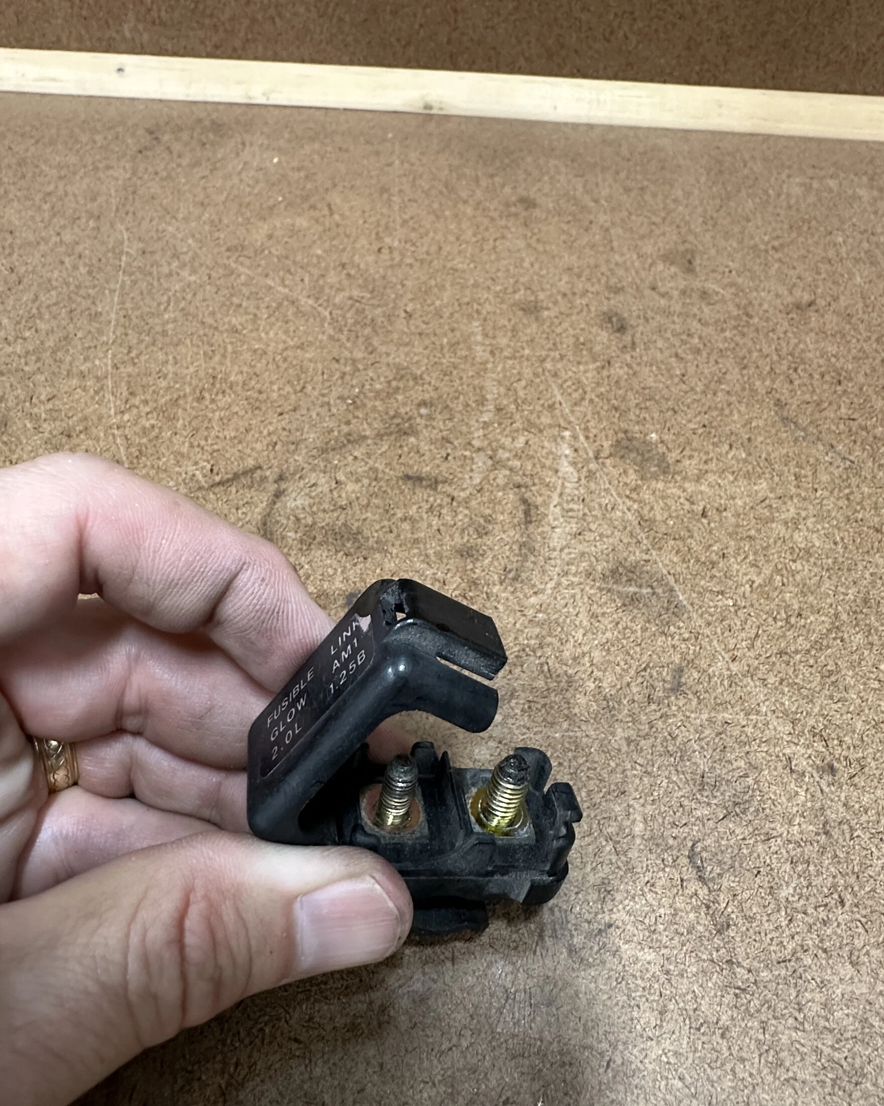

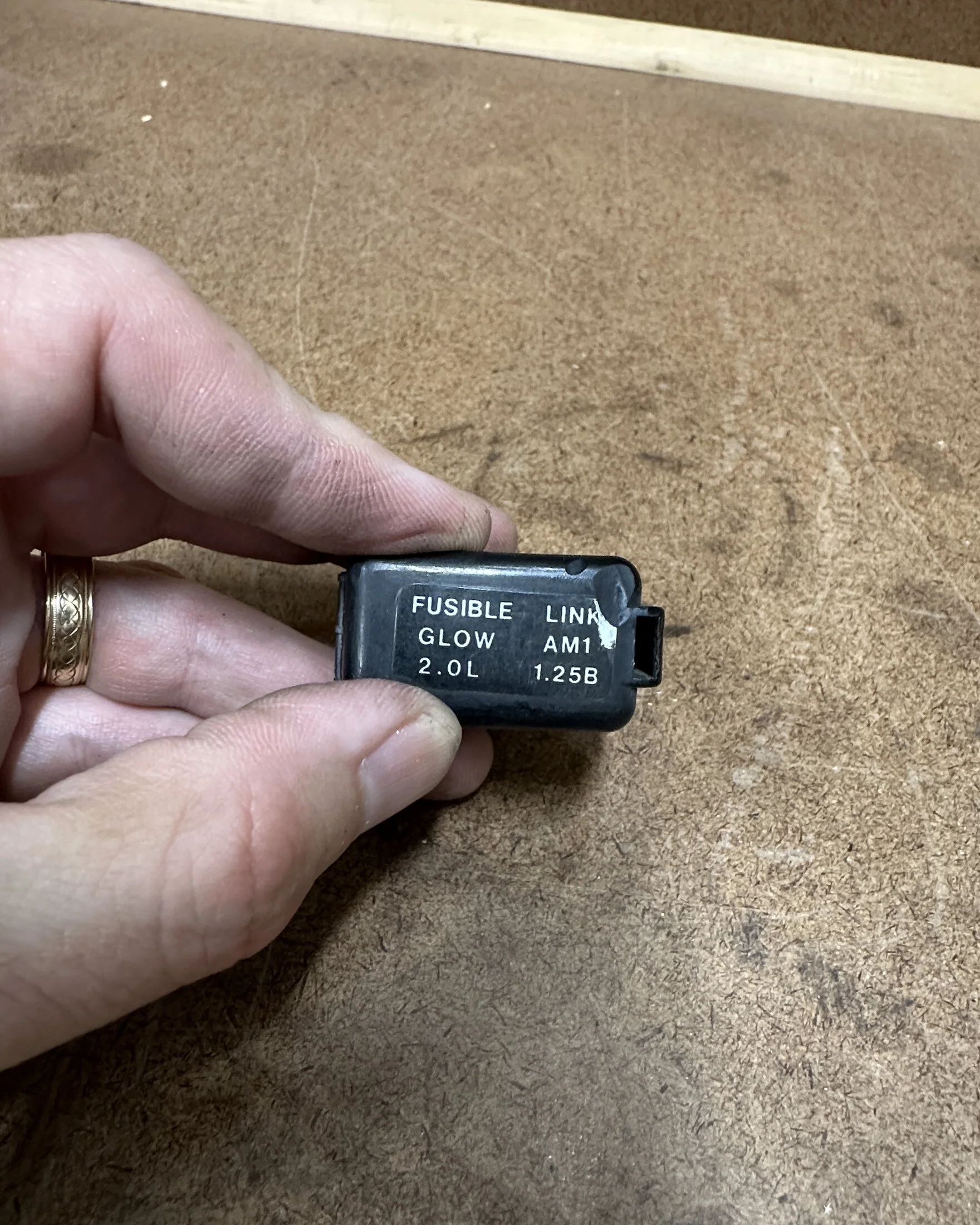

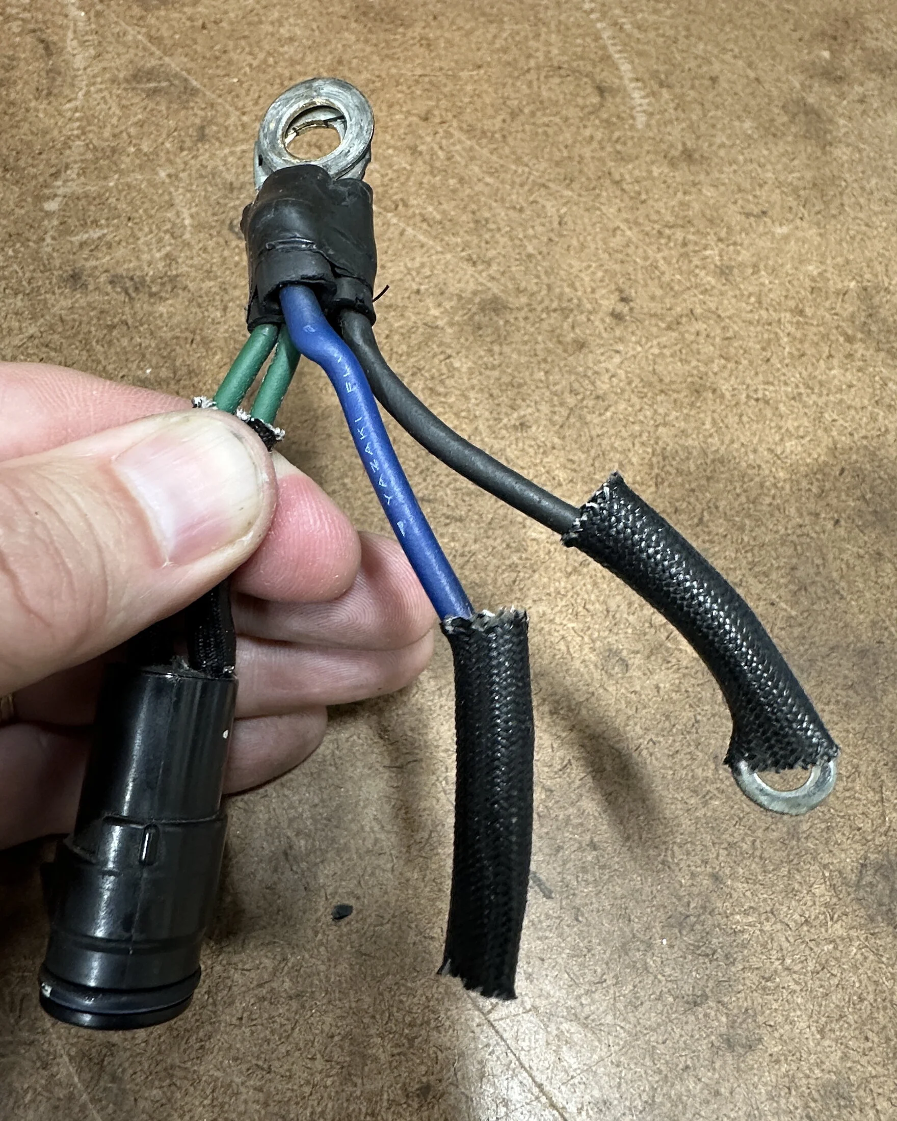

Here’s the fusible link off my ‘94 KZJ78.
View attachment 3887257 Here’s the fusible link off my ‘94 KZJ78.
Thanks !
excellent tech pics
only un-klear detail here is which color wire ring terminal goes on the larger and smaller male threaded studs on the black box above ?
it can and either one possibly , as it is on various other toyota and or land cruiser fusible links set up's
if you can show a photo below , i can'\t quite make out the black wire 1/2 ring exposed above ?
we never never guess or assume here in any way
always confirm and verify each and every day ... :wrench: :wrench: :wrench:
Black wire =
Blue wire =

Black wire =
Blue wire =
Blue goes to small ring terminal.
i am crafting this up real time live , ill post my completed work here on this now confirmed and verified KZJ78 Fusible links assy.
this is one i have never reproduced before , it will be a New addition with its also confirmed and verified original TOYOTA part # too
Thanks for the help on this ! :wrench: :wrench: :wrench: :)
