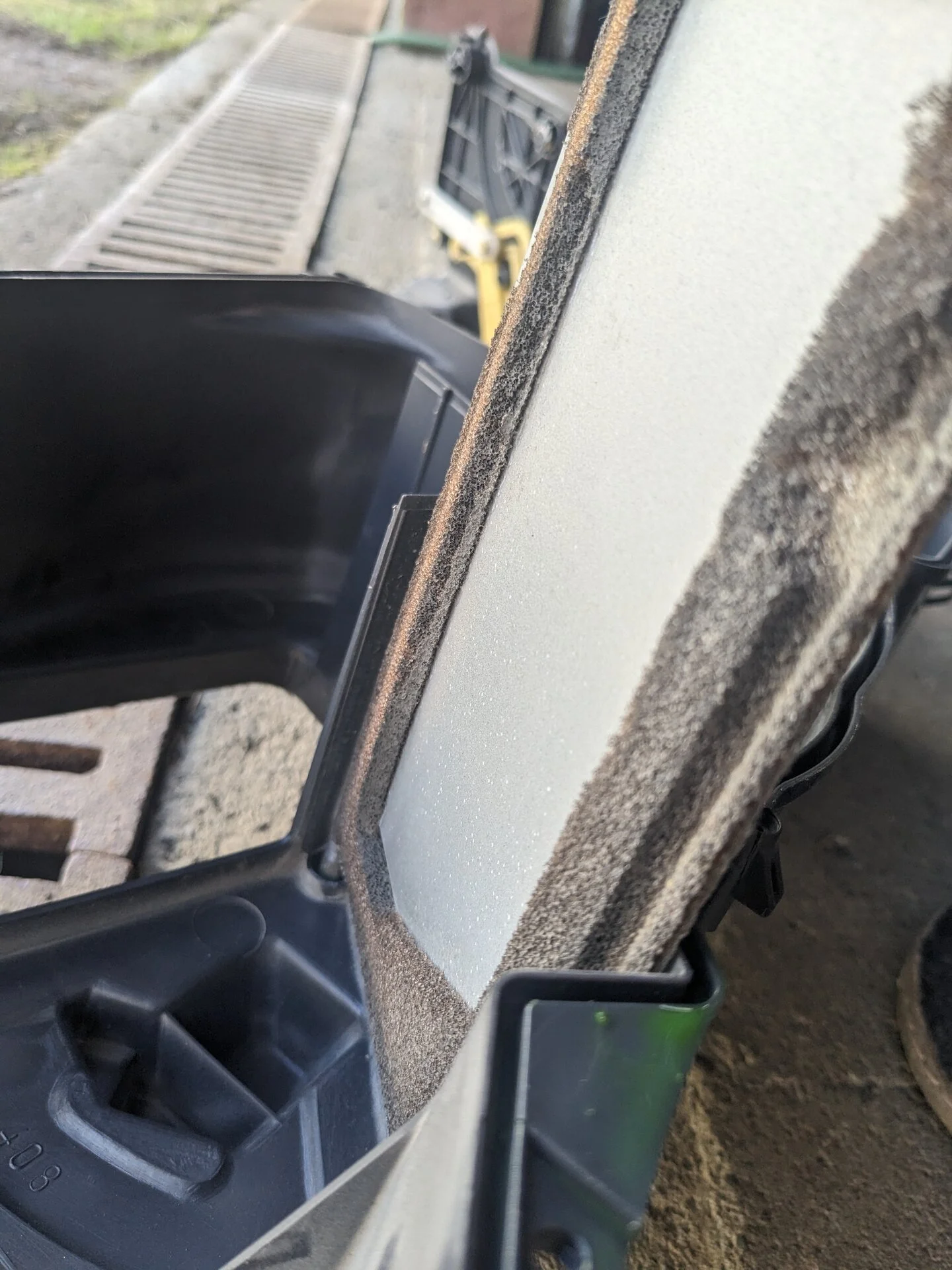

While taking my dash apart it became apparent very quickly about what was going on with my HVAC system. Firstly the foam which seals the various dampers in the HVAC system has turned to powder. Literally. You touch it and it turns to dust. So none of the dampers had been sealing. The fresh air/recirc damper wouldn't seal, the cold/hot damper was not sealing... Etc etc. So, I took all of the powdered foam off, ground off the adhesive with a brass wheel, painted the surfaces to stop surface rust and applied rubberized HVAC adhesive foam in 8mm thickness matching the old application...

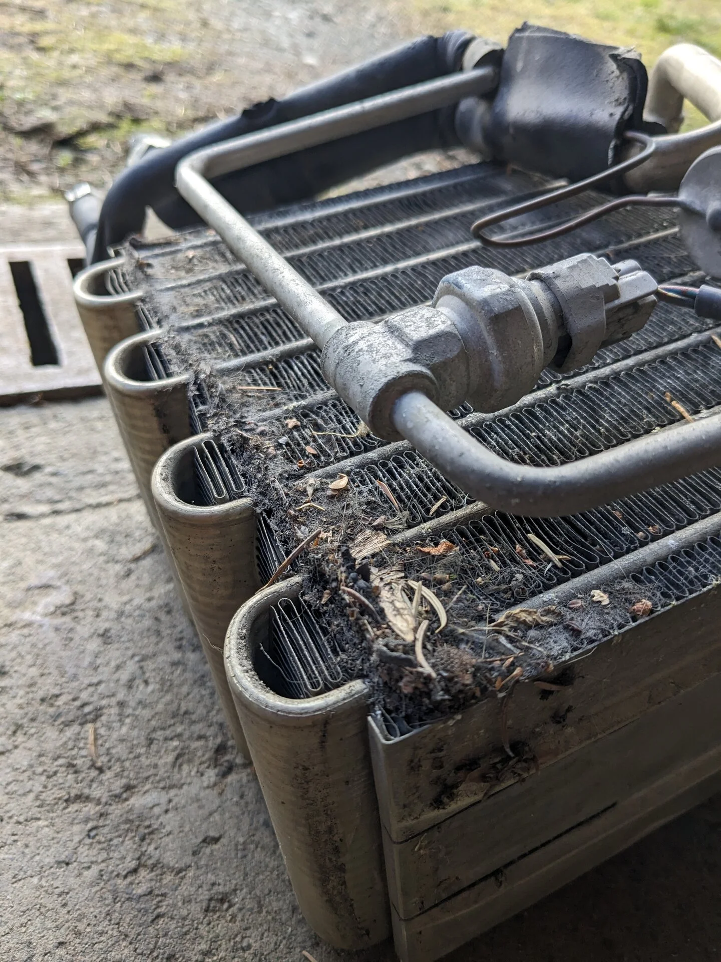

But. PSA here, there appears to be no prefilter, other than the squirrel fan and HVAC evaporator. There was literally half an inch of debris and detritus on top of the evap coil which had completely killed airflow. It was amazing any air was getting through at all. So I separated the clam shell protecting the coil and cleaned it out with a foaming HVAC coil cleaner and flushed thoroughly with water. Couldn't get it perfectly clean but it's waaaay better. Put everything back together. With the new foam dampers and the clean coil and heater core this thing blows heat like a brand new vehicle. It's actually remarkable. It also explains why my fan died as it was trying to force air through a brick.
