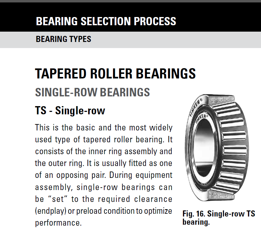

Every bearing distributor in the country can ship these bearings next day. You can buy the cups and cones as as set, or individually; that's important to know, because some distributors list them one way, and some the other. Though you "should" replace them as a set, many industrial users don't, and that's why some distributors list the parts separately.Works for me. I’ll just call in the morning and get a kit on the way. Far easier than tracking down numbers and piecing stuff out.

It's not just wheel bearings, all bearings are listed that way. And, FWIW, the bearing doesn't know where it goes, and the bearing distributor doesn't care.For sure.

@Malleus Thanks for the info. Good to know about the Timkens, at least the ones I’d be using anyway. My issue is always finding which ones (part number.) I have definitely noticed it varies on whether they come complete with races or not. Seems odd for wheel bearings, but what do I know.

Wow, thanks again. All good info, and the charts are great. I hope those are in a FAQ somewhere on here.It's not just wheel bearings, all bearings are listed that way. And, FWIW, the bearing doesn't know where it goes, and the bearing distributor doesn't care.
The wheel bearings Toyota used on the 80 series were developed by Timken especially for that general automotive application. It's used in a lot of vehicles, in various sizes.
I use ppg 154-155 from the Timken engineering manual when I change out wheel bearings, just to make sure the spindles and hubs aren't out of spec. Generally it shouldn't be a problem with the spindles, since the bearings are slip fit there, but the housings can be damaged (even by someone who knows what they're doing) when the cones are driven out or pressed in, so it's good to check, if for no other reason than piece of mind.
I'll put them in the Resources section, when I get a chance. One of the moderators would have to put it in the FAQ section.Wow, thanks again. All good info, and the charts are great. I hope those are in a FAQ somewhere on here.
