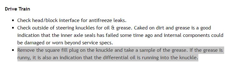

I bought an 03 LX with ~150k miles that I have been trying to get caught up on preventative maintenance. I am aware of needing to repack the bearings and push grease through the spindle bushing with a tool similar to the Slee tool. I noticed a line on Slee's FAQ for newbies that it talks about a square fill plug and grease in the knuckle.
Is this another grease point I am missing?
Does this fill plug allow you to assess the grease for the spindle bushing?
How on Earth would diff oil make it to the knuckle?
Looks like you have an 80 series and below manual.
It's on the 100 section on Slee's website. If it is for an 80 series that would explain my confusion.

As said above, that plug is on the 80 and earlier series solid front axle trucks.
