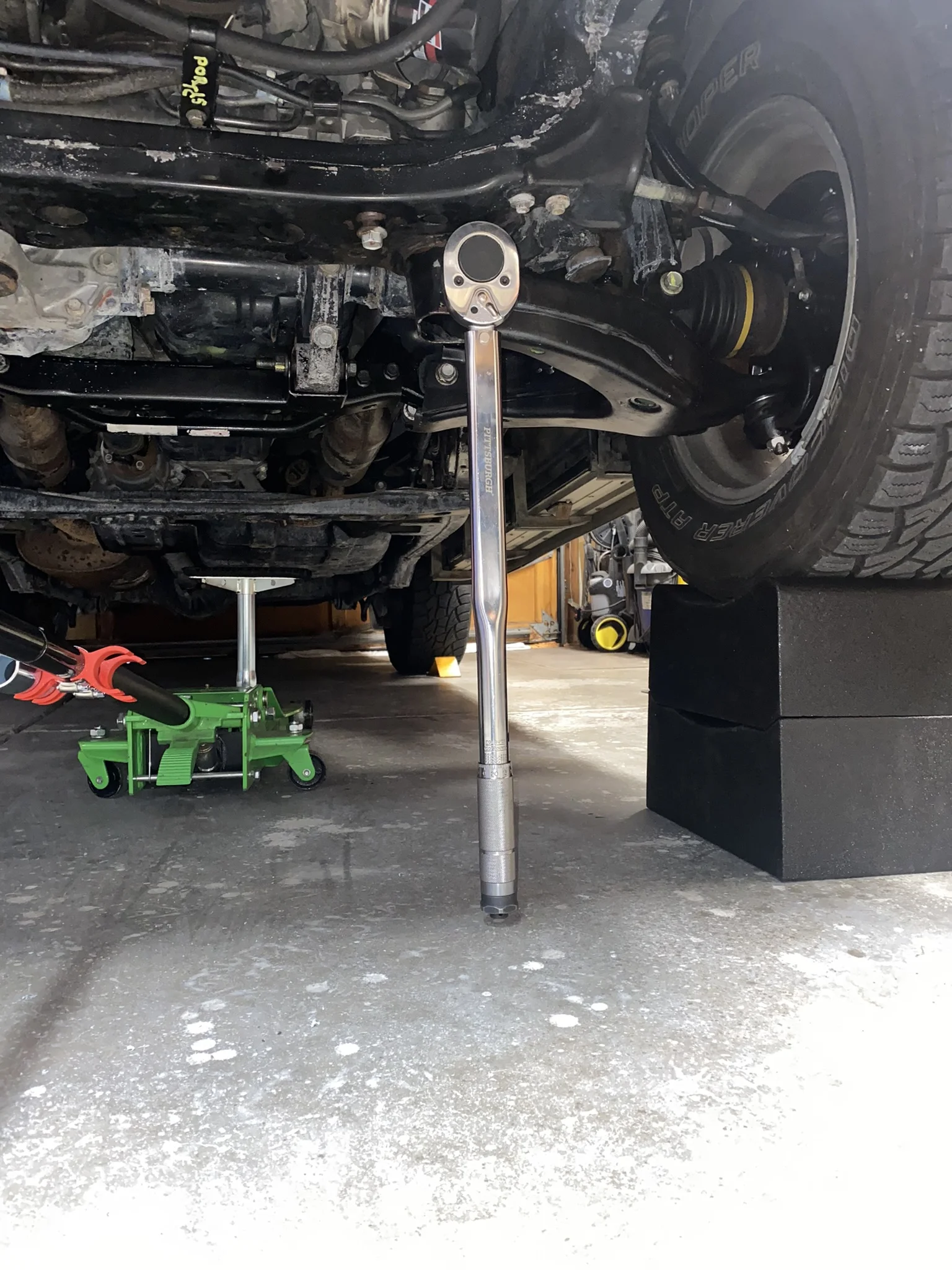

For the DIY or shops without roll on rack. LCA bolts is a real PITA. Some just measure neutral position of LCA & UCA. Then place them, into a that neutral position to torque. Which I suppose is okay. But best is, with weight of vehicle on rubber bushing. To get, the most life out of them.
I use special spacer under my tires. These allow me get full swing on my 1/2" or even 3/4" torque wrench for the LCA.
Some will have issue with rear (#2) bushing bolt of LCA. They can't keep the bolt from spinning, with T-bar bracket on. I've two ways to hold the bolt. First was, I just place a crowbar on bolt head, from below. I've now have, a slim open-end wrench, fit on from above onto bolt head behind T-bar bracket.
Others argue. It's the bolt head, we must have torque wrench on. Not the 4 point serrated nut. I feel it's better have T-bar fully cranked to neutral stance. I also let the FSM be my guide. Which show torque at nut. I'd also point to other nut with even more serrations, like fan clutch 24 point.
