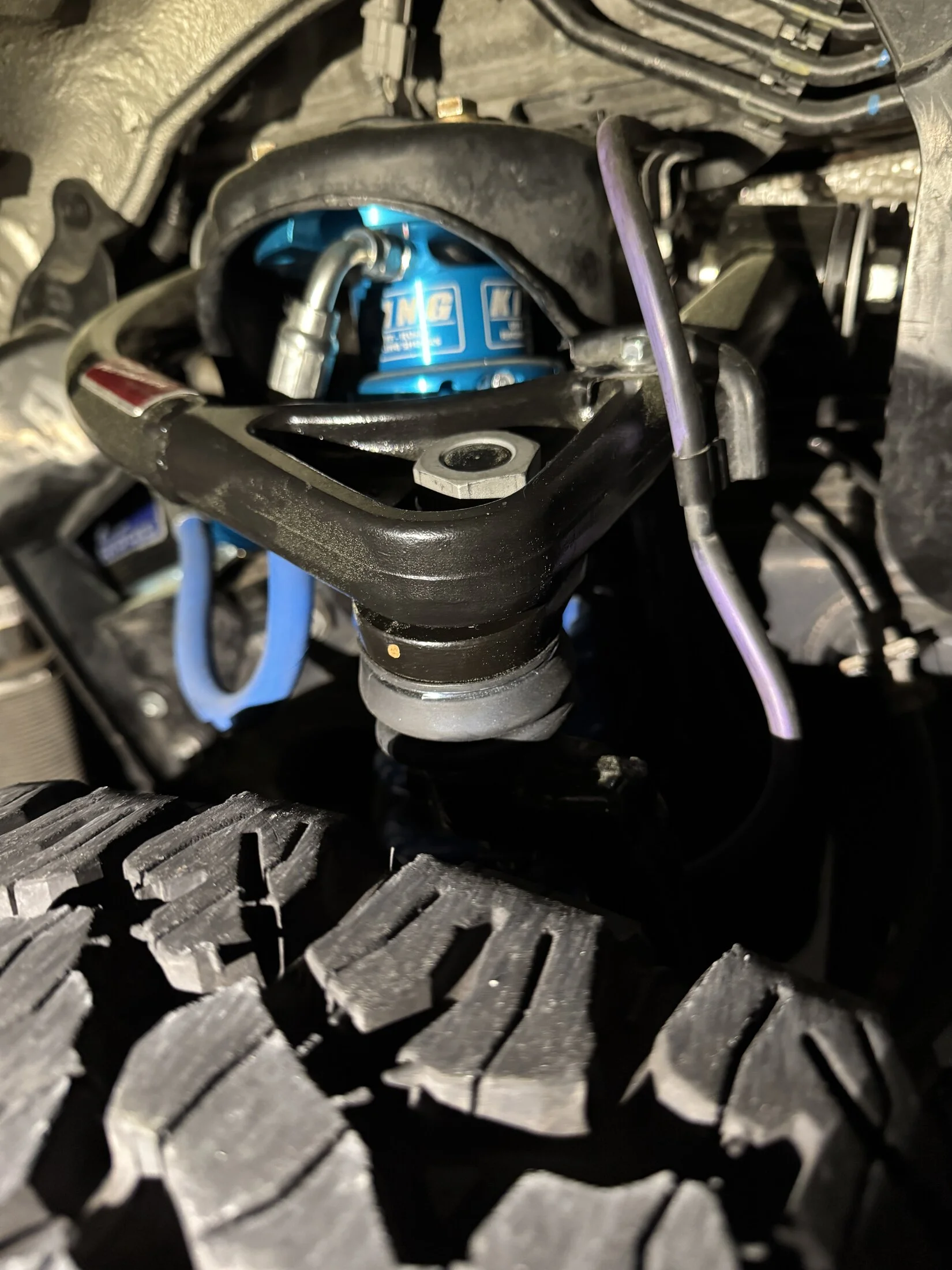

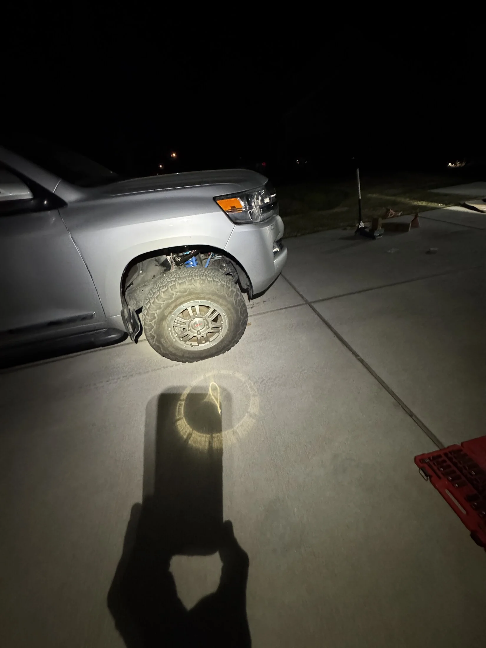

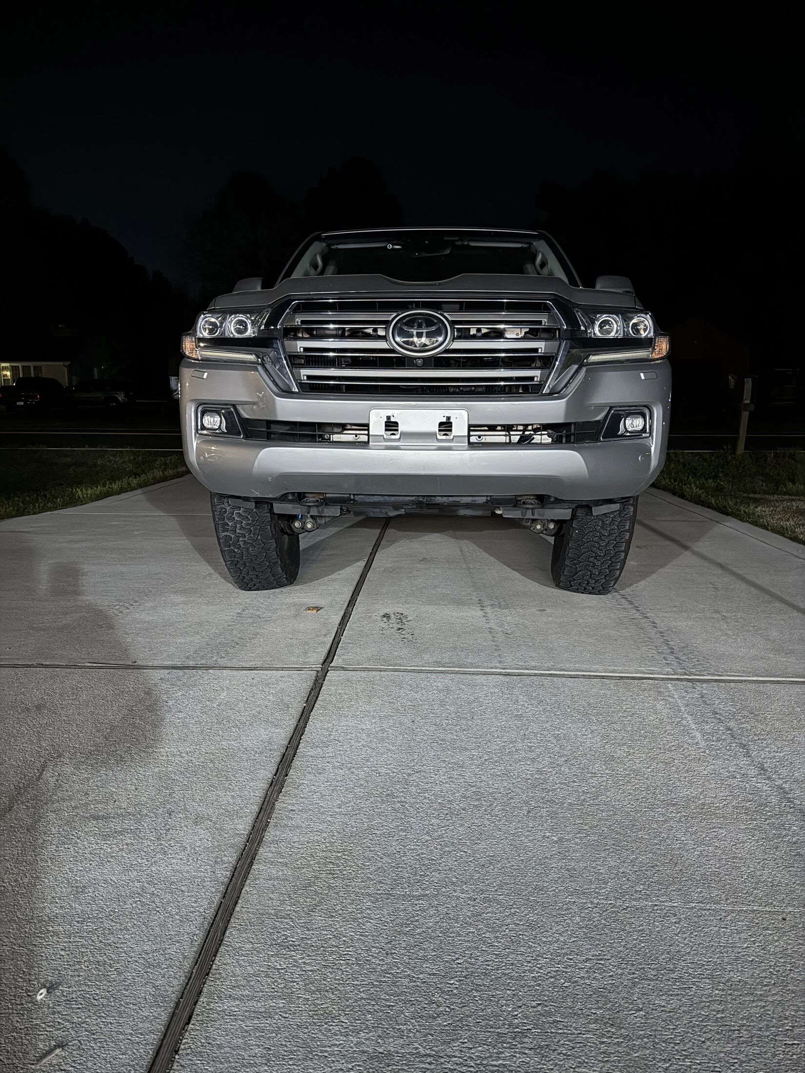

so I decided to lift my LC, 2.5 king all around with 700 pounds spring front , 400 arb spring rear, SPC UCA. I have lift numerous Toyota and I have never have one sooooooo out alignment to the point I don't think I can drive this thing to the dealer to alignment. the 700 spring is for an arb bumper with winch that is getting paint it now. the 400 rear spring is for a roof rack and RTT.

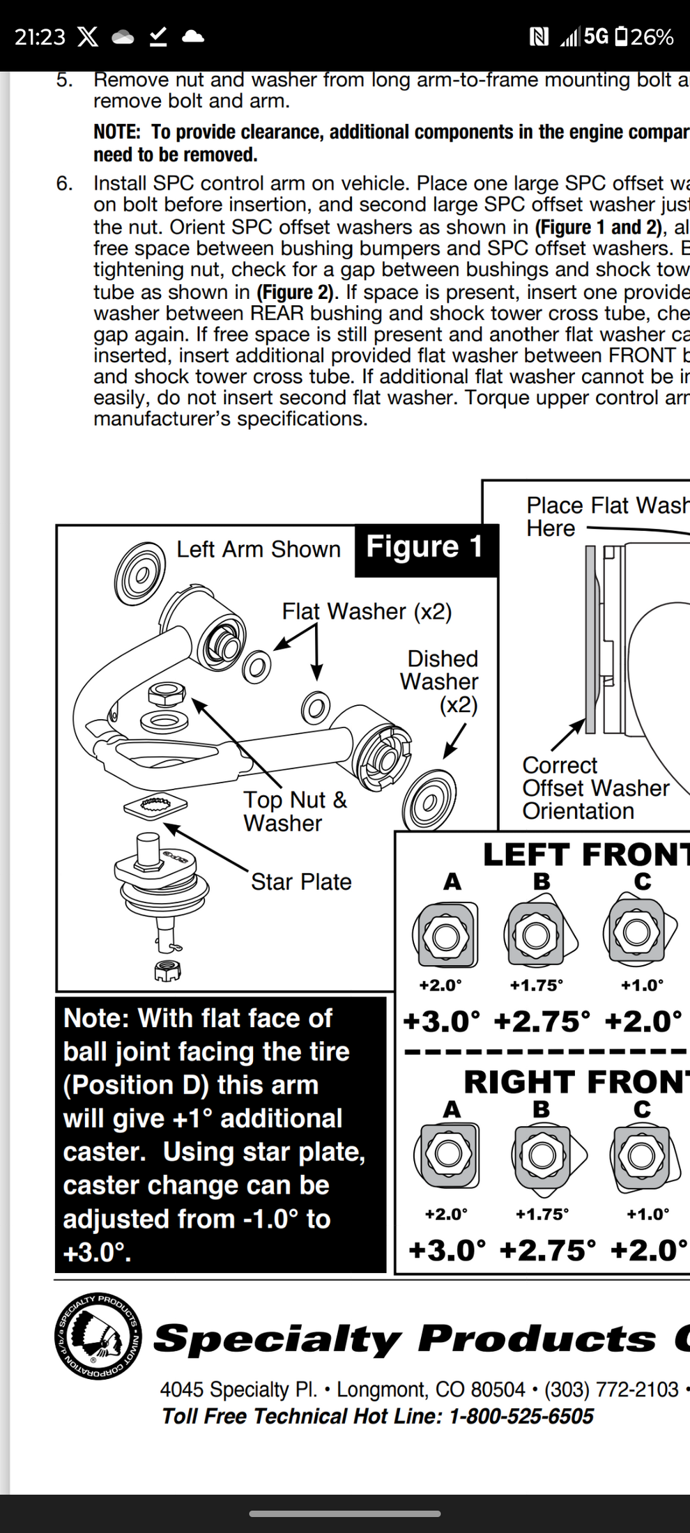

Tundra UCAs?
oh s***!!! im a ****ing Idiot I got the ball going wrong. thank you so much!!!!!!!
Normally i would poke fun and banter you...
However, i did the exact same thing on my Tundra with the SPC UCAs
