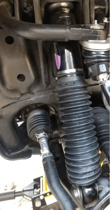

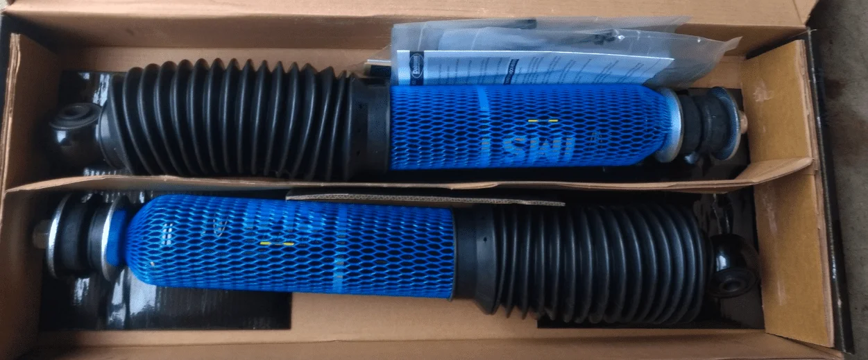

I've been happy with the Dobinsons IMS (internal floating piston) shocks. I think the boots and lower mounting covering were designed to protect from rock chips.
