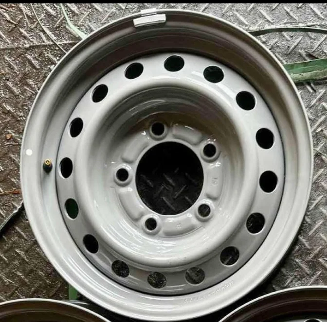

Was wondering if this has been done. Planning to purchase a set that came off from a 70 series.
Question are:
1. will this be bolt on? No grinding needed?
2. Do I need to change my lug nuts when I change to steelies?
3. Will be using my existing tires which 265/75/16, will there be rubbing issues? Height is currently stock.

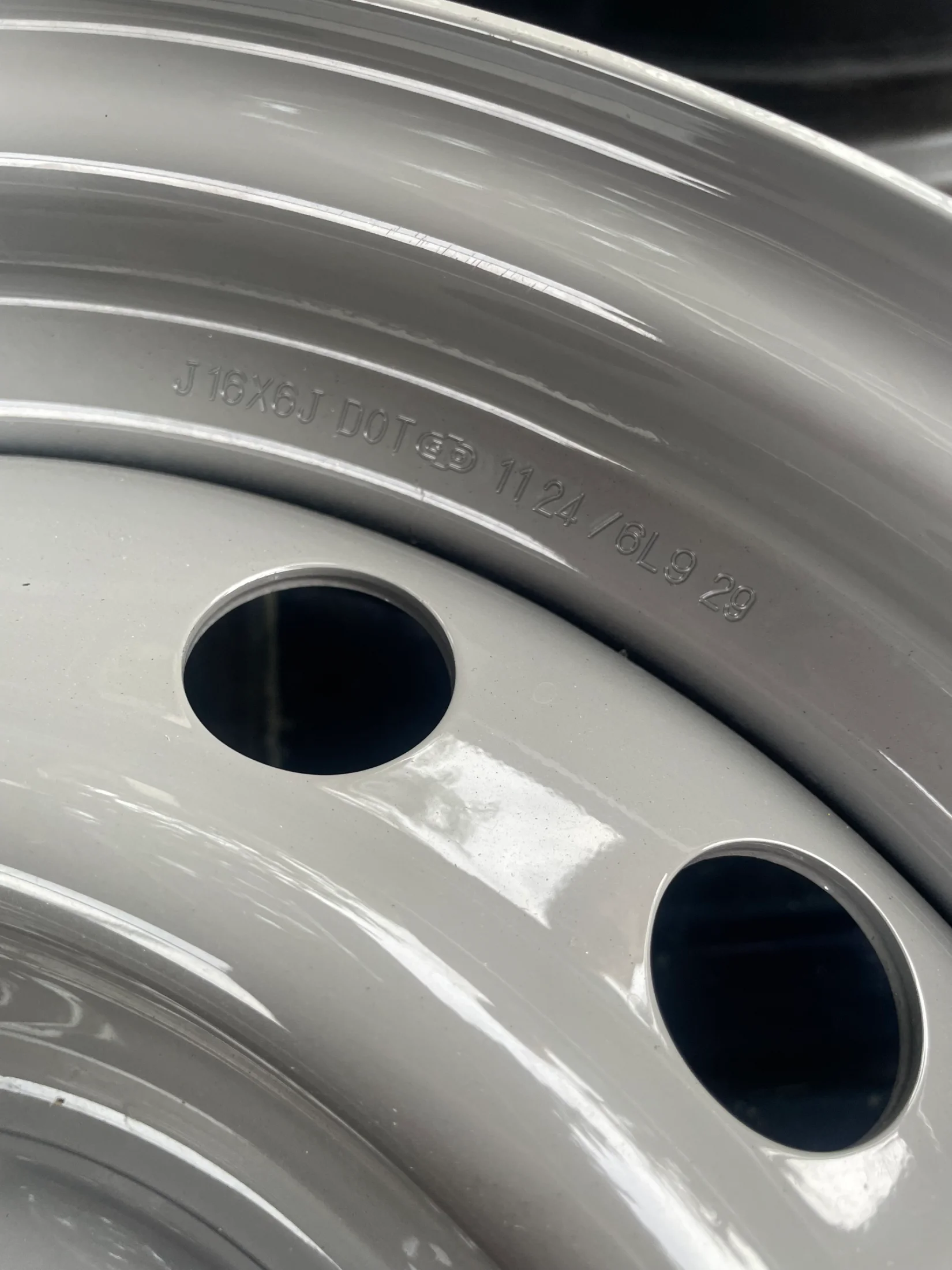

Just an update. Tried fitting the steelies. no clearance on the center hub(if that's what you call it 😅) and it seems that the back part of the rim is hitting the brake caliper which restricts the wheel from turning. is this safe? btw, my rig is an HDJ100 with IFS suspension.
Do the wheels fit the rear axle/hub? Is there a part number on the wheel? Are there balancing weights on the wheel that might be in contact with the caliper? Are the calipers aftermarket?

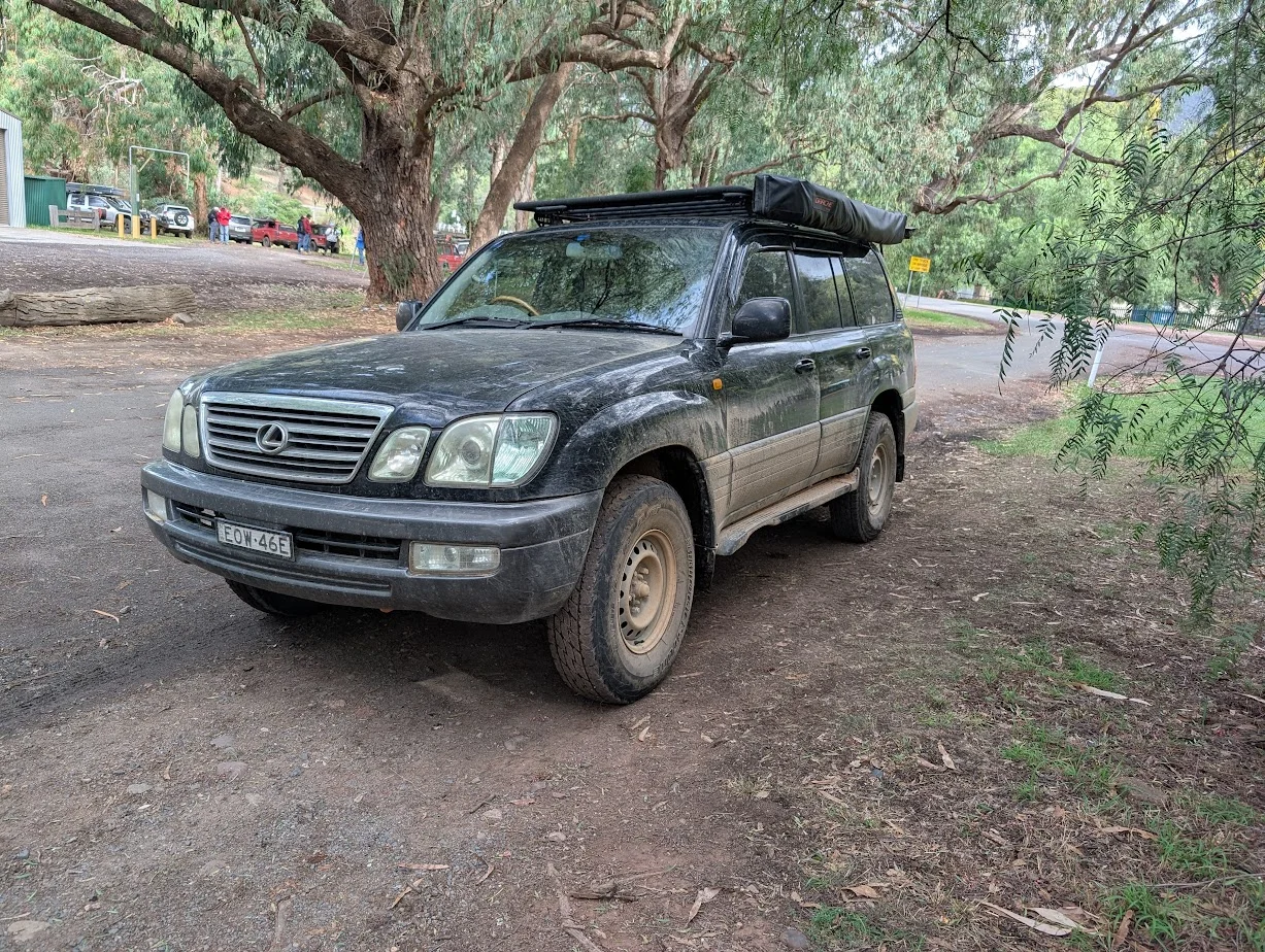

Or collect a few Tundra spares. They fit just fine, and look the same.
I love steelies.
