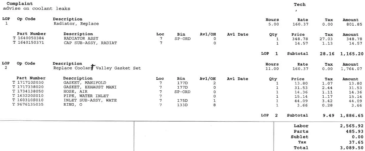

As a data point. here is an estimate from a local Toyota dealer to perform the cooling system work. They are charging 11 hours of labor for the coolant leak and 5 hours to replace the radiator.

I just had this job done and within 3 weeks its leaking coolant again and now I also have a new exhaust noise after the truck warms up. I thought the exhaust manifold area leak was a coincidence but now understand probably not when I see all of what is involved with the heat exchanger plate removal. Is 11 hours labor correct for the heat exchanger reseal? I have seen numbers all over the place for the job.
I have no idea what the book schedule says for this but from reading on here and poking around on my truck I believe the intake manifold is actually pretty easy/quick to remove. Which is the main thing in the way.
But, it LOOKS like a ton of work.. and the job can probably be sold to vehicle owners that way.. which might explain the big difference in quotes.
It doesn’t help you at all but my wild ass guess is I could get it done in a half day in my driveway assuming no issues come up.
I was able to do it in less than 11 hours. It is a real pain in the ass though. Having small hands will make a huge difference. I spent several hours on 4 bolts in the back on the SAIS valve pipes. Little hands would have cut that time to under an hour.
