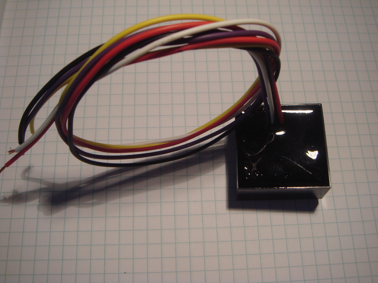

Hewitt Tech. It’s a relay/plug and play option to completely prevent the system from running again.

No. There is no removal of anything. It renders the system inoperable and it physically remains in place.

It can remain in place if you choose, but it can also be removed (almost) completely.
You buy the Hewitt Gen 2 bypass kit, plus 2 of their pressure sensor options. Not super cheap, but this allows you to remove the electronic drivers on the driver side fender, air pumps in the passenger front fender well, associated piping in the engine bay, and both of the valves behind the intake. Hewitt provides slip-in block off plates for the exhaust piping, but they require the valve-side piping flanges (they're part of the valve assembly) to remain in place (the block off plates sandwich between flanges). To totally remove the valve assemblies you have to have block off plates cut out that don't require the other flange to be there. Feels good not to have to worry about being stranded/disabled by a trivial system that provides no useful benefit.
