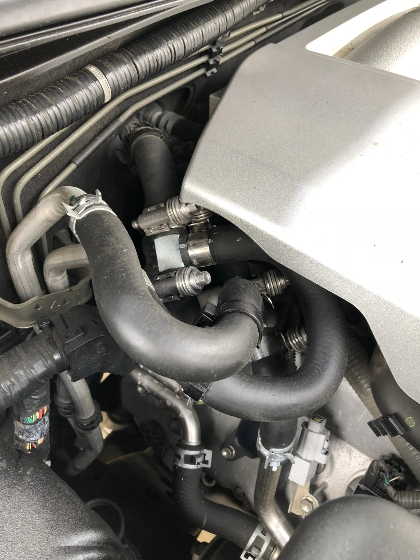

I can’t find it anywhere unfortunately. I put the car up, looked everywhere, nothing.
Oddly enough it only started leaking when we ran the heater.

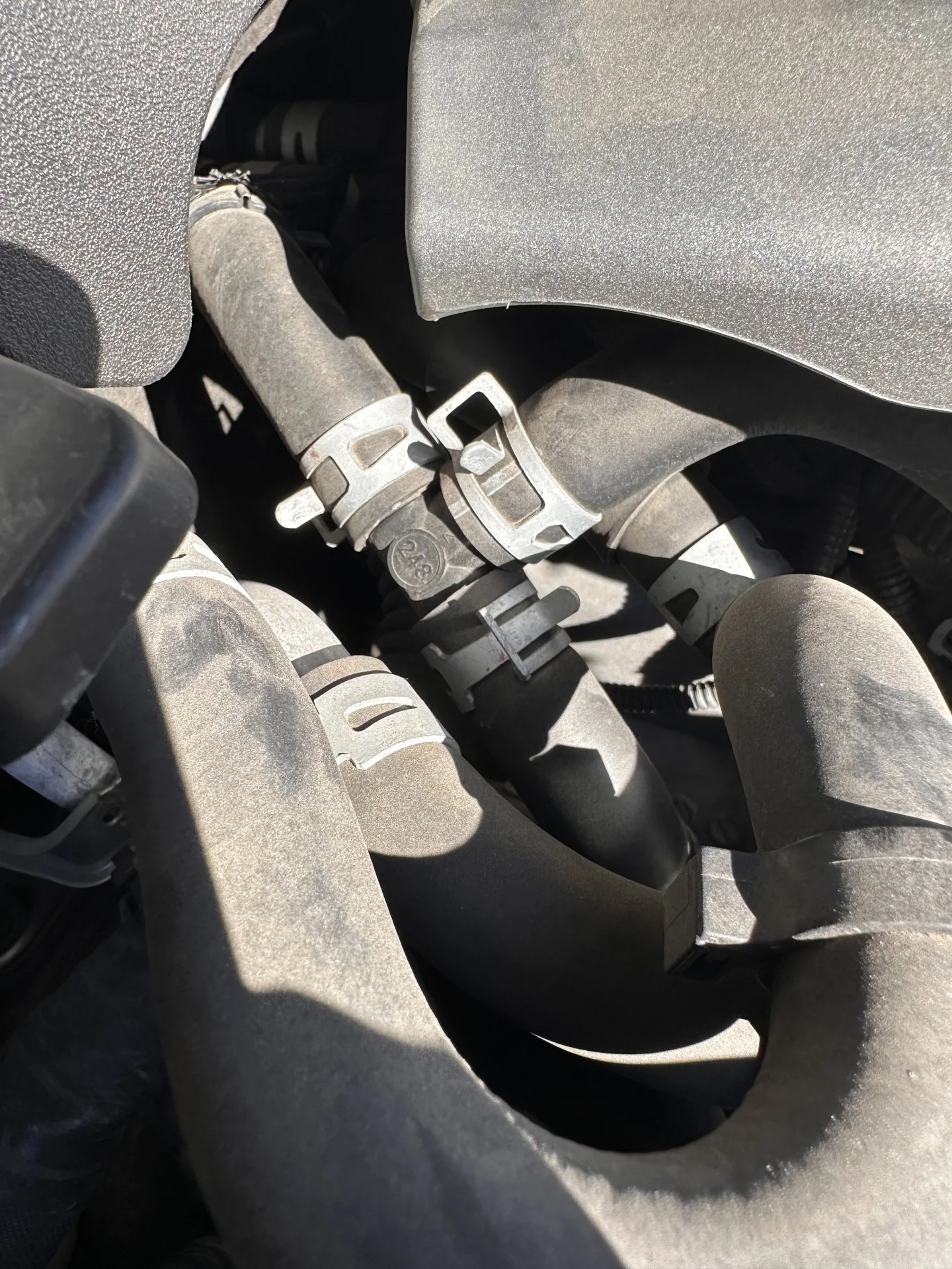

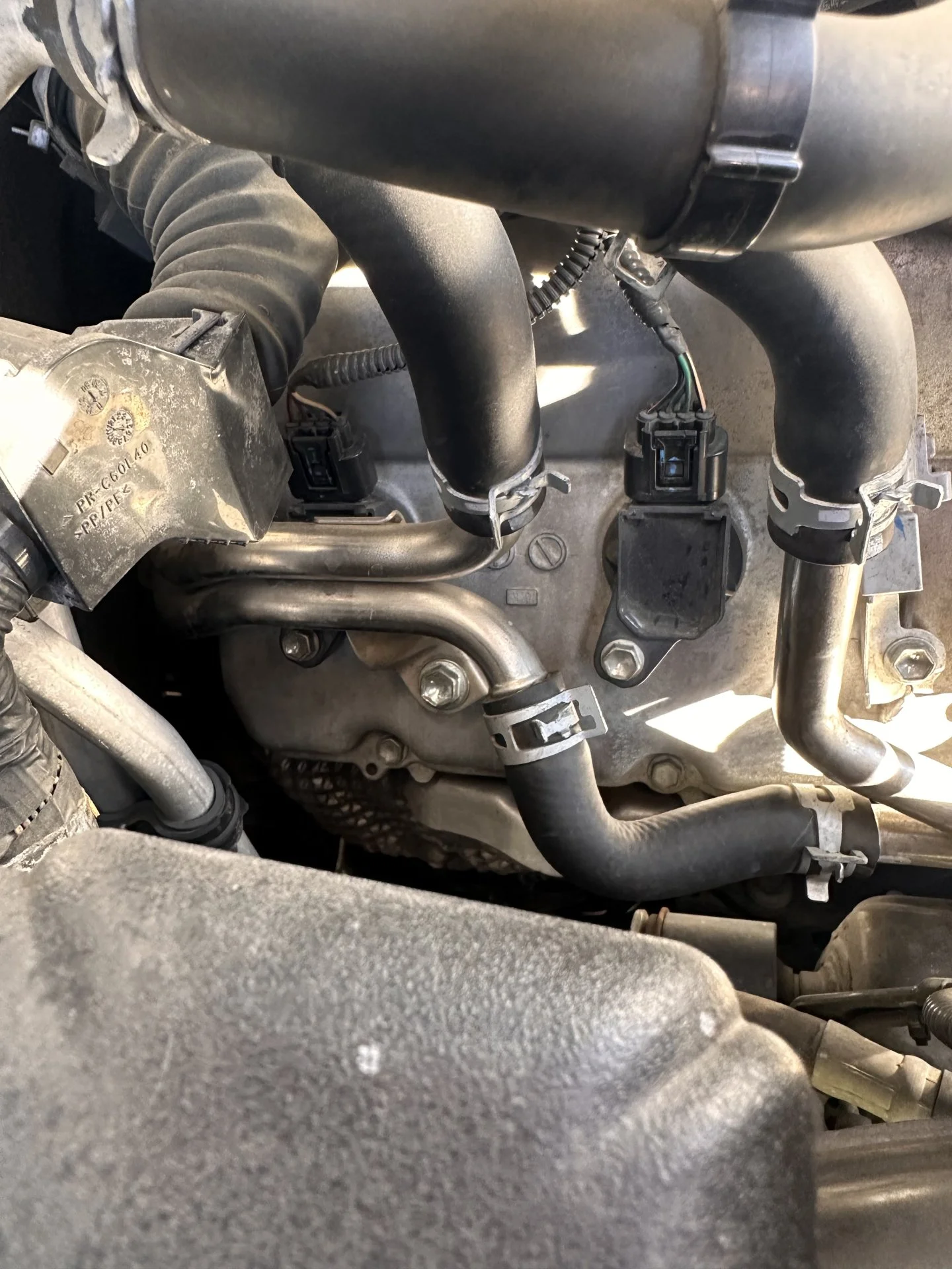

You checked the heater tees? Those things get crumbley at high miles.
Where would that be on the 200 series?
Below that area of heater lines. Any indication this is coming off rear bell housing area or around the transmission?
Would this leaking be a good indicator why the leak only happened when running the heater for the first time or does the name not indicate relations?
Possibly. Start the engine and watch that area as it warms up. Run the heater.

Looking at your picture again that is fairly far forward on the passenger side of engine.

Could be leaking out of the radiator hose as well

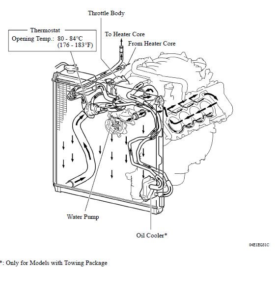

3ur-fe-engine-water-circuit-3d-jpg.370744
That’s what I’m wondering. I might try and take the plate off today if I can scrounge up tools or make the tools in the tool kit work - stinks to be 1000 miles away from home right now. Just to see if there is something I could tape up to get us home. The previous owner, who I just bought this from 1500 miles ago, just has the water pump done. Since it wasn’t leaking but needed coolant once, I was hoping it was just air in the lines. Radiator stays full through all of this though.
