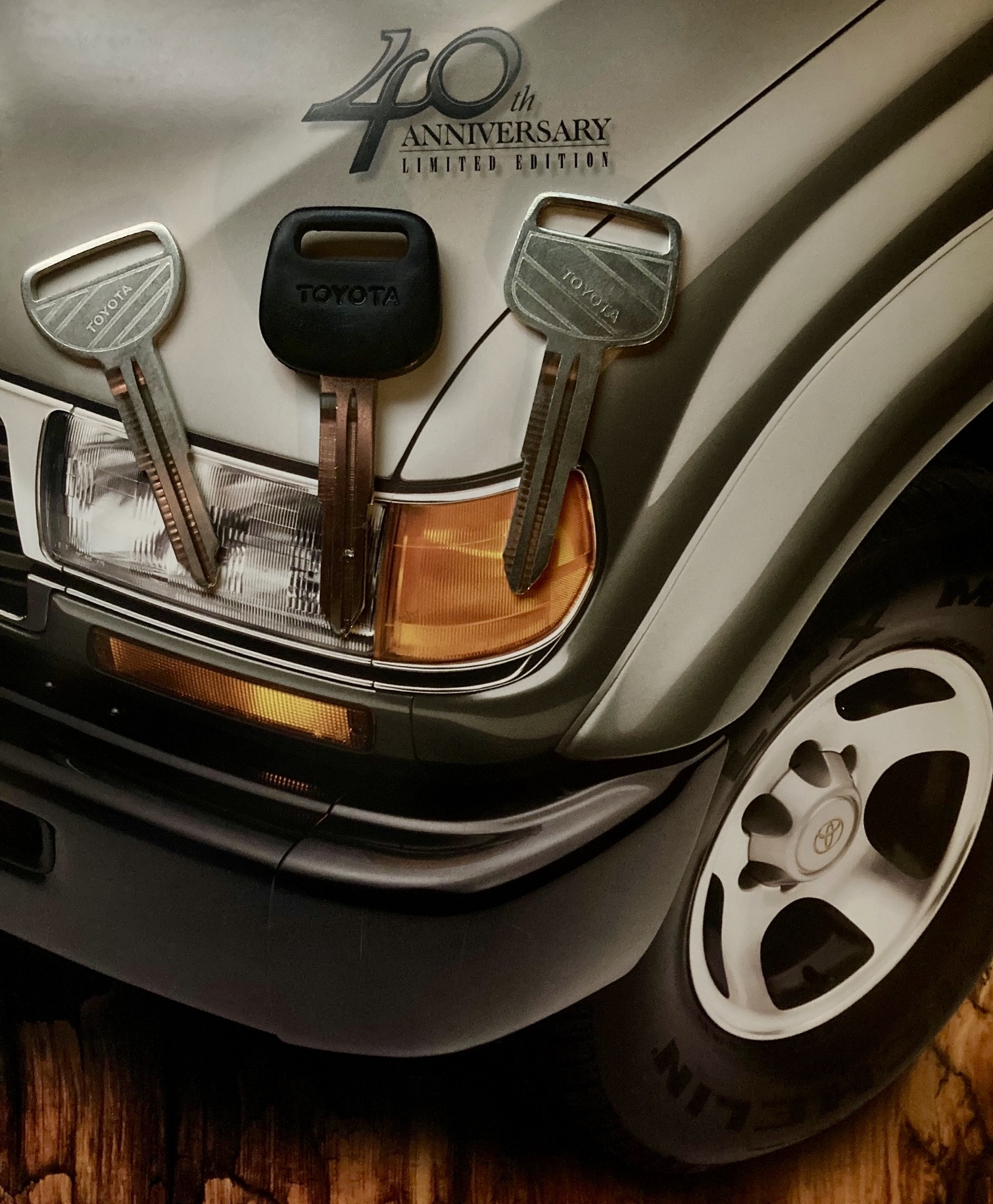

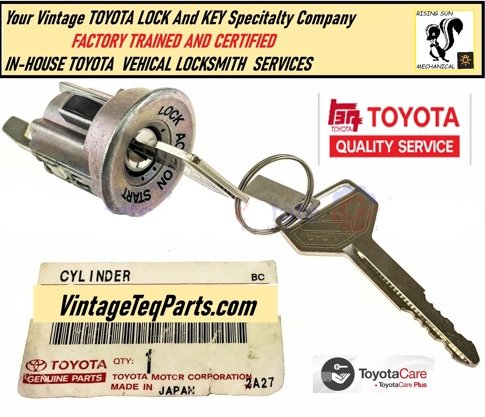

getting 1 new OEM CODE CUT Key ........
and trying this approach may work ?
if your current keys are worn out and smoked like most are these days ?
i CAN make that happen ,. path of least resistance
however , i have seen a thread where this internal SQUARE SHAFT small part fails ?
sorry for the vague TECH. description here , maybe some one else can chime in on that topic ?
all i need is your W- Series factory code to ROCK and ROLL out a OEM PLANT A-11 specimen asap .... :cool:

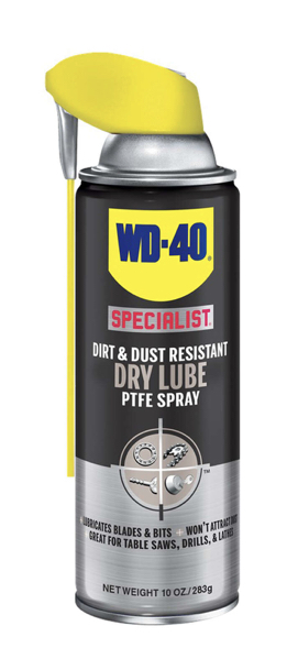

The cylinders are gunked up and some of the tumblers inside are likely worn.
Step 1: Spray dry lube in and work them with the key, then spray more dry lube, then repeat. Do NOT put any grease or oil-based lube in - it will make the problem worse. You want a lube that is PTFE-based. I like this:
Step 2: Pull the passenger front door panel and get the key code off the cylinder. Then take that code and have 2 new keys cut based on the code. Do NOT cut more copy keys of what you already have. Odds are all those keys are just copies of an already worn key.
Step 3: If you worked the dry lube in the cylinders and got a new key cut from the code but you’re still having problems, then you’ll need to pull the offending cylinders and rebuild them using this kit:
It’s surprisingly pretty easy to rebuild the ignition and lock cylinders. Can easily do all of them in a day.

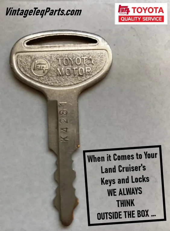

You have a handy link to getting the PS cylinder out to see the number? Had the DS out once, but that was years ago. Would be nice to know whether that's gonna fix the problem, though. Anything else it could be, other than a worn-down key?
i do not have any instructions , sorry
the 80 series FSM will though , BODY and Chassis
- When in comes to your 80 Series Land Cruiser's KEYS and LOCK's you ALWAYS have to think outside the TEq BOX ............

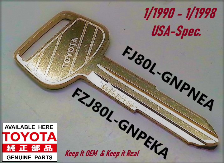

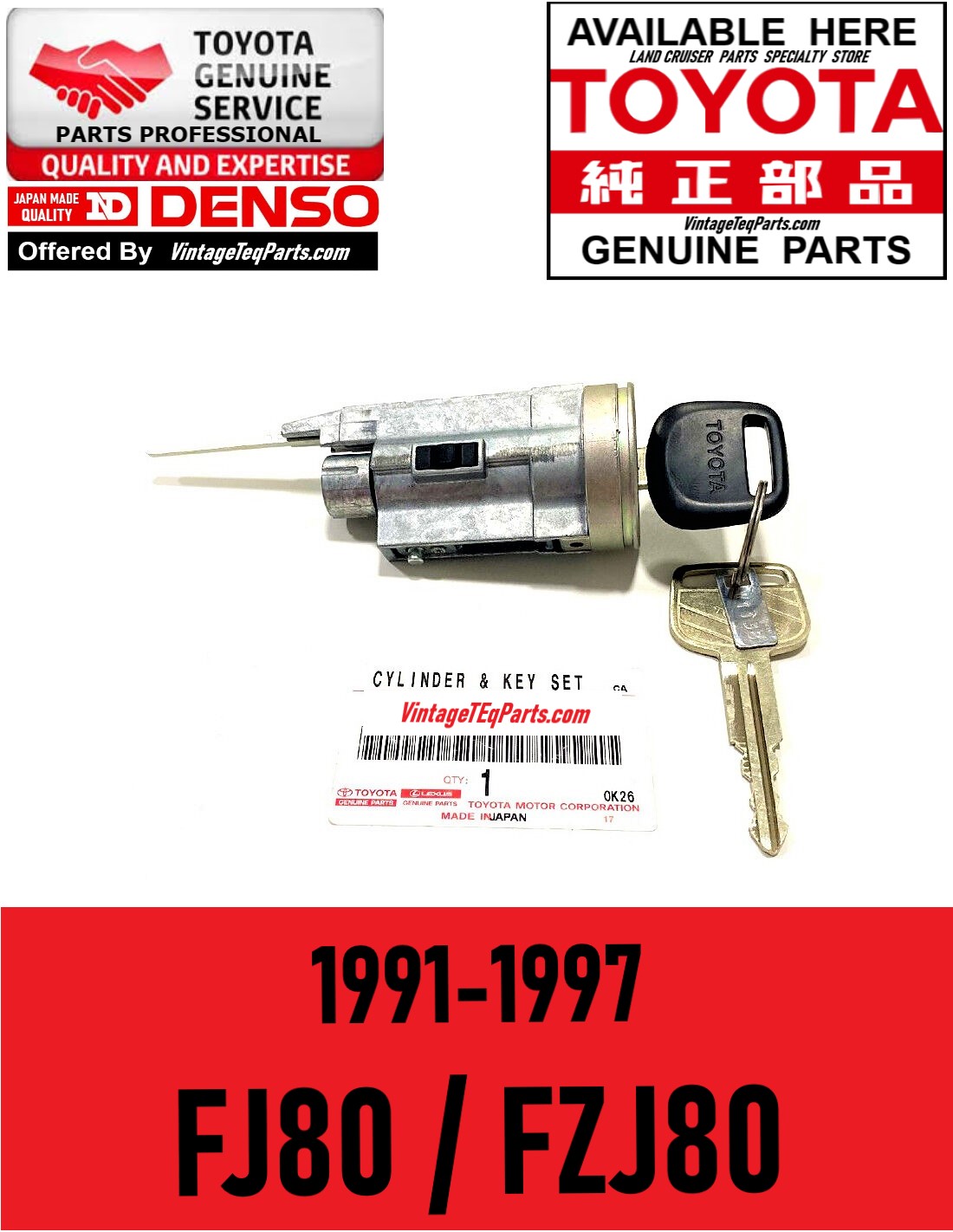

Go to the dealer get 2 made you will be so surprised how a new key works from them
i am his Factory Toyota Certified and Trained T-TEN Master Technician Lock and Key Specialist UNICORN Dealer Concierge Service ...........
- go to THEM , and you get the aftermarket screw-job :rolleyes:

When I get mine from the dealership, they only need the VIN and they cut a nice clean new Toyota key, have no idea what you are suggesting but I have no problems
