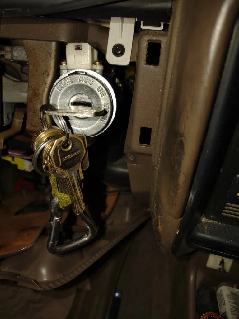

Drove about an hour on the highway and made 2 stops, shut off just fine at each stop.
I was unloading stuff and noticed the dash lights and buzzer as if the key was still in the ignition.
Figured I'd just start it and turn it back off.....
Was able to turn key to off position and remove it multiple times and the engine kept running.
DC'd the battery and the engine kept running.

In the future you could probably pull a fuse or so, but does sound like an ignition switch situation.
mine did a similar thing many years back and it was the starter solenoid that was the cause. I think when iits bridged it also applied power to the ecu through the signal wire and kept the thing running. I disconnected the battery and it kept running but didnt stop until I whacked the starter with an axe
Generally when the starter contacts become welded together the starter continues to run also, but if it's just the engine
running with the key removed it's likely something else.
@Cluelessmedic : Does the key when put into the ignition cylinder feel like there's no spring-back when you turn it to the ON position and release??
ie: does it turn loosely left and right like there's no stops, return, no resistance??
If so then the tip of a rod inside the ignition cylinder may have snapped off.

There was no lack of resistance or spring tension with the ignition.
I started it up this morning and it fired right up, idled a little rough for a minute and has been fine since. (I did not attempt to start it after it happened since I was working)
I was able to turn it off and on as normal and haven't been able to re-create the issue
