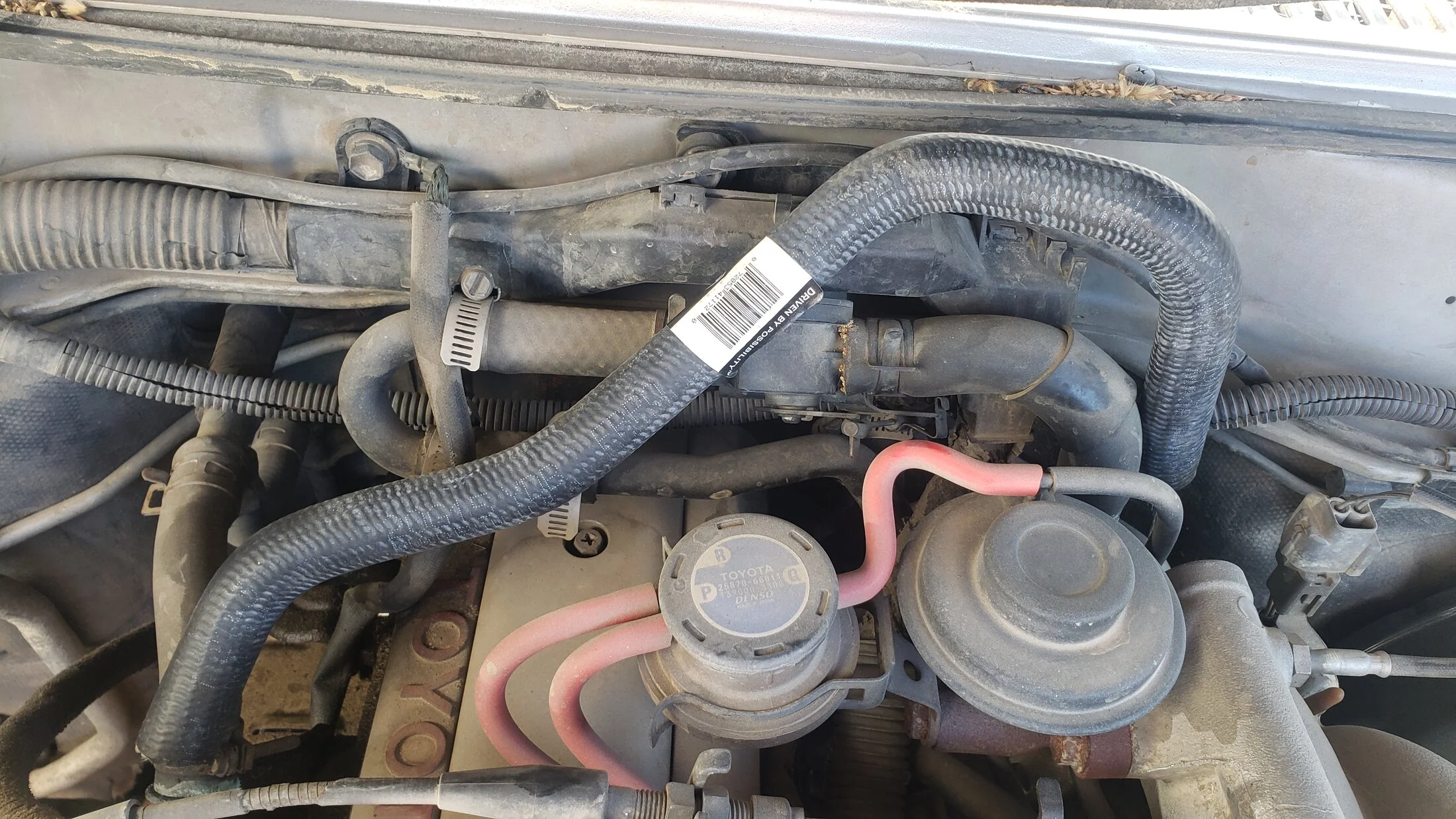

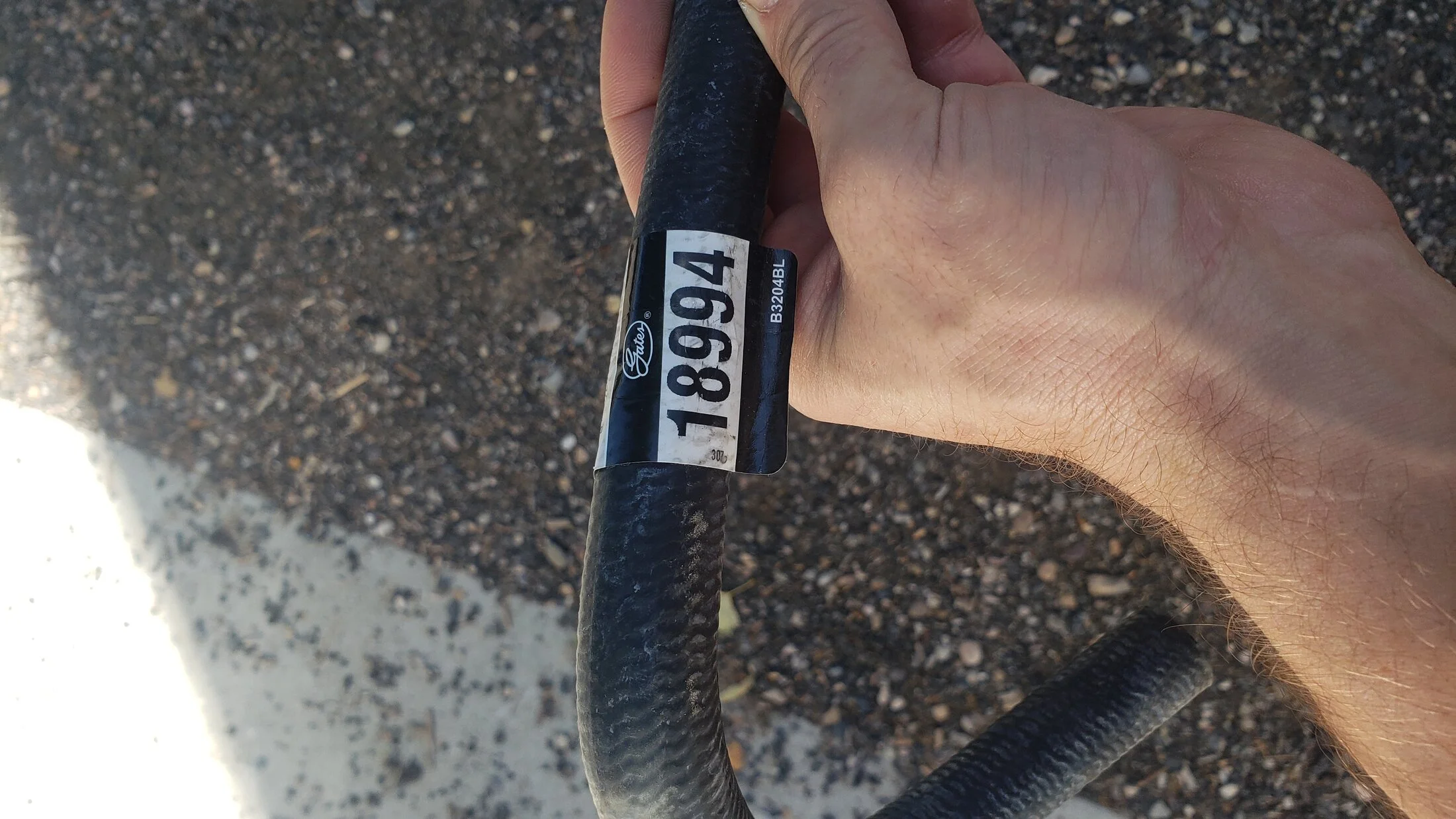

Hey all,
doing some cleaning in the shop and I have no idea how, when, or why I came into possession of this hose. I was about to cut it for one of its curves and was glad I noticed it is the perfect size and shape to bypass EVERY heater hose aside from the PHH (ok, at least on a obd2 rig which has a return pipe all the way back to the thermostat). Not only that, but it is a 5 minute job or less to install.
This will, of course, mean you get no heat but it gets you off the side of the trail when your rear heater line blows out.
If your Dead Serious about your Rig you have already Changed out the PHH, Rear Heater Bypass, and have and Extra EFI Relay and Fusible Link in the Glovebox with the No Start Guide Wrapped around your Noco with Zip Ties, Bailing Wire (exhaust) & Duck Tape.
*Left of Coolant Mixing Valve on Firewall.
indeed I have. And now I have one more thing that gives me peace of mind.
