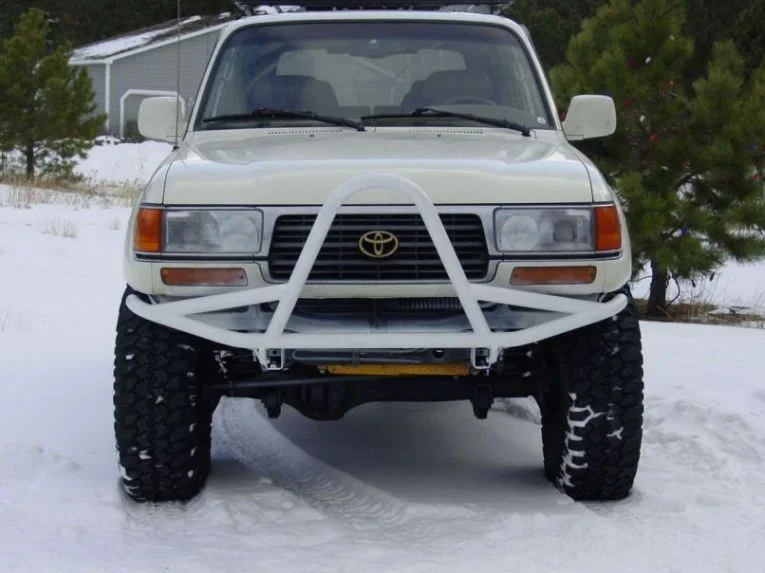

I figured I would document this build as it should be pretty easy to duplicate for you do-it-yourself type folks on the board. I am also hoping to keep it well under the cost of buying any bumper currently on the market. Hopefully it will be complete within a week, but with fabrication you never know.
I also wanted to give a big thanks to Nay as I am blatantly stealing his custom built bumper design, and hopefully he doesn't mind :D
Here is a pic of Nay's:
https://forum.ih8mud.com/attachment.php?attachmentid=198743&stc=1&d=1198709377

It is really going to be more a morph between a Metaltech and Nay's designs. I don't like the tow hooks or angled plate on the front of the MT as it looks goofy with a roller fairlead. The tube looks good but I prefer Nay's better as it is higher clearance and simple.

I think that would look even worse on an 80.
I have not measured the diameter of the various winches. I always assumed the angle of the front of the winch tray on both the metaltech or the bumpit was to give enough space for the winch to fit without hitting either the bottom of the tray or valance/ps cooler. Its nice to know that the tray can be tucked in as much as yours is and still fit a winch.
Nice so far. Skip the heap pointy stinger and do a modest one thats not as gaudy. Also, you can angle the front of that winch box slightly to improve approach. I cut a wedge out of my frame horns to accomplish this.

Darwink, I do like how your bumper turned out, especially the high clearance and simplistic appearance. My initial design did have a slight angle but the brake couldn't bend beyond 90* to make the top lip so we just went with the easy way and did a straight face. It doesn't stick out too far so hopefully won't make the approach angle too bad. I know the clearance on either side will be excellent too.
I have my fingers crossed a winch will fit. The Warn 9000 is 6.7 inches wide and I have 7" to work with since I added the lip. I am going to have to find a winch laying around that I can test fit before I box it in. If I have to I can move the entire tray forward a little at this point.
Yeah, I too still have my fingers crossed lol. I took rough measurements of the 10000lb winch on my taco and kind of built the winch box without ever really trying a winch. I know its wide enough.... As long as I get one (if I ever get one) w a remote mounted solenoid I should be good.
