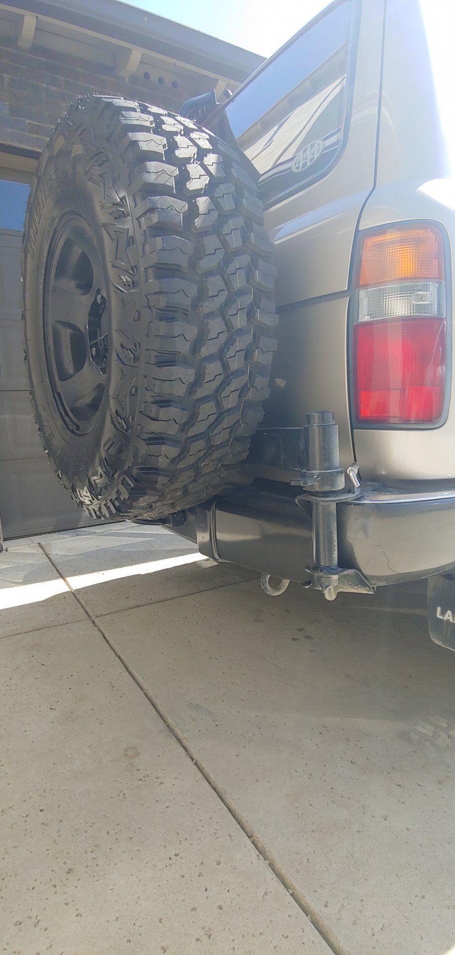

Correct, the standard, stand-alone tire carrier is no longer being imported. The Kaymar bar/carriers are still available for order.

Thanks! I reached out through the LRA site - digging through thread to find some pics of them in the wild.
