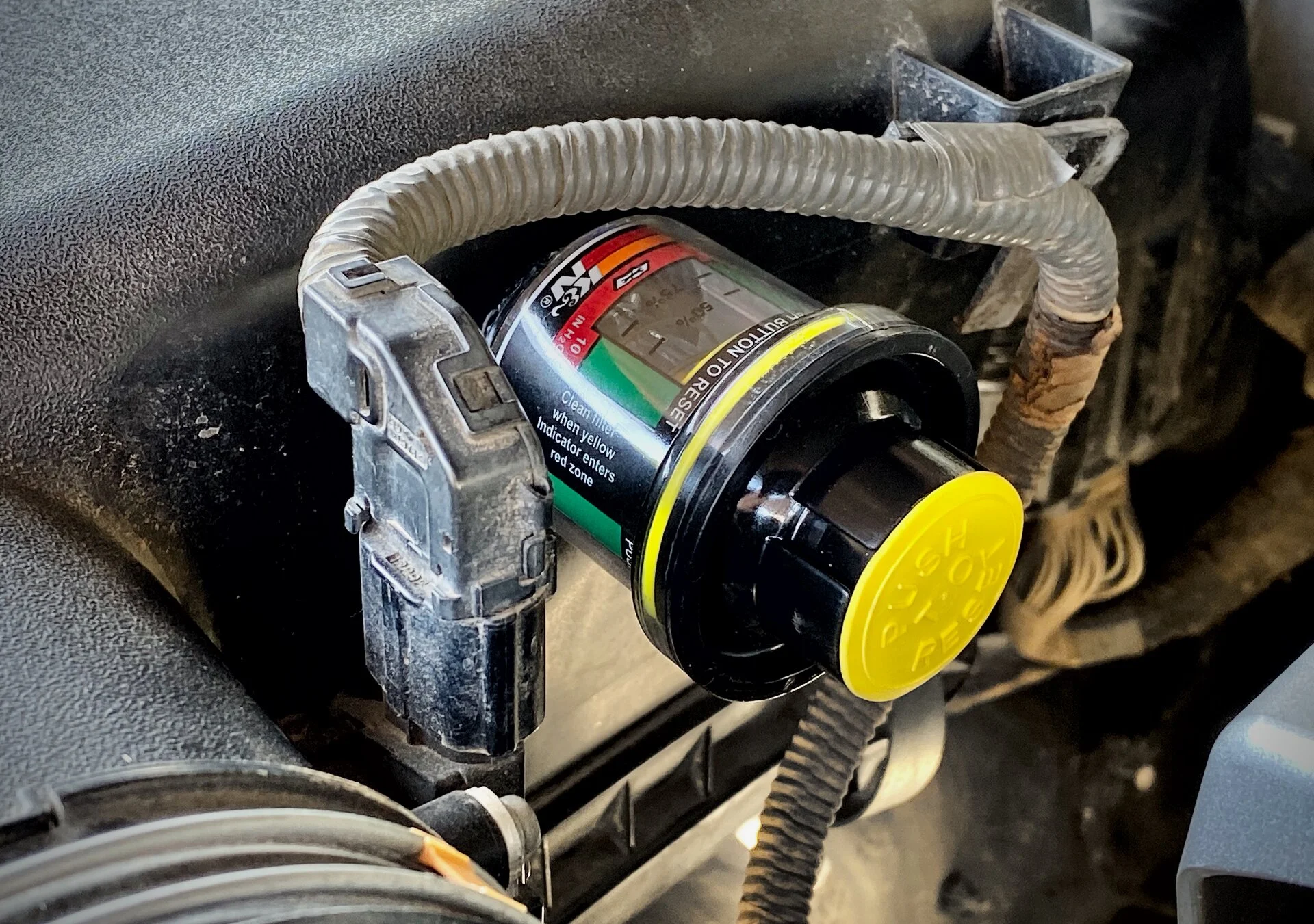

Instead….. Add one of these (see below) and you’ll save even more time and money by only changing plain-ol’-filters when they NEED it…rather than blindly following mileage or time, which may…or may not…reflect need-to-replace at all. This little device lets you know when the filter is dirty enough to matter:

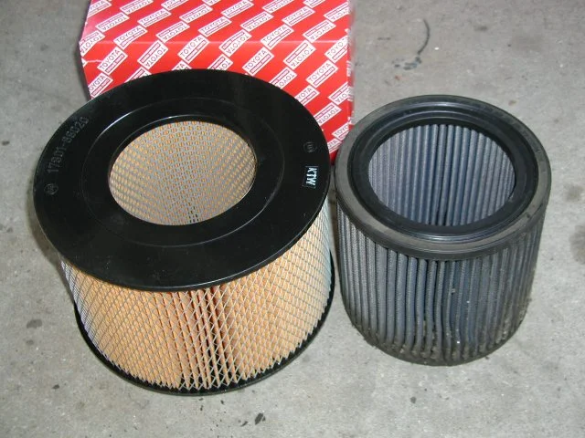

When i bought my FJ62, it had a K&N in the air box. When i pulled it out to clean it the first time, I was surprised at how small it was. Switched back to OEM. Which one would you want protecting your engine?
