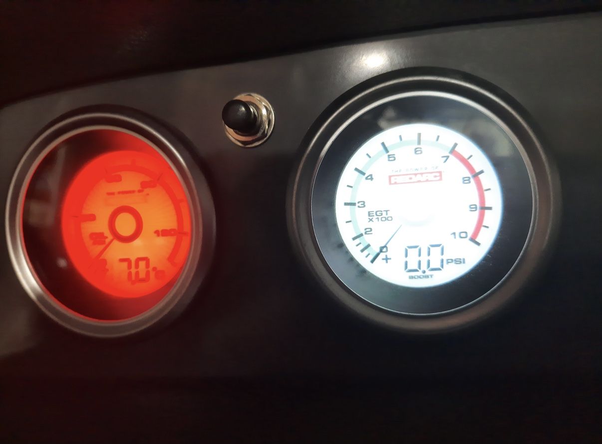

Auber EQT Gauge and probe (installed pre-turbo, see picture). Didn't want to rip apart my whole engine so I installed it where I could reach with a drill
