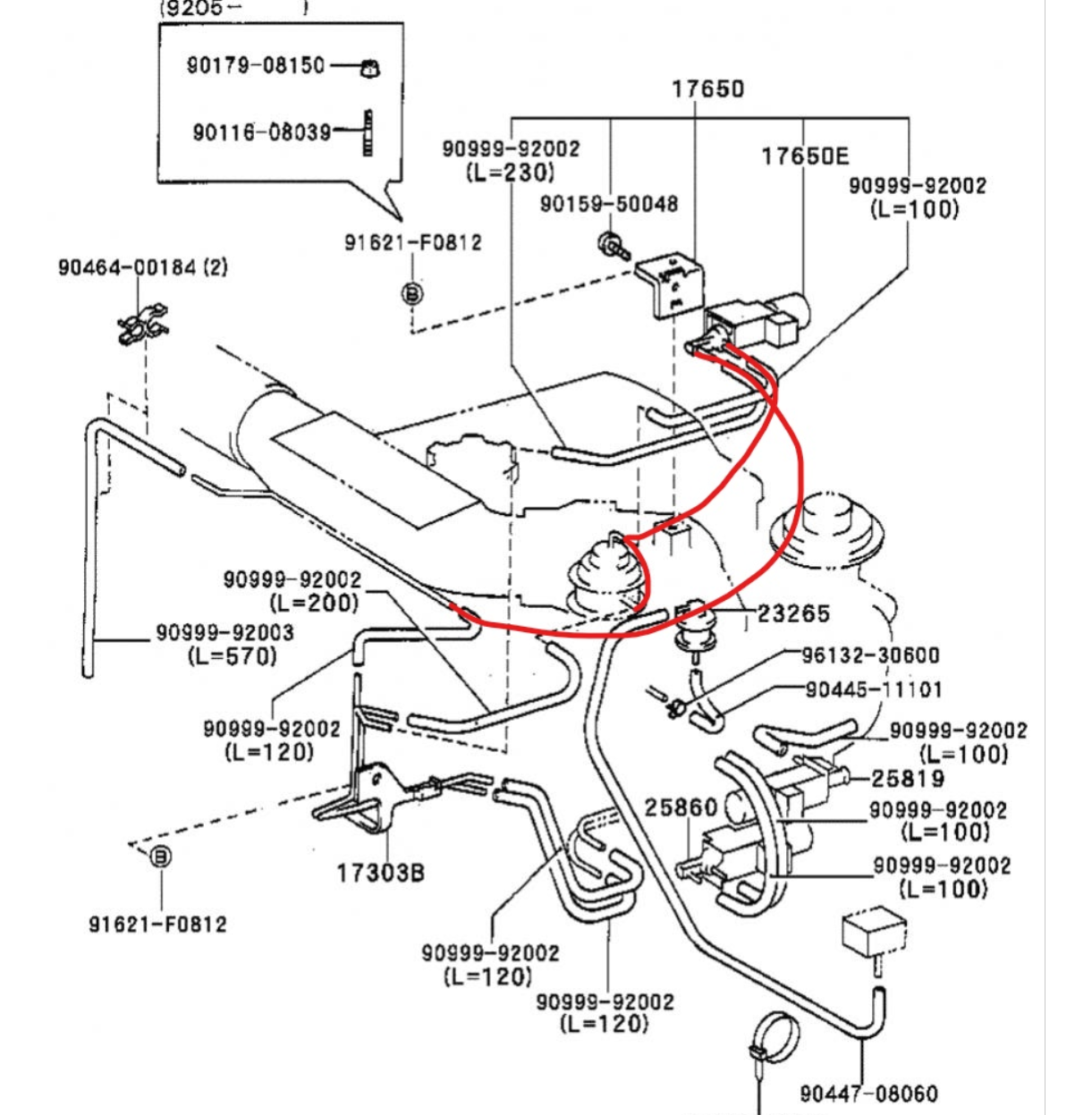

Okay so I've prepared everything to delete the EGR. I stumbled upon the following mod where you keep the Venturi and feed it with positive pressure which keeps the throttle plates inside the throttle body open so you don't have to drill them out.:
Any thoughts on this? Does the Venturi control both the main and sub throttle plates inside the throttle body? This seems like the ideal solution to keep the smooth shutdown and avoid extra work of drilling out the plates. I was planning to pipe it like this:
