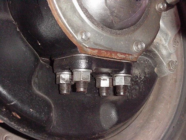

The knuckle studs likely backed out because the studs were loosened when the knuckle was disassembled. If they are not re-secured before re-installing the nuts it does not matter how good a job you do tightening the nuts up. This is turning into a common problem.
Can someone post a pic if they have one, because I have heard you talking about this, but I'm not sure which frickin studs you're talking about.
Here you go Junk I owed you a pic
Geeze Phil,
Could you clean that mess up a bit before you photograph it?...:flipoff2:
Reminds me that I need to buff my front axle housing.....:eek:
Oh, That aint no 80 series housing either.........;)

Sorry Dan looking at the pic I now relize there is some rust :flipoff2: :flipoff2:
Good eye 40 series...... closest to me.....its 110 here today

And yes that 40 knuckle joint is WAY to clean...it's screaming for dirt!! :)

yep, moms 97 studs(i know that sounds dirty) backed out leaving what could have been a very dangerous condition. I posted some pics a while back........but can't find them. Dealership corrected the problem on there dime, used the upgraded studs.
